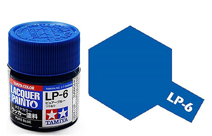

Is there any reason to think TS-15 is actually an accurate match for the model?
Many Tamiya color call outs are in the ball park but not actual matches.
Knowing which F1 car or kit might help.
Without any other information, I might consider LP-6 and tweak it to match pictures or get close to the F1 car as it’s a Tamiya laquer blue.
That’s based on looking at the cap of TS-15.

My personal and highly subjective opinion is that LP-6 needs to be tweaked slightly in the violet direction and be slightlyy darker. Judging gloss paint from photos is hopeless since it reflects the surroundings and incoming light (see photo above). Beneath the elf-sticker and the nr 2 on the side would be my
guideline.

If you want Tamiya lacquer, the equivalent of TS-51 Racing Blue is LP-45 Racing Blue. https://www.tamiya.com/english/products/85051/index.html
