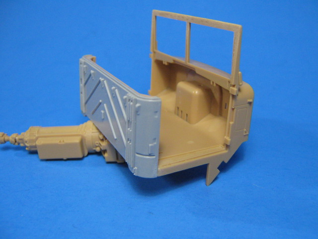

I started playing with removing the soft top. I decided to go with replacing the rear wall with one from the Italeri kit. I cut the front of the canvas at the windshield first. Then I cut at the bottom of the door openings to remove the rear wall and the canvas top as one unit.
IMG_2248
Then I checked the inner wall piece (D21) against the inside of the Italeri rear wall. It was pretty close and a little sanding mated them up nicely. The I Love Kits inner rear wall was slightly tall though. I ended up cutting about 1mm off the bottom so the floor would fit correctly.
Removed strip from D21.
IMG_2249
The result, looks pretty good to me.
IMG_2245
IMG_2244
IMG_2247
I also tried out the CMK engine to see how it fits. It needed to be raised up about 1/8", but fits fine. I cut away the resin inner fenders as the kit ones look better and seem to fit better. The shims will not be seen once the inner fenders are added.
