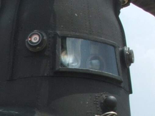

I took a moment to look at my references while waiting for water to boil (who has time to model on weekends?) and another thing jumped out at me - the absence of this:
I’m not going to spend any more time looking at this conversion as my mind had already been made up. But anyone buying it - you were warned.
