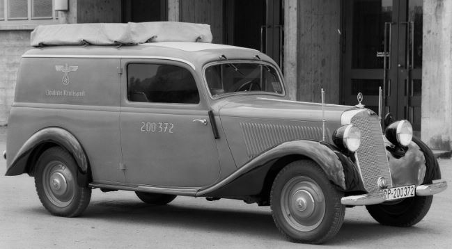

I can’t find any evidence Tatra manufactured vans in the 20’s & 30’s, only cars and big open-platform trucks like the T85. However, the rest of the account of Heydrich’s removal to hospital appears to have been taken from actual witness statements and sounds too detailed to be invention. Pannewitz implied the back of the van was locked i.e. enclosed like a panel-van. Whatever, for my purposes I can’t build a “Tatra van” or a Zetka (possibly a Z-series) either, because there are no suitable Czech-manufactured cars or commercial vehicles available in 1:35 scale. So for the only (?) time in this project I’ll have to compromise and go with plausible equivalents – the Simca 5, and the Mercedes Lieferwagen.

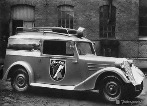

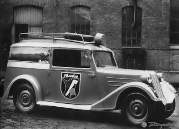

How time flies Tim…Your project has come a long way since March 2018 ! On a side note, Tatra did make some commercial variants of their cars in the 30’s (and we talked about this in April 2018)…Here’s a 1936 57A light van :

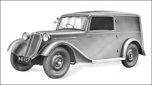

and a 1938 model :
But there’s still no 1/35th kit for it…
A 1938 model…and today they dub it a crossover!
Cheers guys & hello stranger glad to rattle your cage H.P.! Well, I could blame the nutter who’s put up most of the 1,193 images & counting on this blog for missing those pictures of a Tatra van, or the dummy who can’t do a proper image search, but I think the real culprit’s the Homer who just had a senior moment. Thus evading omelette-sur-le-visage via multiple personalities I immediately remembered them, many thanks for a second time.

….hmm…anyone thinking what I’m thinking? :tumbler_glass:
Close, but alot of work.
To say the truth, I must confess I didn’t remember posting these pics in the old thread…But Google image search is a good friend of mine :wink:
Hmm… the basic shape is there, but enough details differ to warant a lot of work indeed… from fenders to shape of the doors, roofline, wheels, window shapes, etc… BUT, I love being proved wrong and sit back and wait for your conversion magic to take place :slight_smile:
