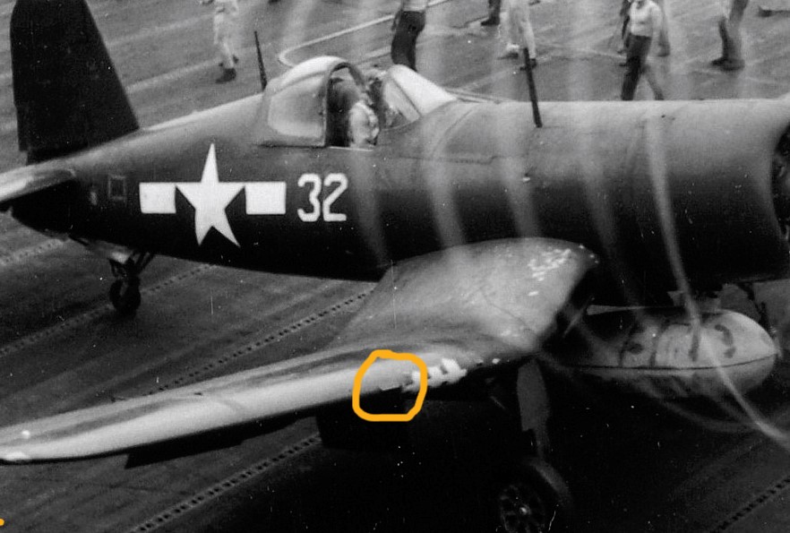

“It was also found that the Corsair’s starboard wing could stall and drop rapidly and without warning during slow carrier landings. In addition, if the throttle were suddenly advanced (for example, during an aborted landing) the port wing could stall and drop so quickly that the fighter could flip over with the rapid increase in power.
These potentially lethal characteristics were later solved through the addition of a small, 6 in (150 mm)-long stall strip to the leading edge of the outer starboard wing, just inboard of the gun ports. This allowed the starboard wing to stall at the same time as the port.” Except on the U-2. The radar dome (and missing.50cal?) solved the problem. Not sure what they are talking about “inboard of the gunports” Only one I’ve seen is outboard. (yellow circle)
Dont know if this carried over to the  -4 on up.    https://www.jdsf4u.be/technical-issues-f4u-corsair
Better view
The triangular wedge on the right wing is the spoiler. The first generation of the aircraft often had an ad hoc wooden block there to spoil the airflow, before the design was updated and produced with the spoiler installed as part of the normal assembly.”
