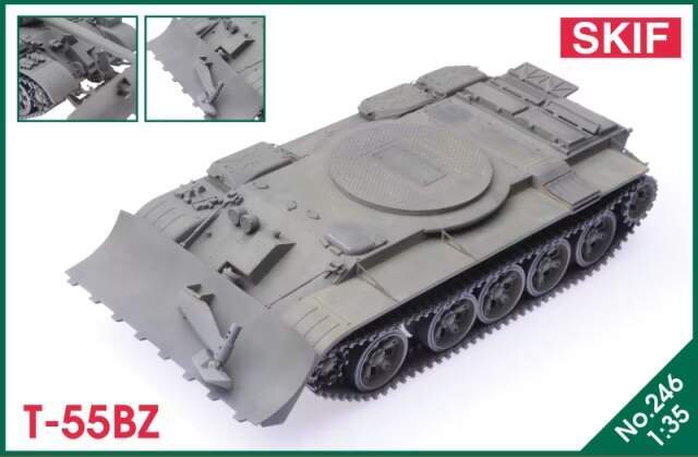

Opinions on Skif kit?
Found this for sale, haven’t found anyone else who offers this version.
Couldn’t find any build or even inbox reviews.
So is it worth the trouble, maybe with a set of Miniart wheels and AM tracks?

EDIT: Here’s what’s inside: T-55 BZ Skif 246

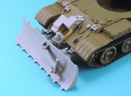

One option from Legend:
https://www.super-hobby.se/products/BTU-55-Dozer-set-for-T-55s-Variants.html
Looks more detailed than the one from Skif, IMHO or something …
Add one Miniart T-55 and some patterned styrene sheet …

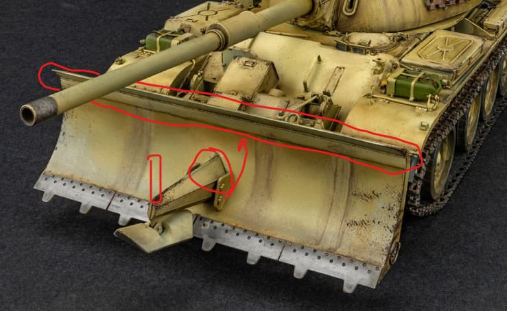

Miniart has a similar dozer blade:
Top edge of blade is different.
The arm sticking out in front has a different attachment point and is attached further down on the blade.
The Miniart blade doesn’t have what looks like a height adjustment.
Thanks Robin, I’ll look into this Legend option as it looks to be the best bet.
Edit: The Legend set has been ordered.

Robin, ended up ordering from China via eBay as the ones I found in Europe were all around 3x the price shipping compared to the one from China and slower shipping!
Also found CMK do a BTU-55 but not sure how it looks as from experience CMK can be really good or muh.
Note: The MiniArt blade assembly is IDF-specific and has an added mounting plate that has all the blade attachments on it, nothing bolted to the glacis or hard mounts other than the cable anchors on the upper glacis. The original Russian kit probably takes longer to install on a tank… but back to the Skif kit: if it’s cheap enough, and since the Legends BTU-55 is pricey, it might be worth a second look for the 'dozer set only. I have experience with one Skif kit only, a T-55A with a very basic interior that I used to create something other than empty space inside a Tamiya T-55. It cost me $10 at a show. It’s all pretty basic, but when it was new it was probably comparable to the Esci kits, just a little chunkier.

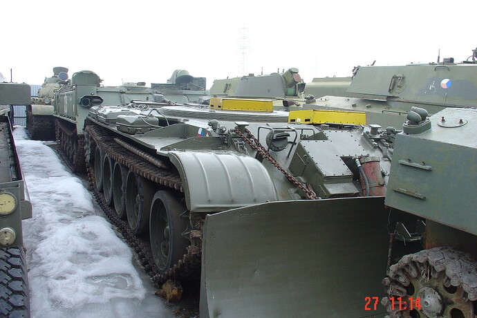

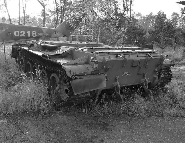

HOWEVER…anyone have any other pictures of the T-55BZ or whatever they call it? I can do a quick CAD file and make the conversion for a Miniart T-55 kit ( I doubt it was a country or plant specific creation. Probably started as a driver trainer and they threw the blade on to plow snow…) :rofl:
Jacques the only ‘clear’ picture I’ve found is this one. I noticed that the turret blanking plate and extra parts in the Skif kit are actually resin.
Also this picture
