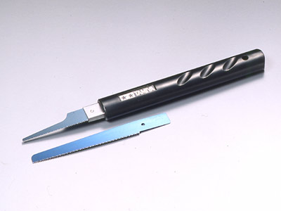

Tamiya make a Razor Saw.
Quite handy for larger bits. They also make a Mini Razor Saw.
