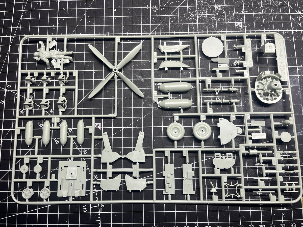

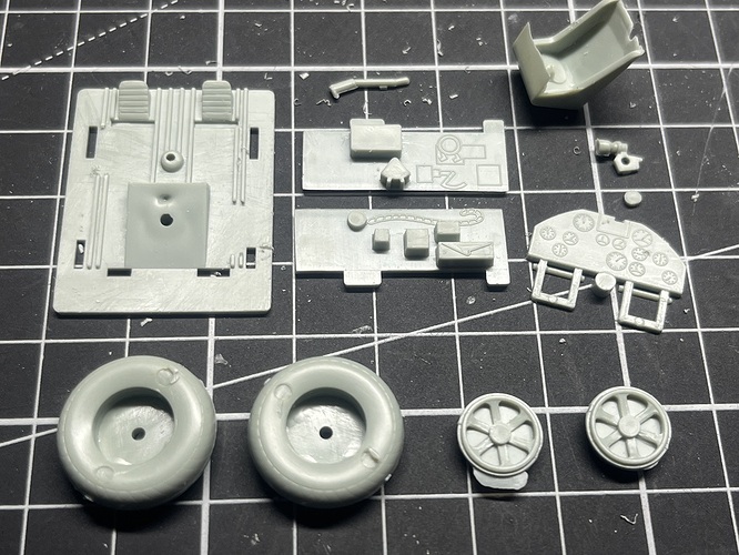

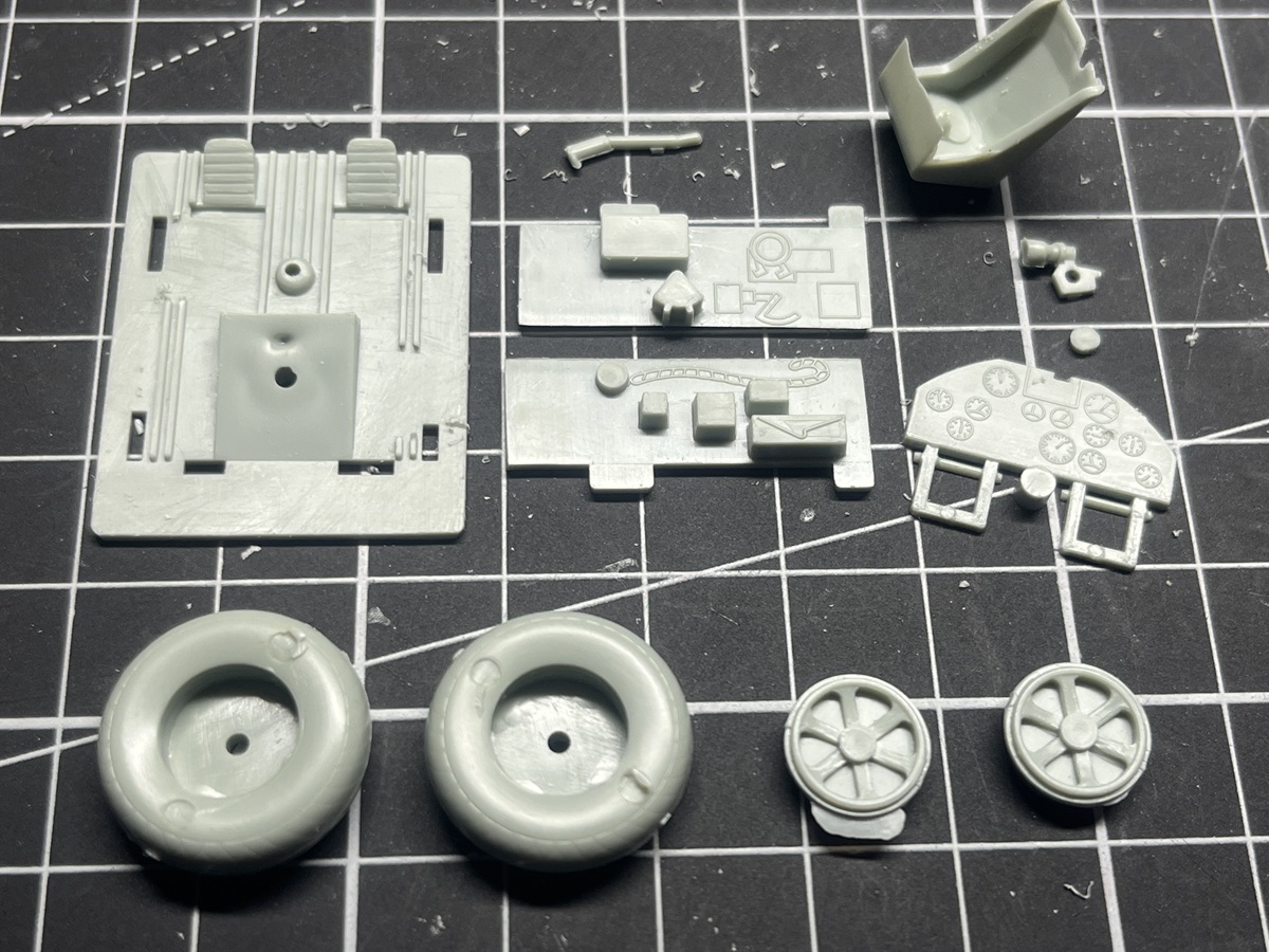

Most parts will be used.

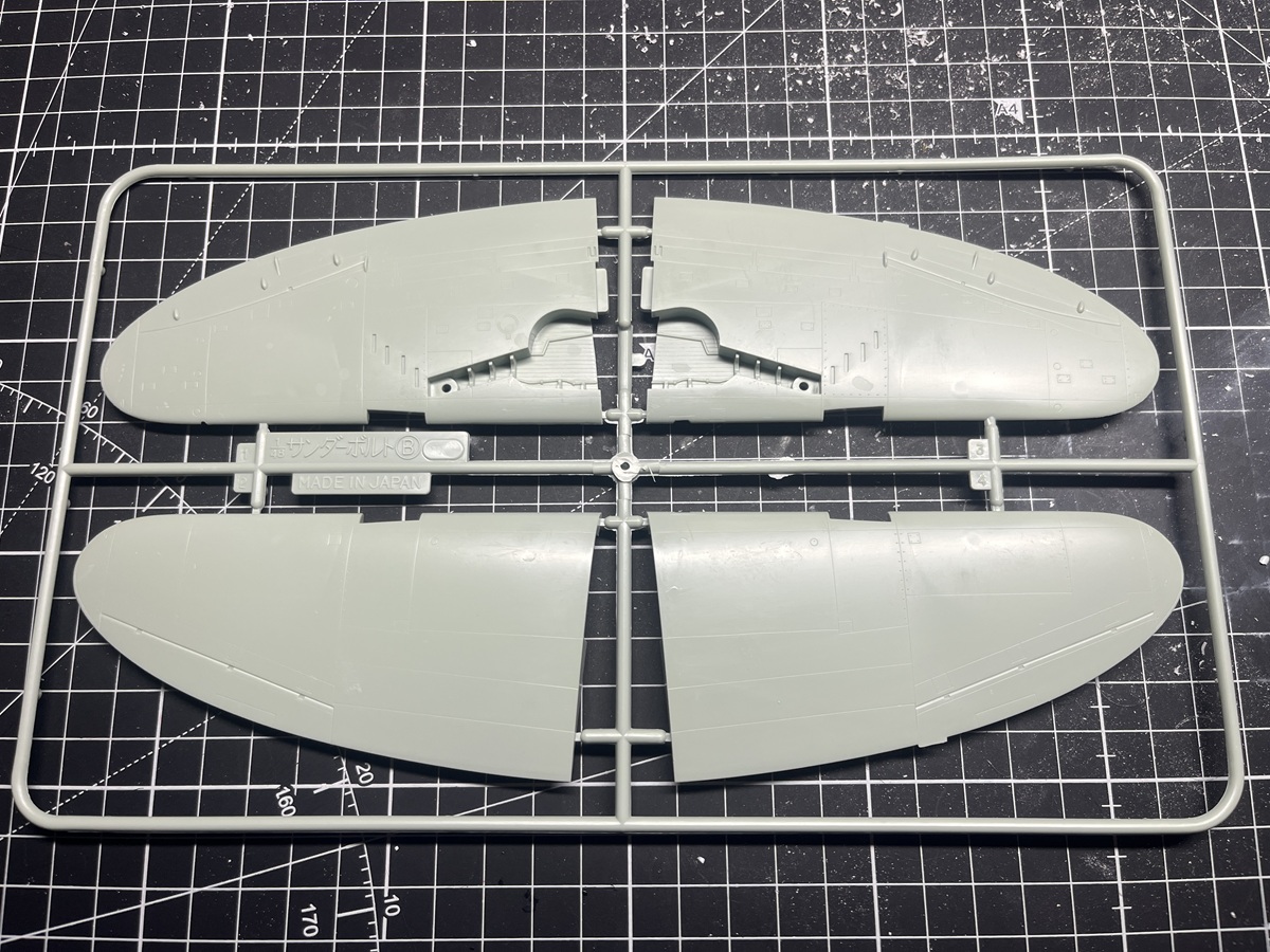

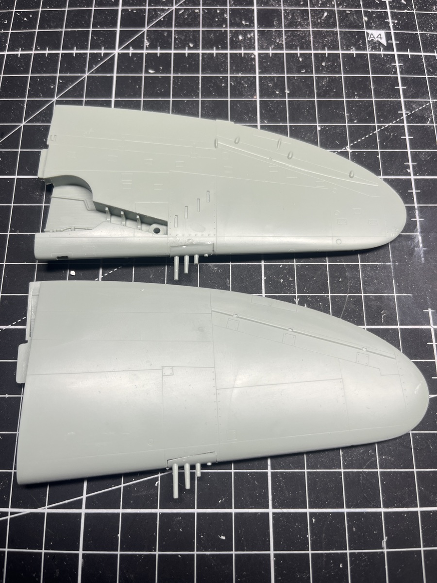

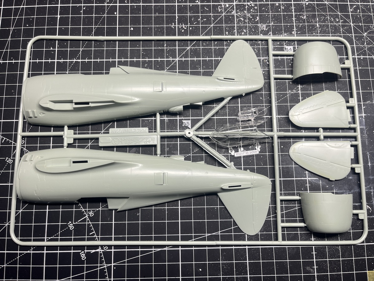

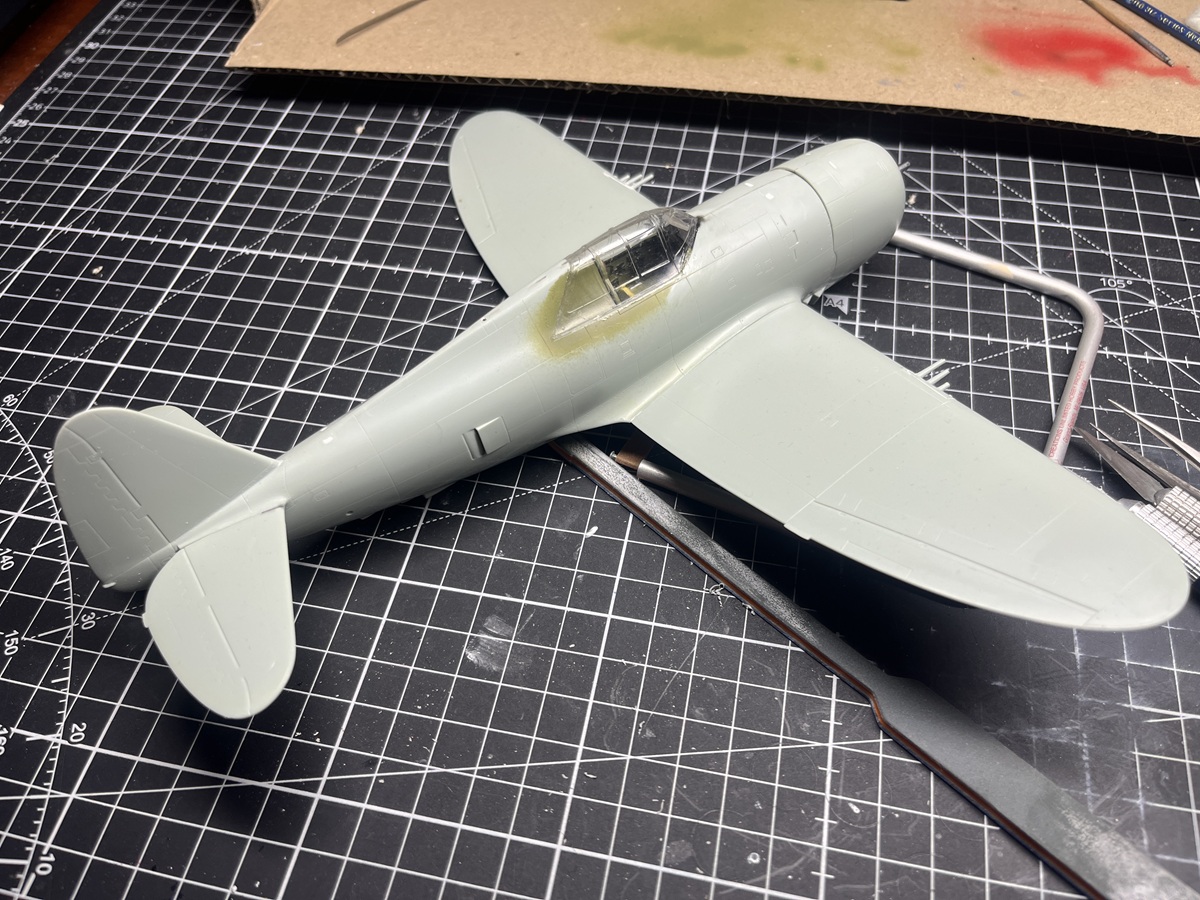

I wasn’t expecting a Tamiya build experience from a $5 swap meet kit, but the detail and fit aren’t too bad. Test fit of major assemblies.

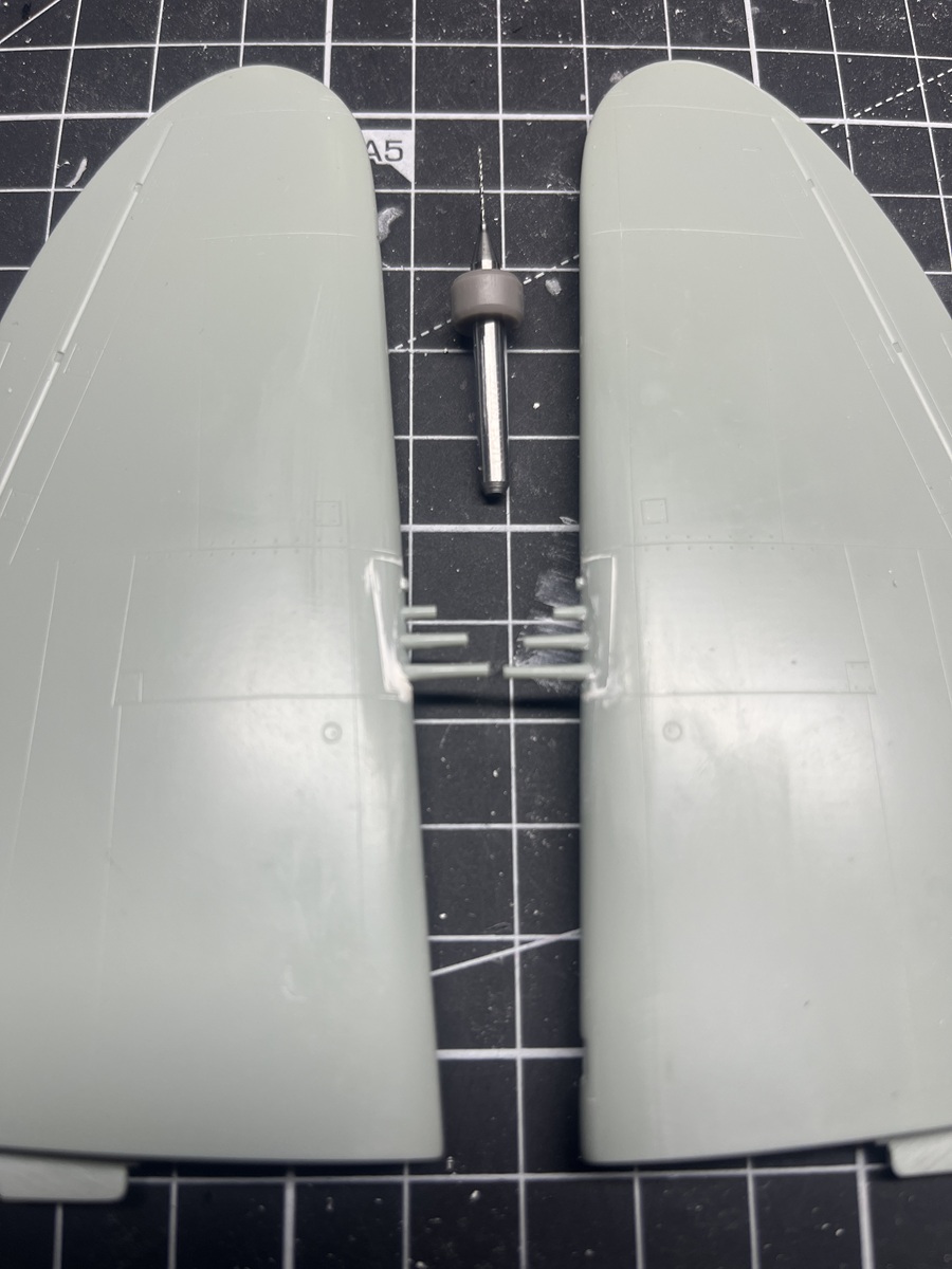

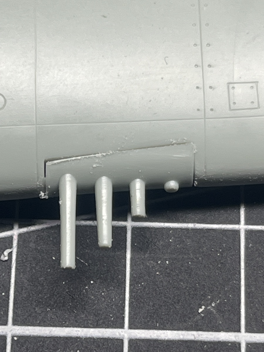

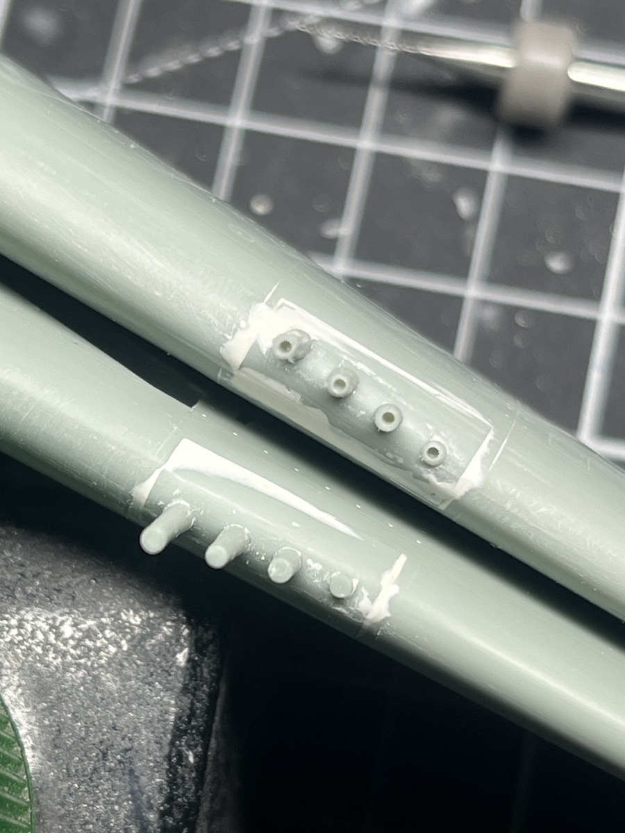

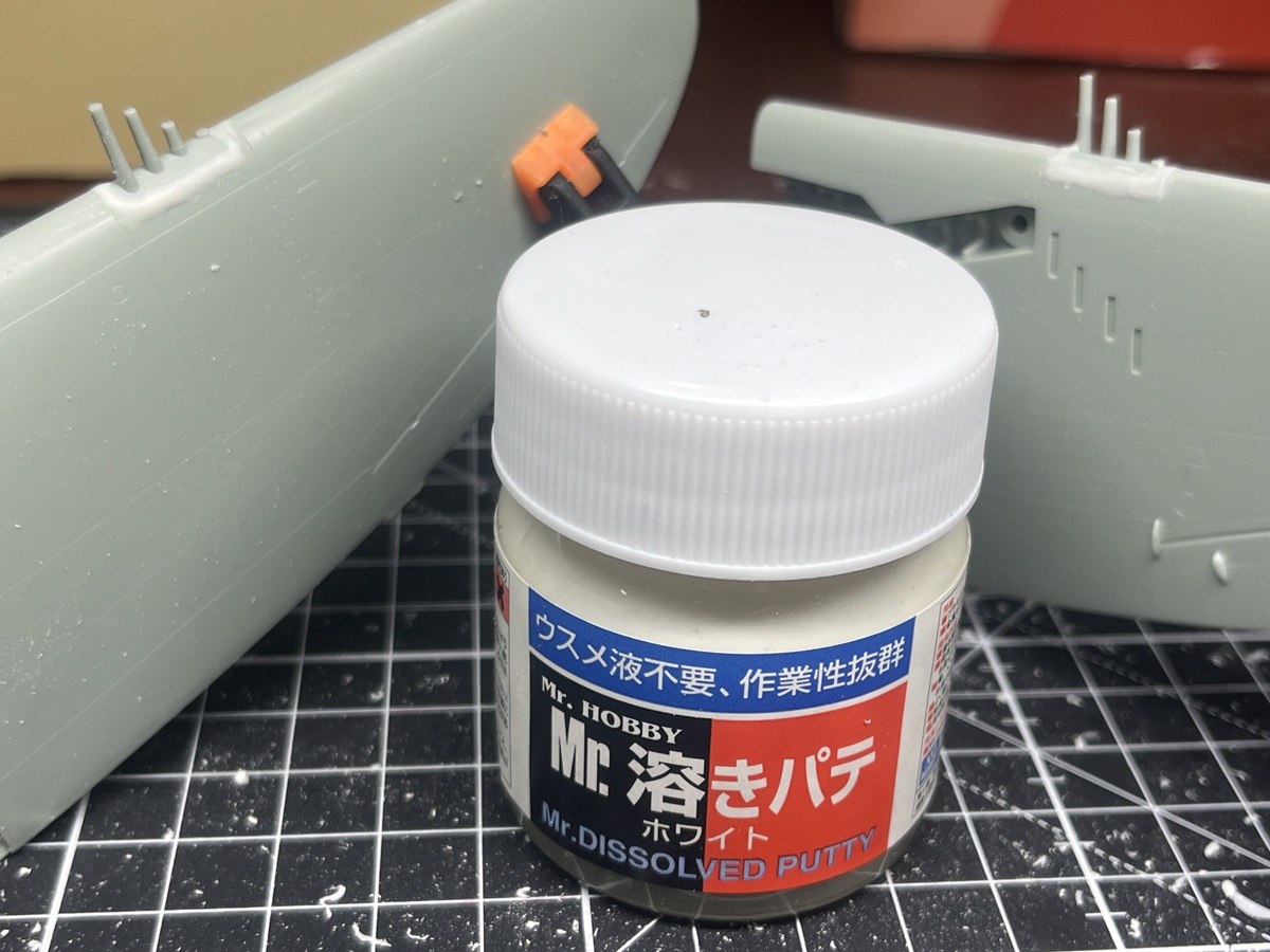

Fitting the gun barrel blocks to the wings, some work required here but I focused on keeping the leading edge alignment.

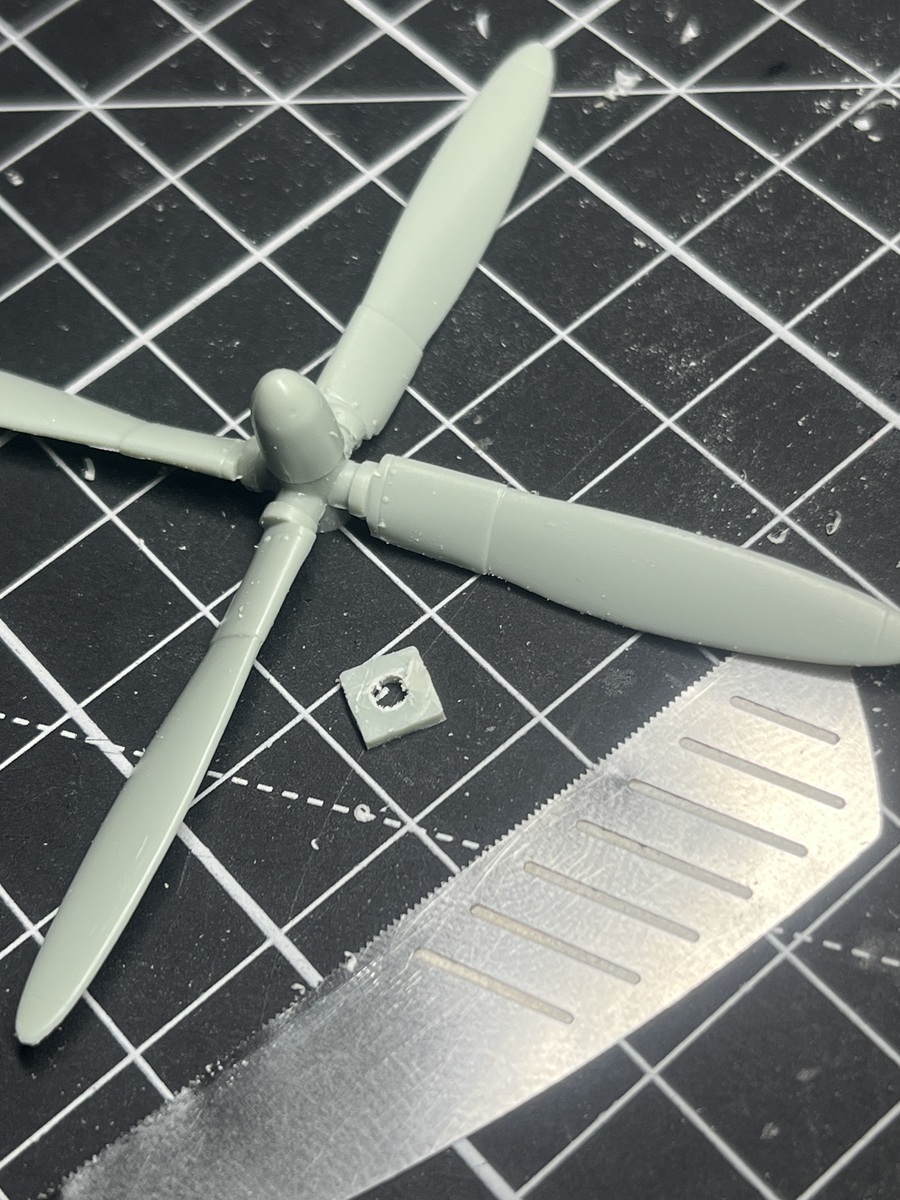

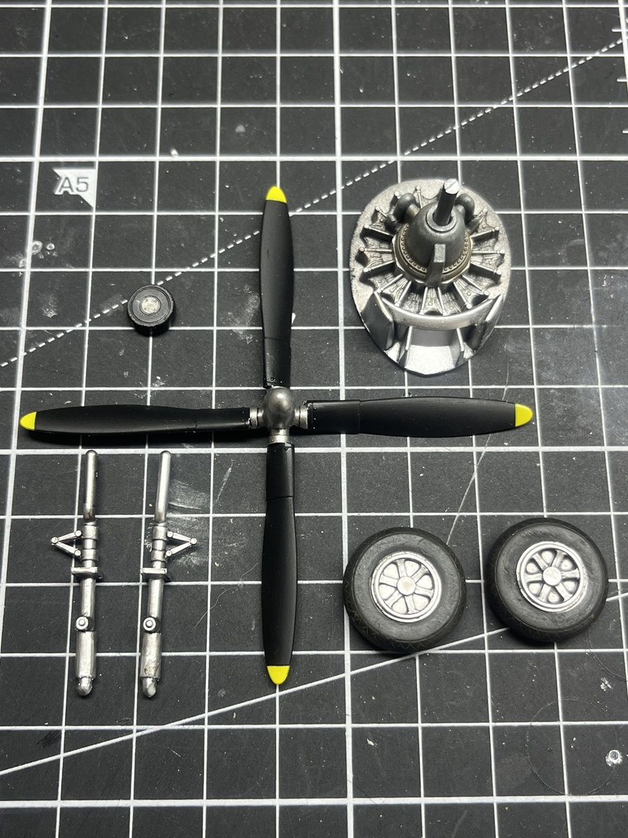

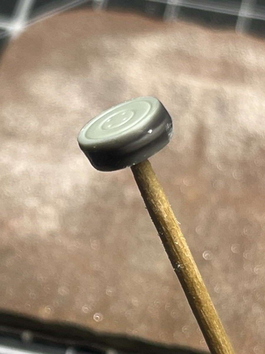

Not sure why there was a huge square block on the back of the prop hub :thinking: Razor Saw to the rescue

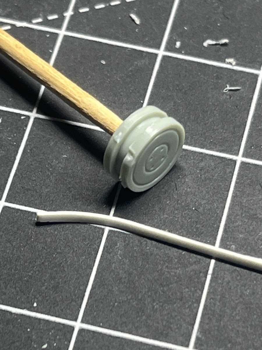

The tailwheel isn’t quite accurate either :rofl: so I filled the centre groove with a strip of styrene then built up the shape with several applications of sprue goo.
Cheers, D

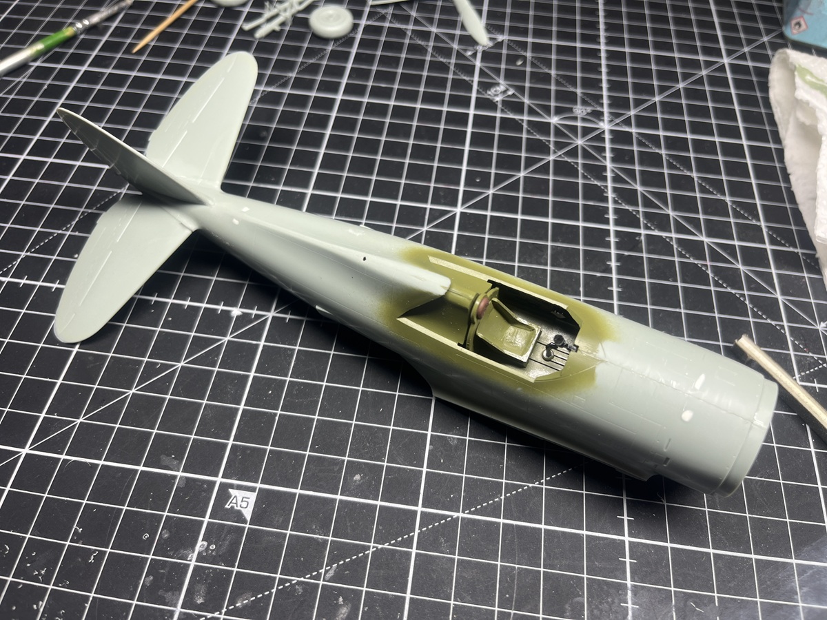

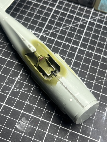

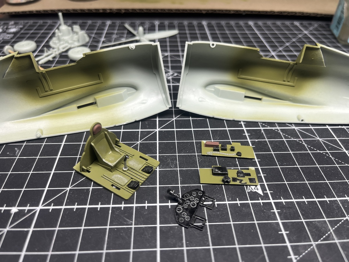

Interior paint and fuselage assembly.

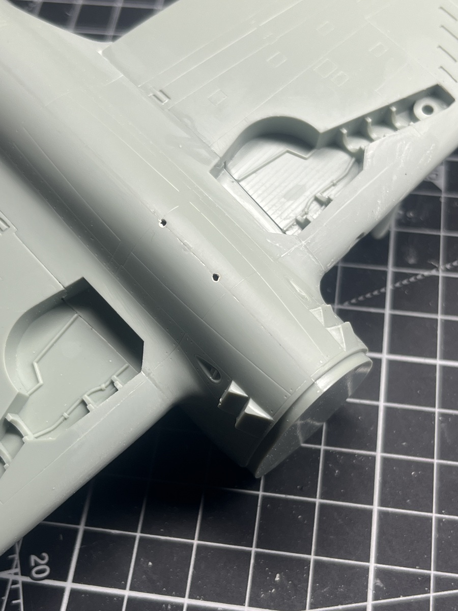

Sprue goo on the top join.

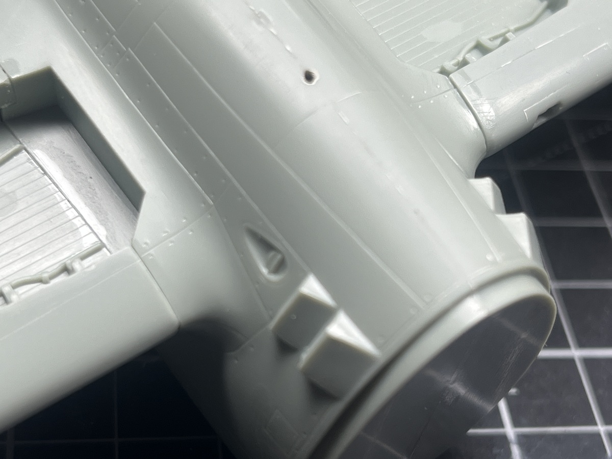

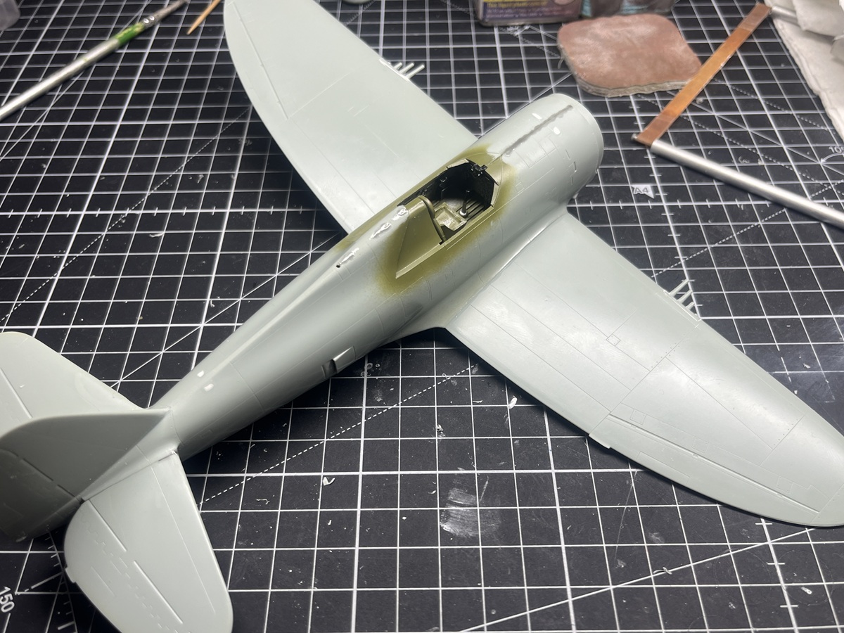

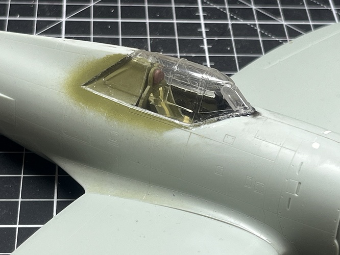

Wings on, the leading edge on the wing root needed some rework. I should have paid a bit more attention to the fit of the top of the wing root, a bit of a step there and could have avoided that with a spreader inside the wing. Oh well, info filed for future builds, I have a couple more of these kits stashed away.

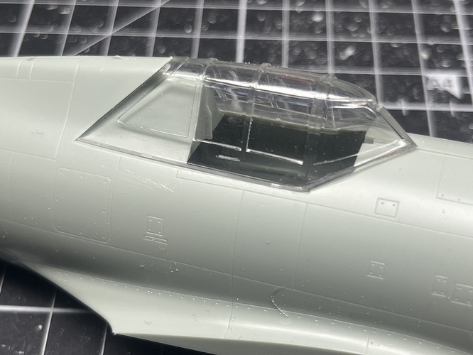

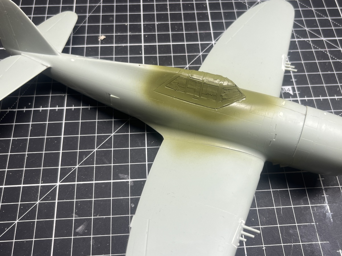

Canopy didn’t need much work to get a decent fit.

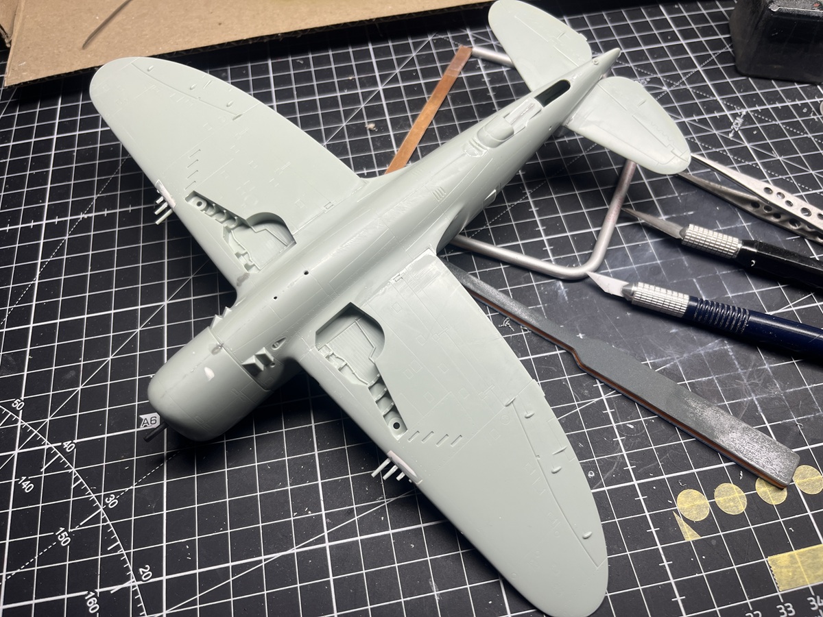

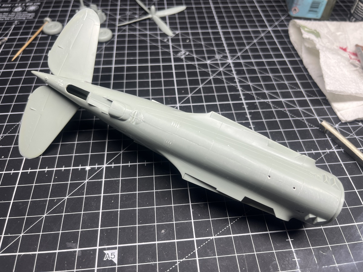

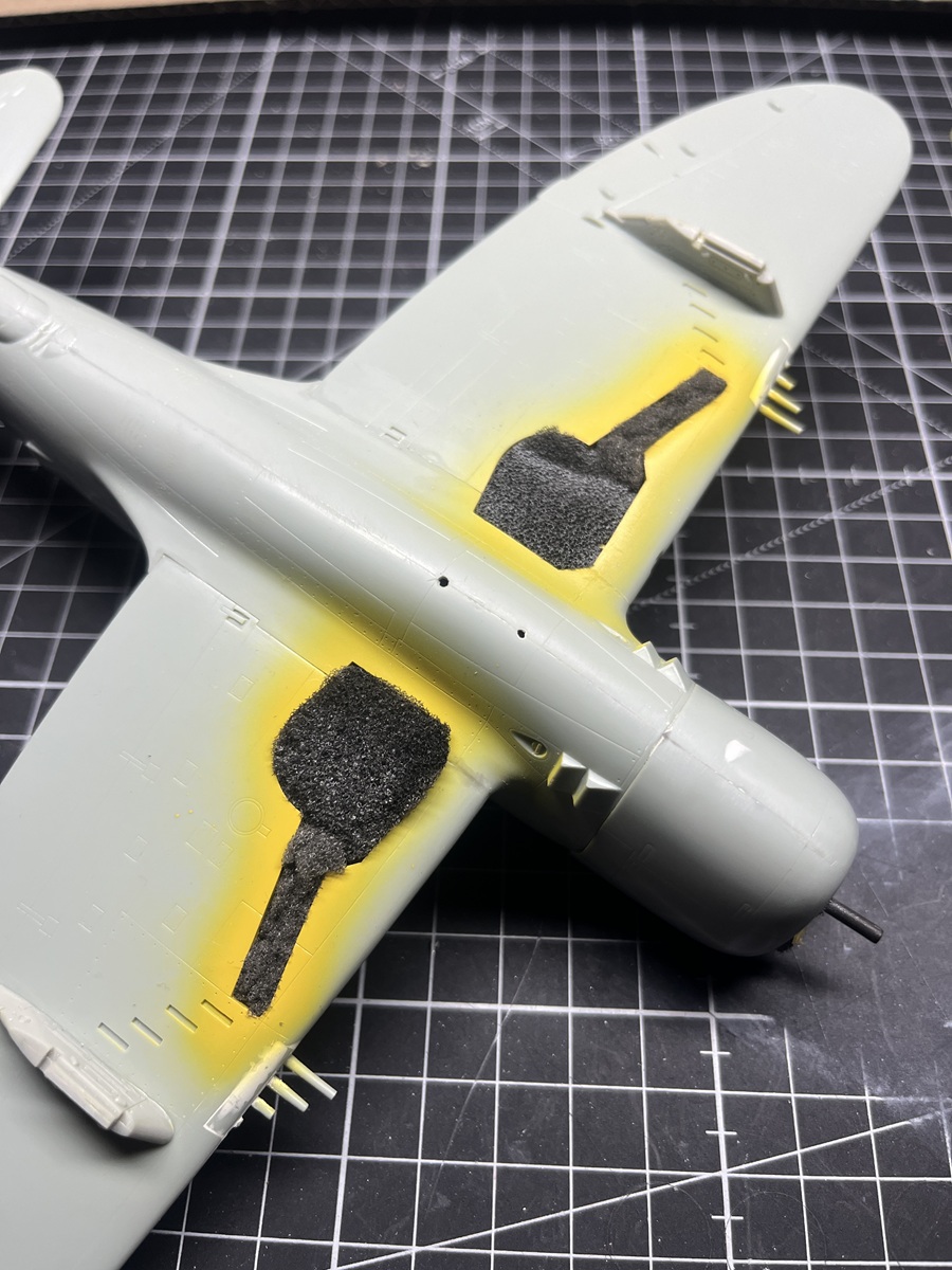

I know they will never be seen, but those ejector pin mountains need to be dealt with :face_with_monocle:

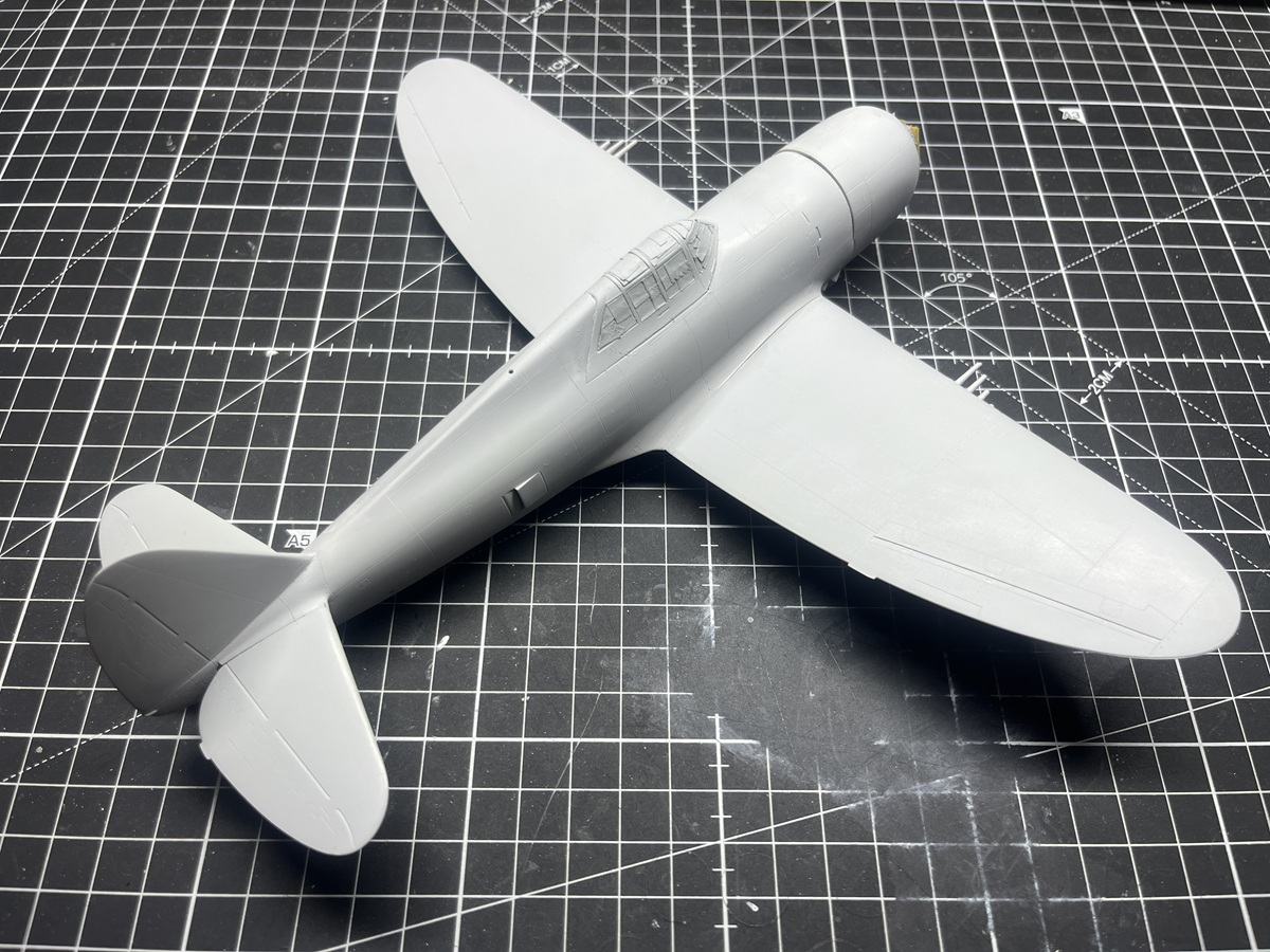

Major assembly completed, working on smoothing out some sink marks and blemishes.

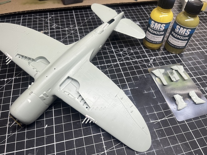

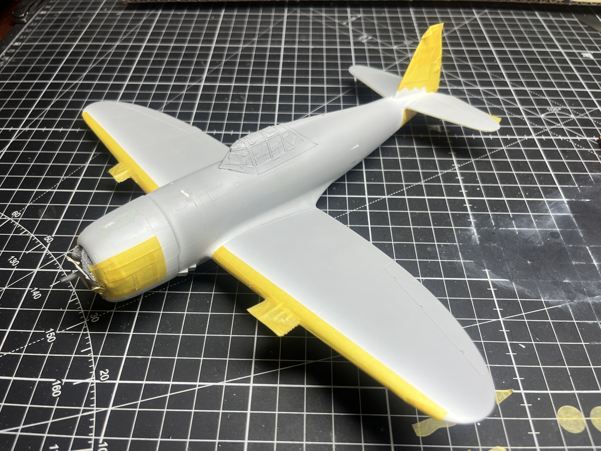

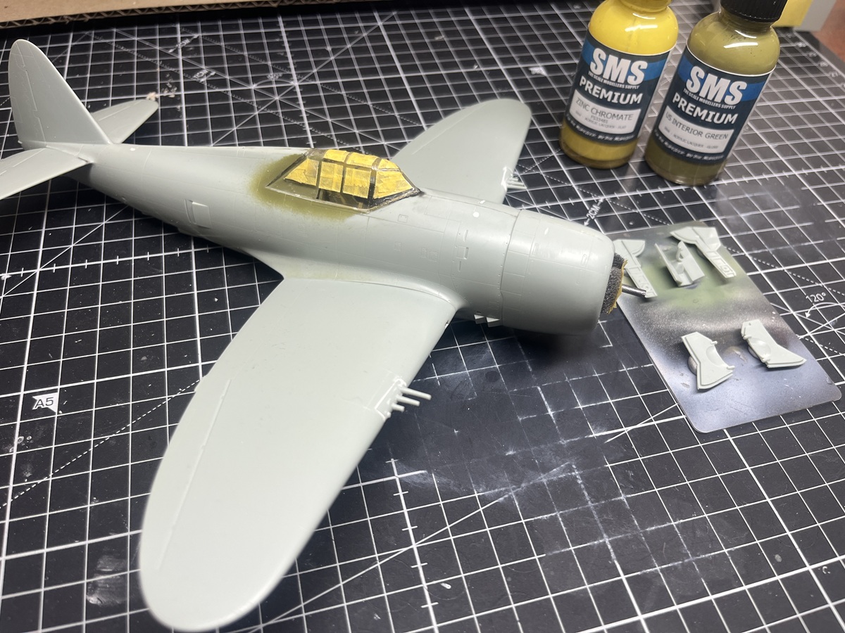

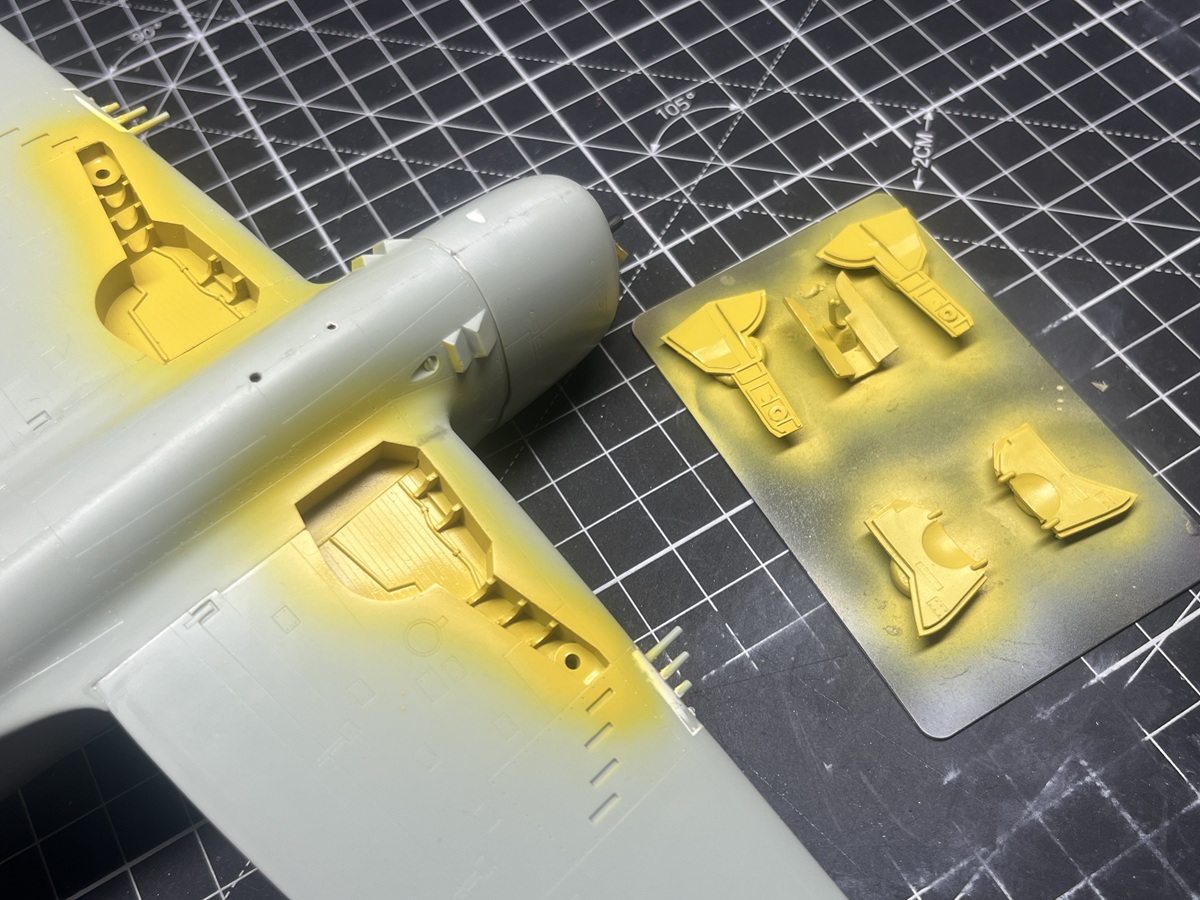

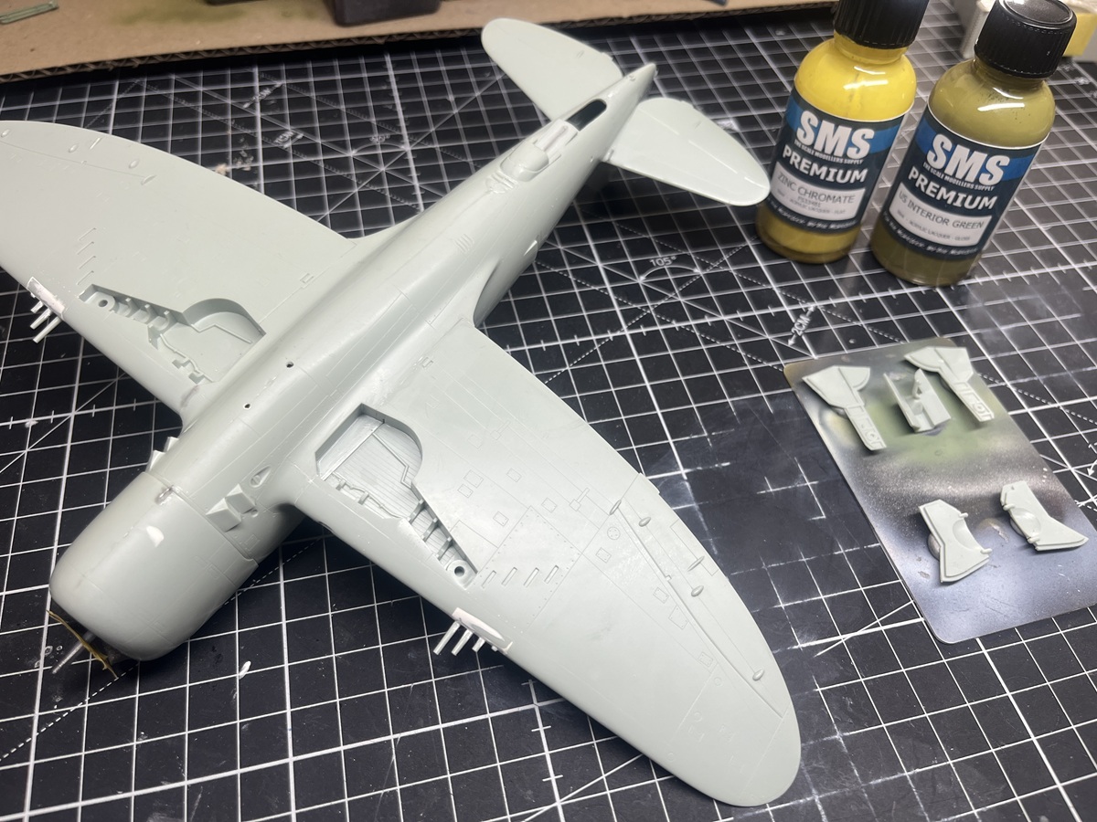

Next up time to mask off the canopy and start the exterior paint. SMS Lacquers for the Zinc Chromate for the wheel wells, and Interior Green for a first coat on the canopy frames.

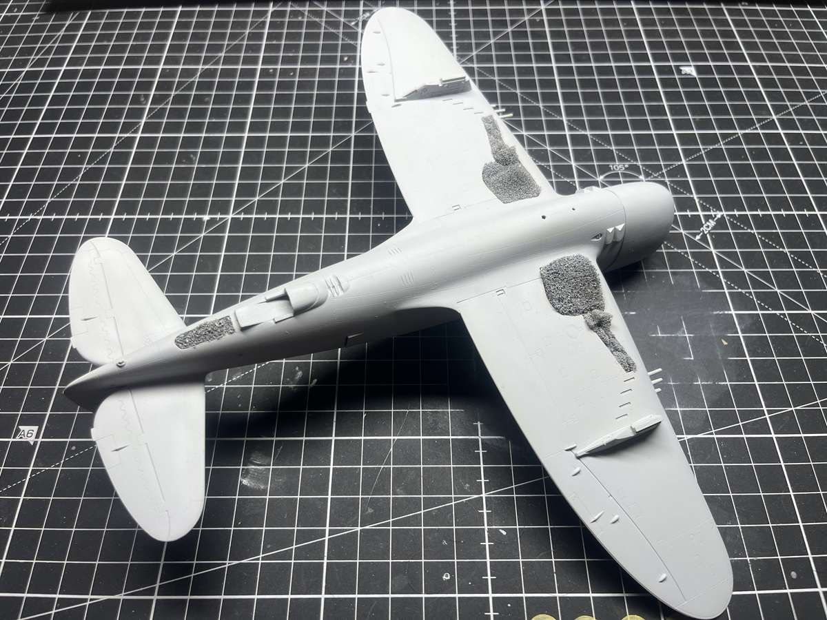

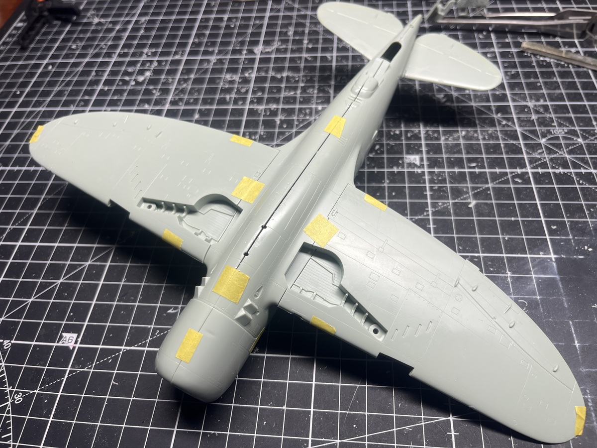

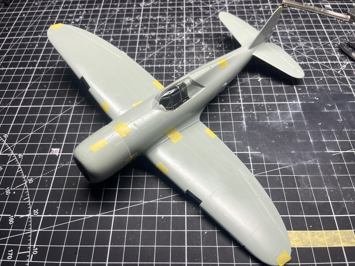

Masked off ready for primer, MS1500 Grey.

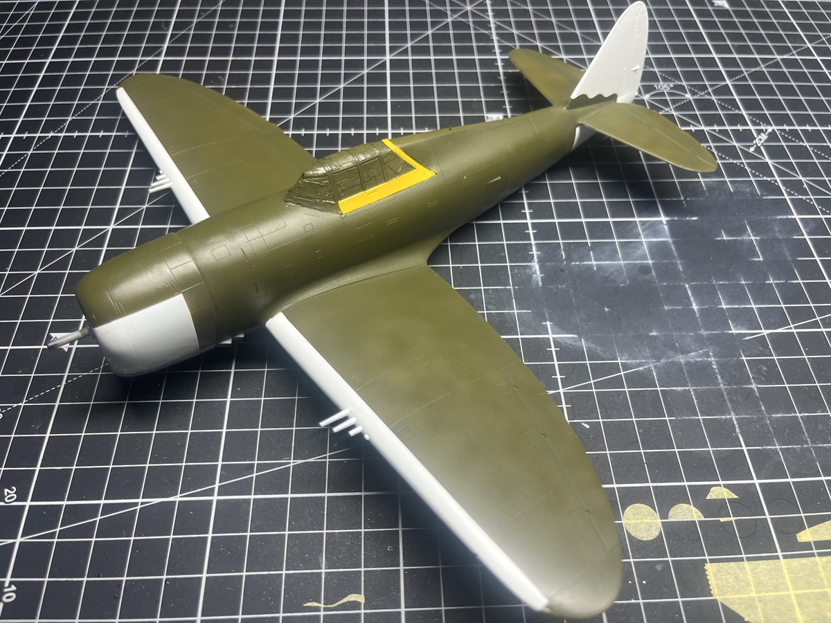

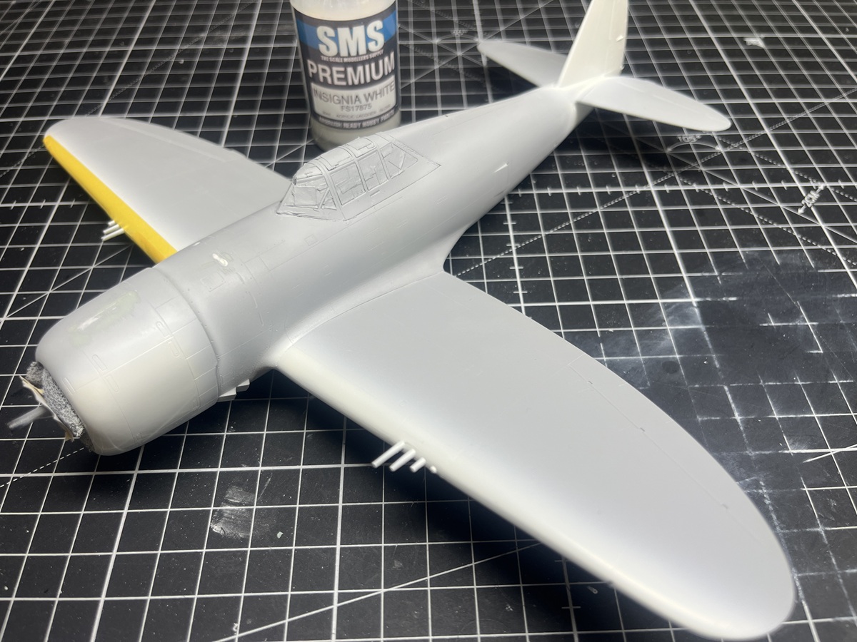

SMS Insignia White for the cowl side panels and tail, then more masking.

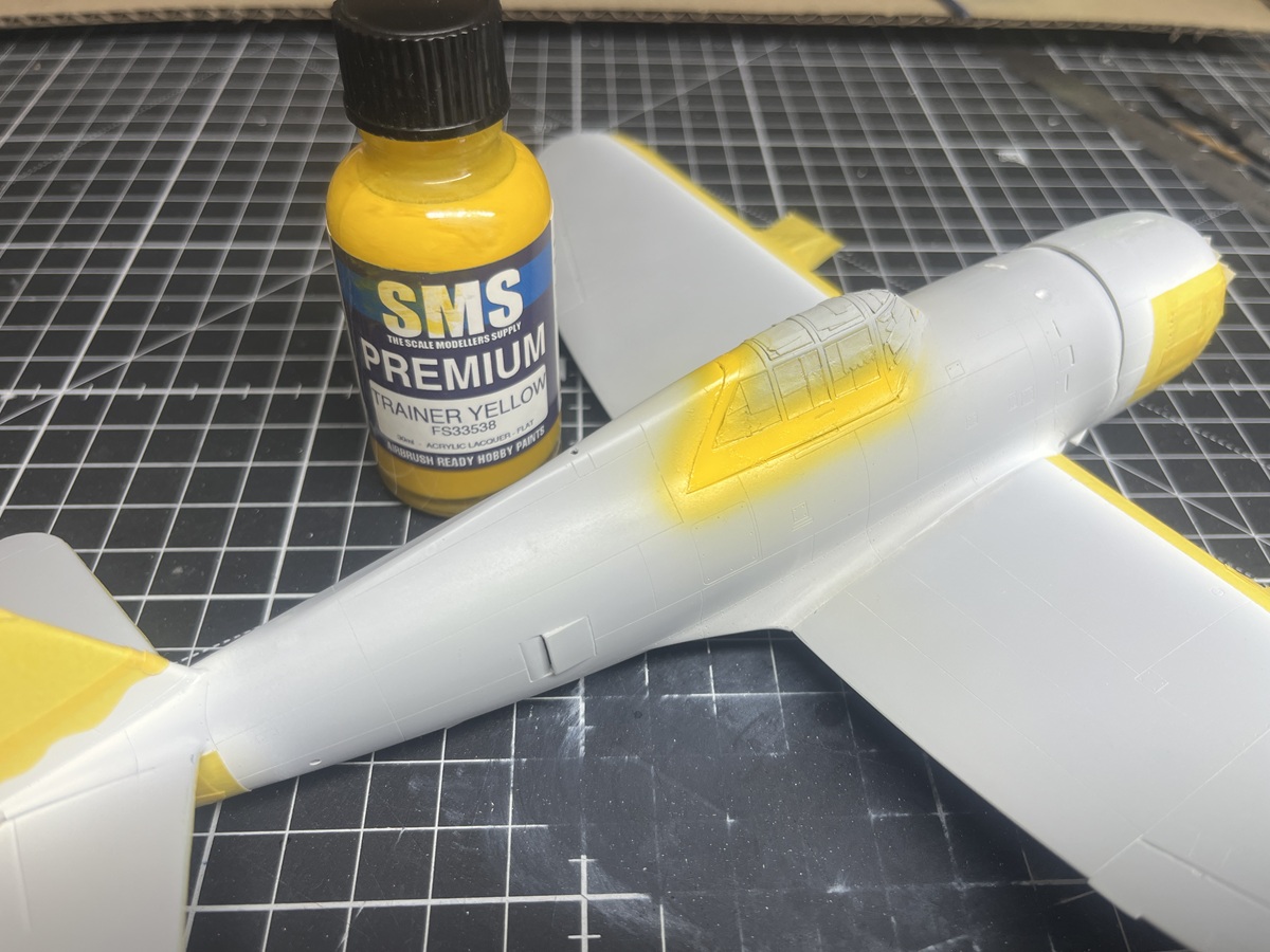

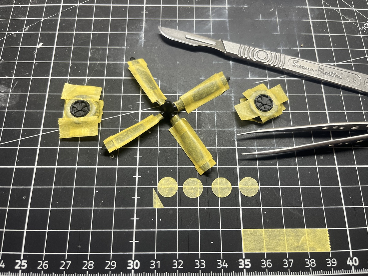

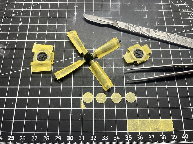

SMS Trainer Yellow for the canopy, then guess what . . . . . . . . MORE MASKING :zany_face:

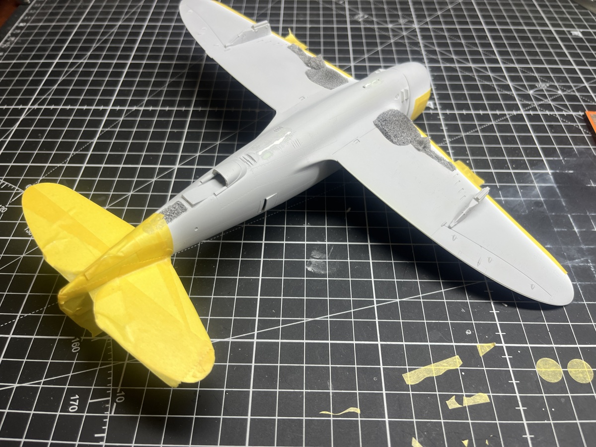

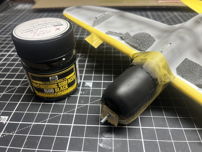

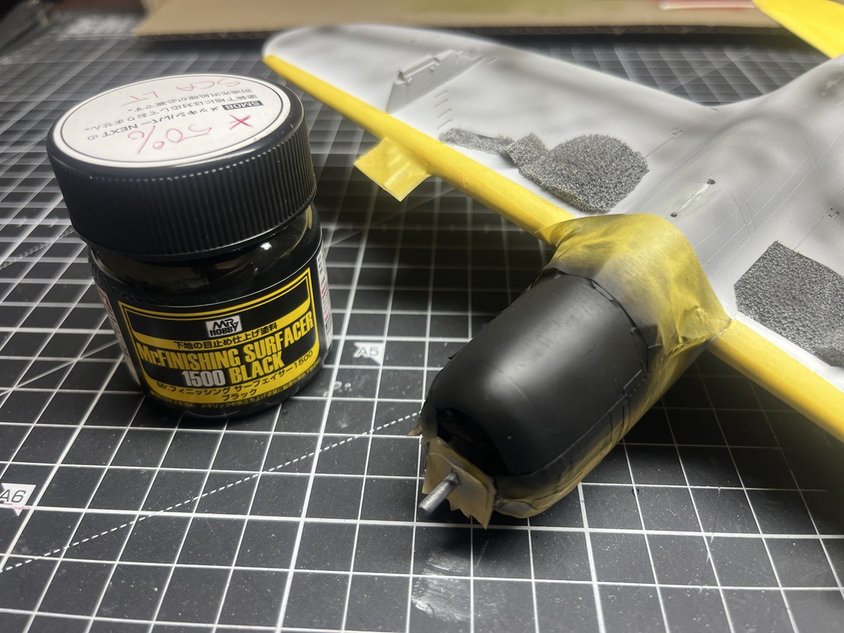

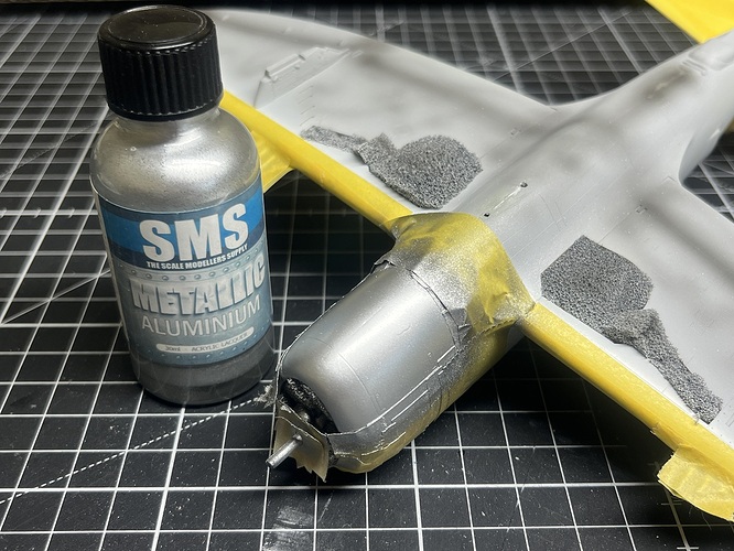

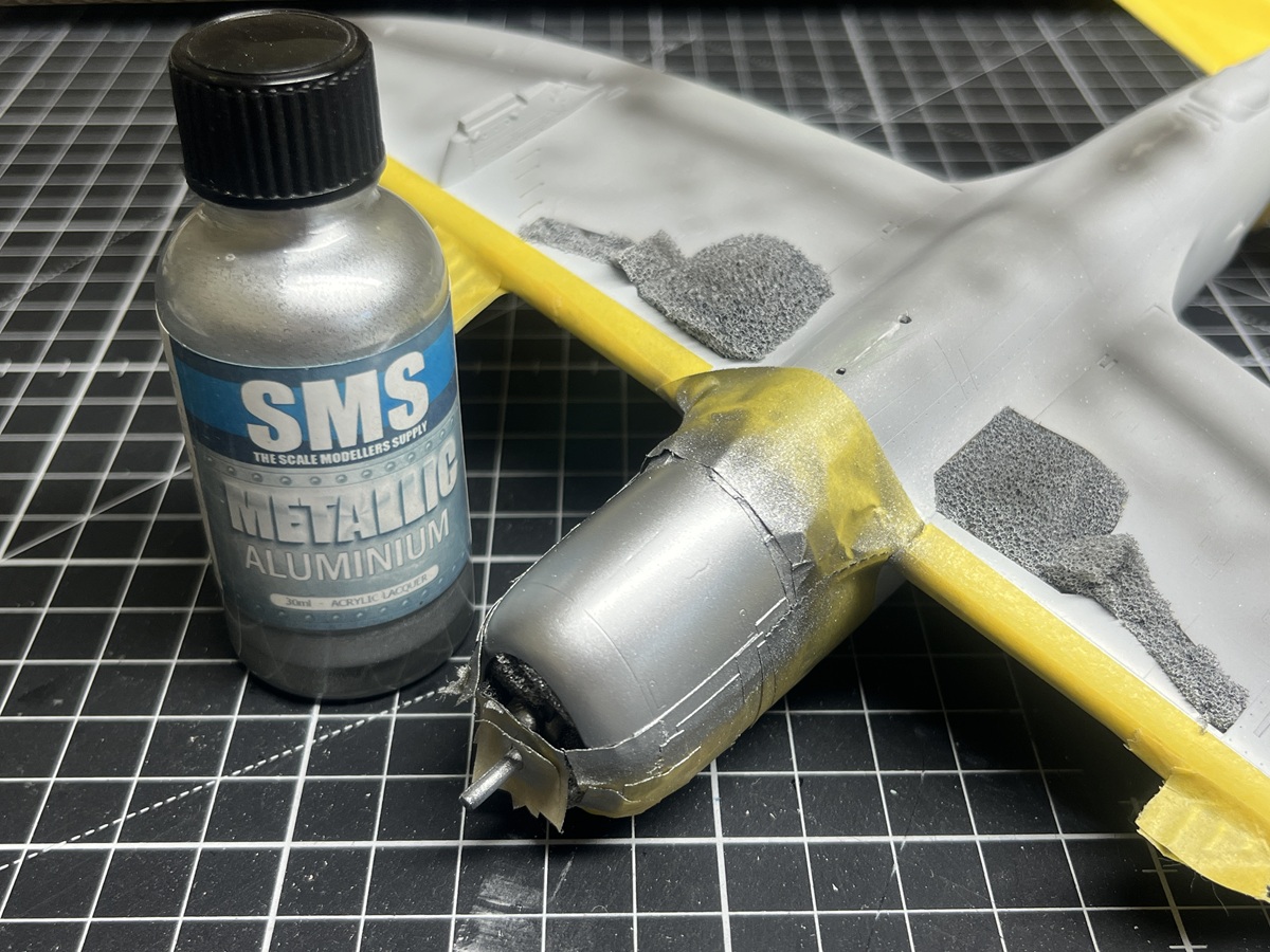

MS1500 Black primer as a base coat for SMS Aluminium on the bottom cowl section NMF and then . . . . . . . . . . MORE MASKING :pensive_face:

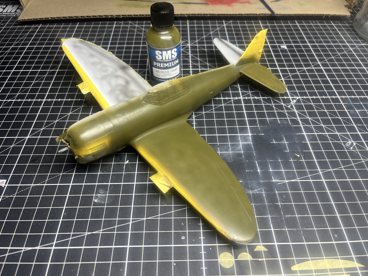

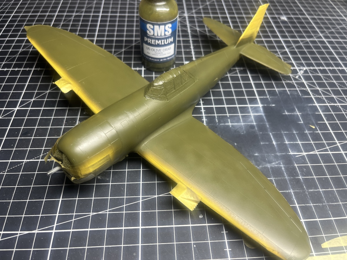

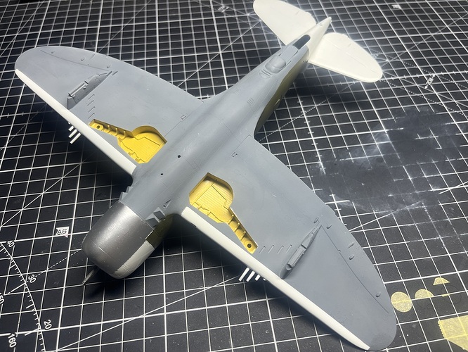

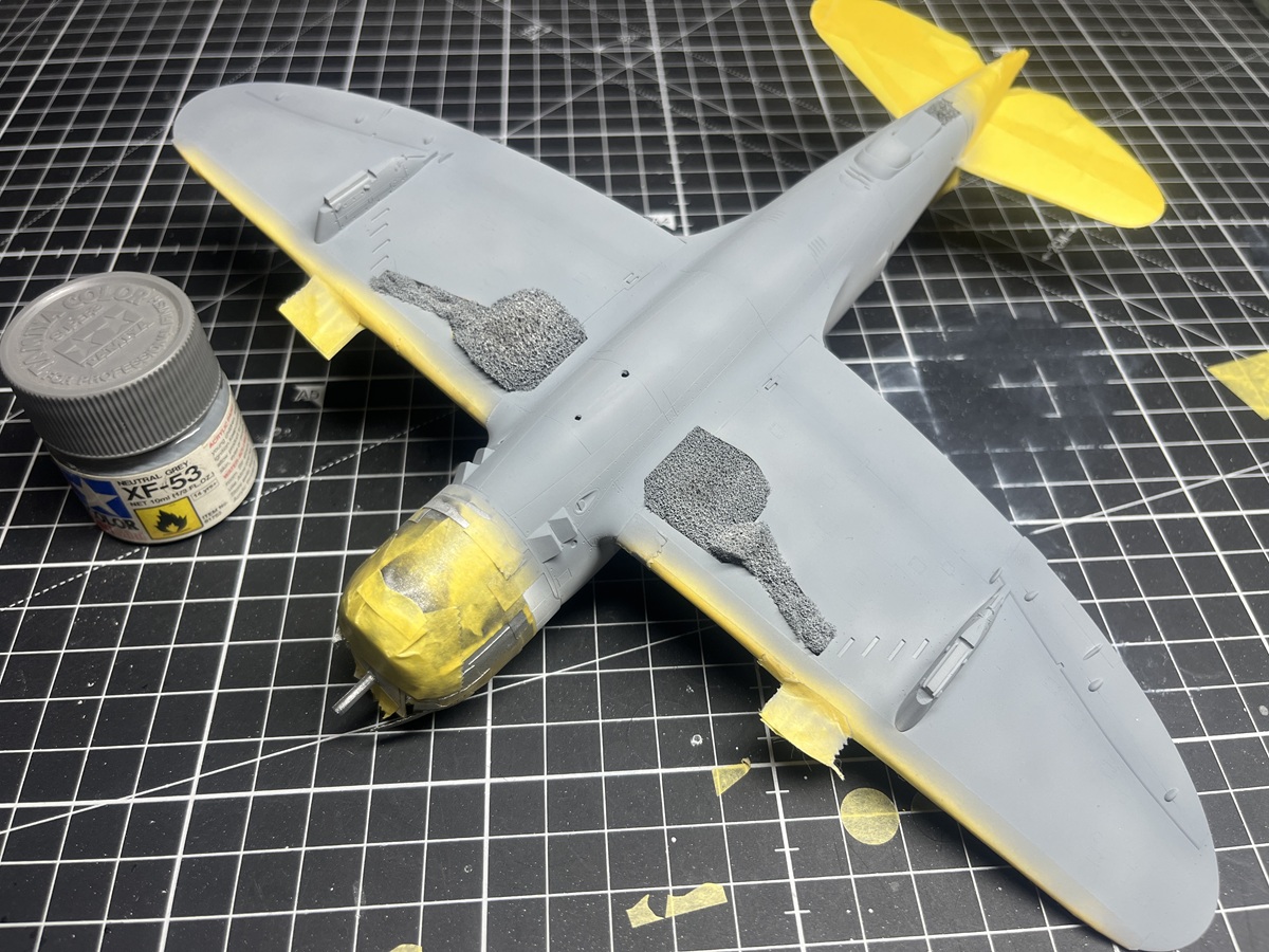

Tamiya Acrylic XF-53 Neutral Grey thinned with MLT on the underside, SMS US Olive Drab topside, freehanded the main colours . . . . . . . NO MASKING :heart_eyes:
And then . . . . . . . . . . UNMASKING WOOOHOOOOOO!
Cheers, D

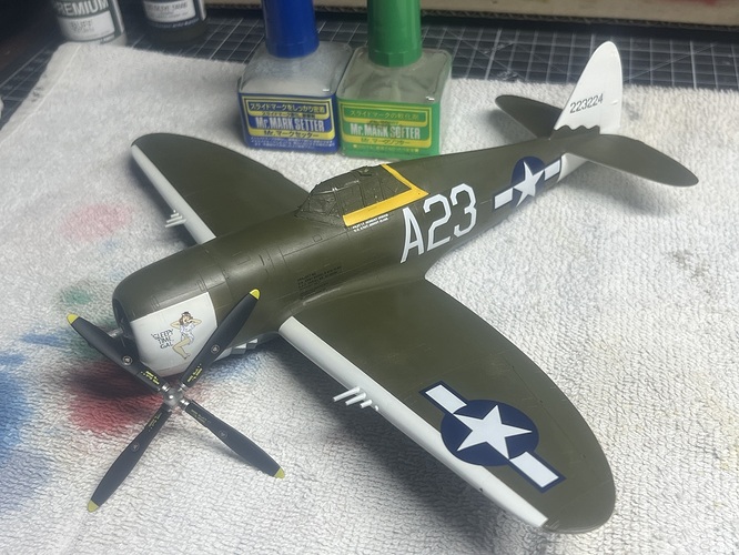

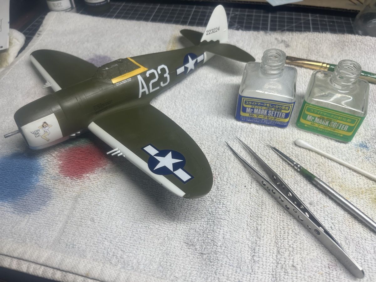

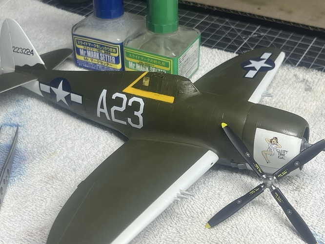

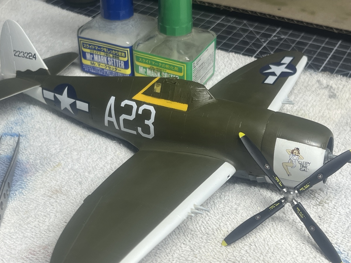

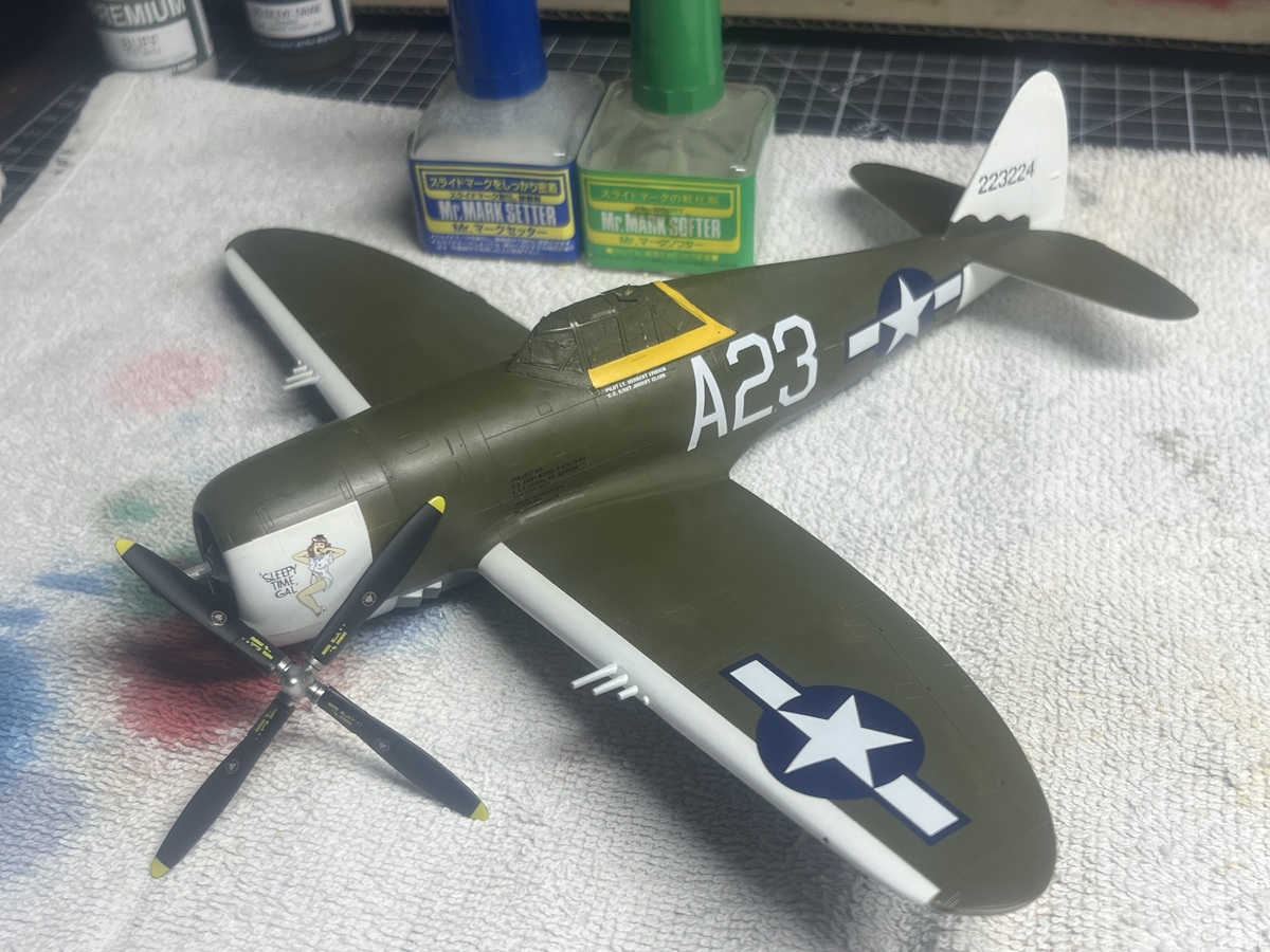

Nose art, pilot stencil and codes from the Super Scale set, insignia are leftovers from past builds. I’m not going to bother with all of the small stencils on this one.
Overnight dry time then flat clear and some weathering to follow.
Cheers, D

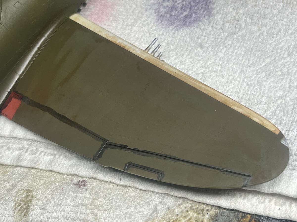

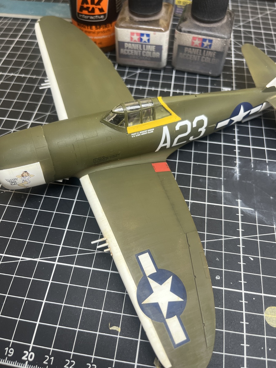

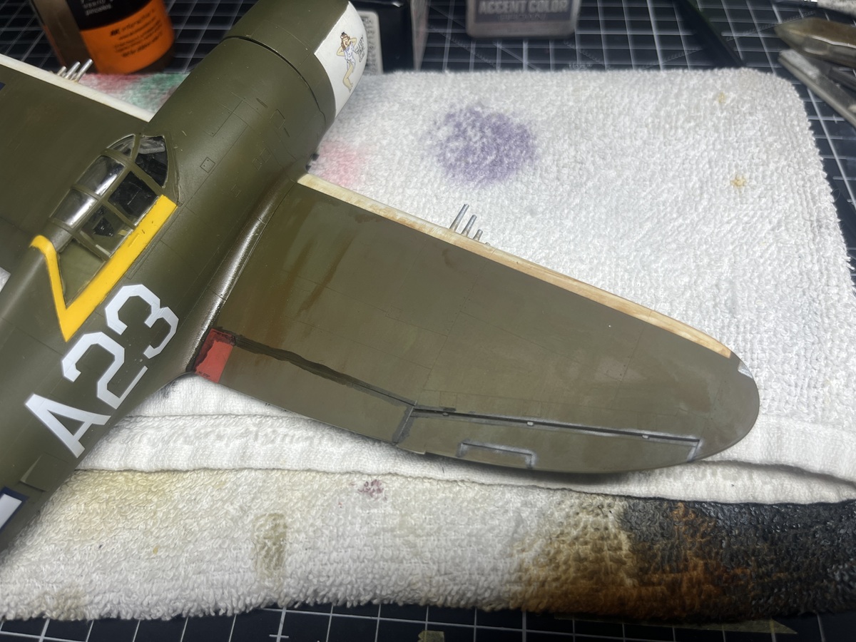

Some progress on the weathering, I used Tamiya PLW loosely splashed around and then fine tuned with brushes and Q-tips dipped in odorless thinners.
Port wing done
Starboard wing initial stages (ugly grimy mess).
Lots of fun doing this part.

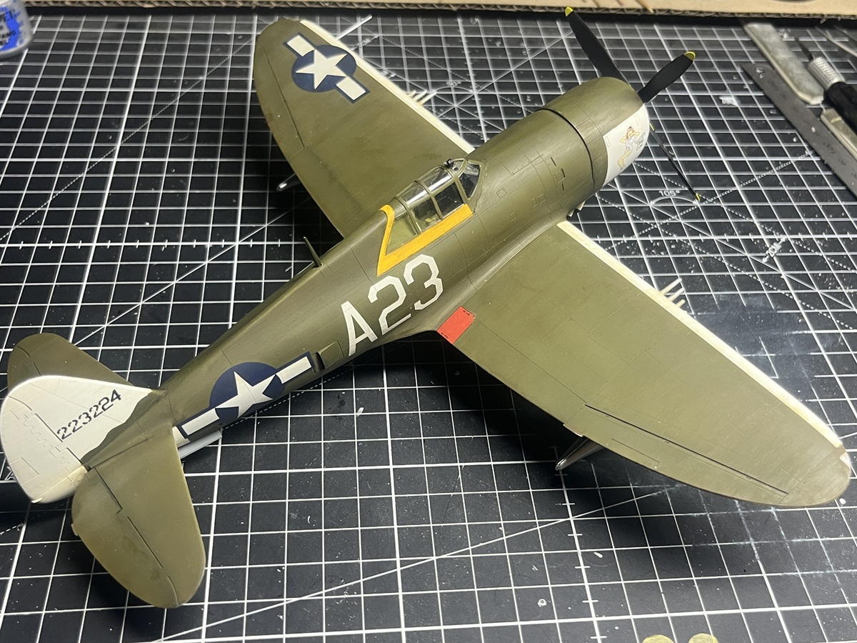

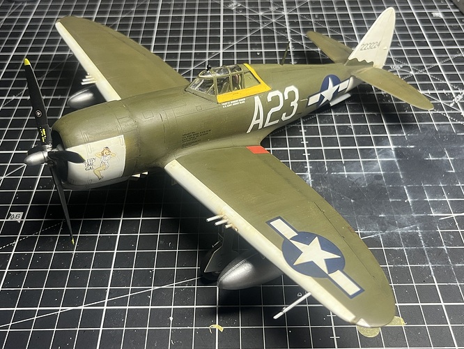

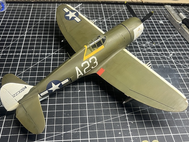

Completion #2 for 2026! I cracked on and pushed this one across the line last night.
The weathering is a bit clumsy, I was experimenting with some different products and techniques as this was a cheap kit and “quick” build as a test bed. Lots of lessons learned for the next P-47 :smiling_face_with_sunglasses:
Thanks for following, onwards and upwards!
Cheers, D
