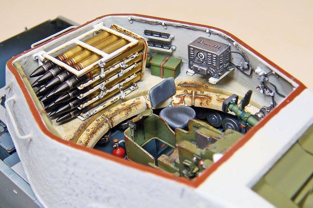

Of course, all of these can be “weathered” on top of the base color, and my own approach is to imagine the final desired appearance to be composed of a series of semi-transparent layers, stacked one upon another, so, base color, washes, filters, chipping, staining, scratching, etc. All build up to create a final desired appearance.

Exposed steel rusts pretty quickly, like overnight! I go with a very dark brown, if it’s chipped armor. If it’s just an overnight light rusting, like on tracks, then a sparingly light rust color. This rust is like a powder and wears off when the tracks are in motion. Metallic colors are too specular, unless you want to show a recent large caliber hit. Steel that has been exposed for a long time is a darker rust color than overnight rusting. You can also use gray (for the steel) with a rust color wash, for different effect.

So true, I am an Army maintenance guy and am not a fan of rust, so I like to paint my tracks with a steel and then hit it with the track wash. So, they look like newish track that has been just put on.
