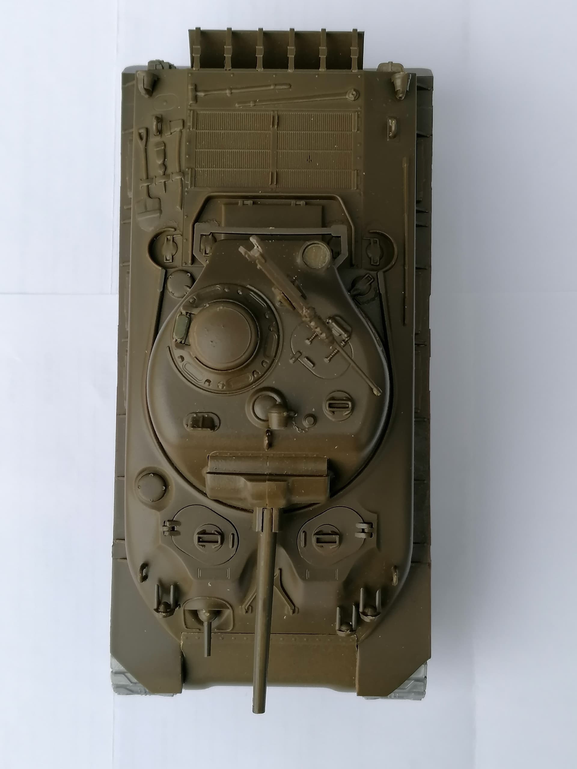

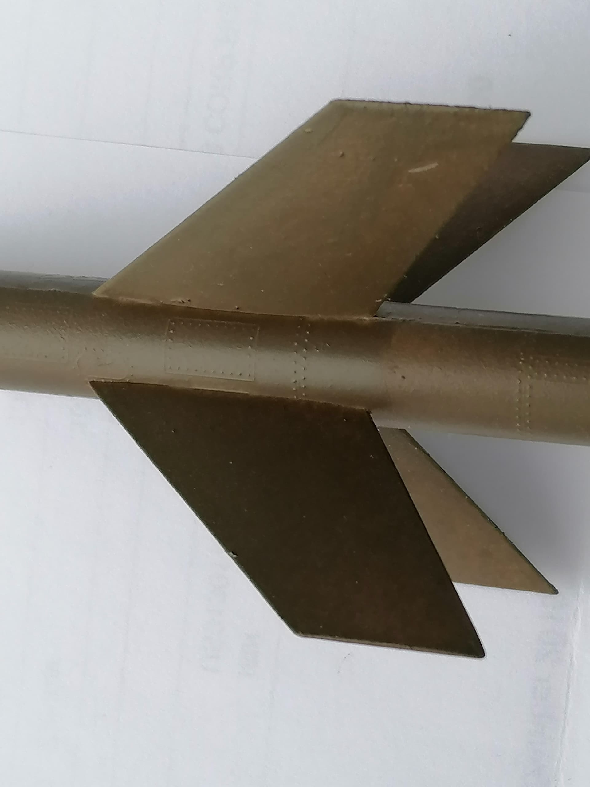

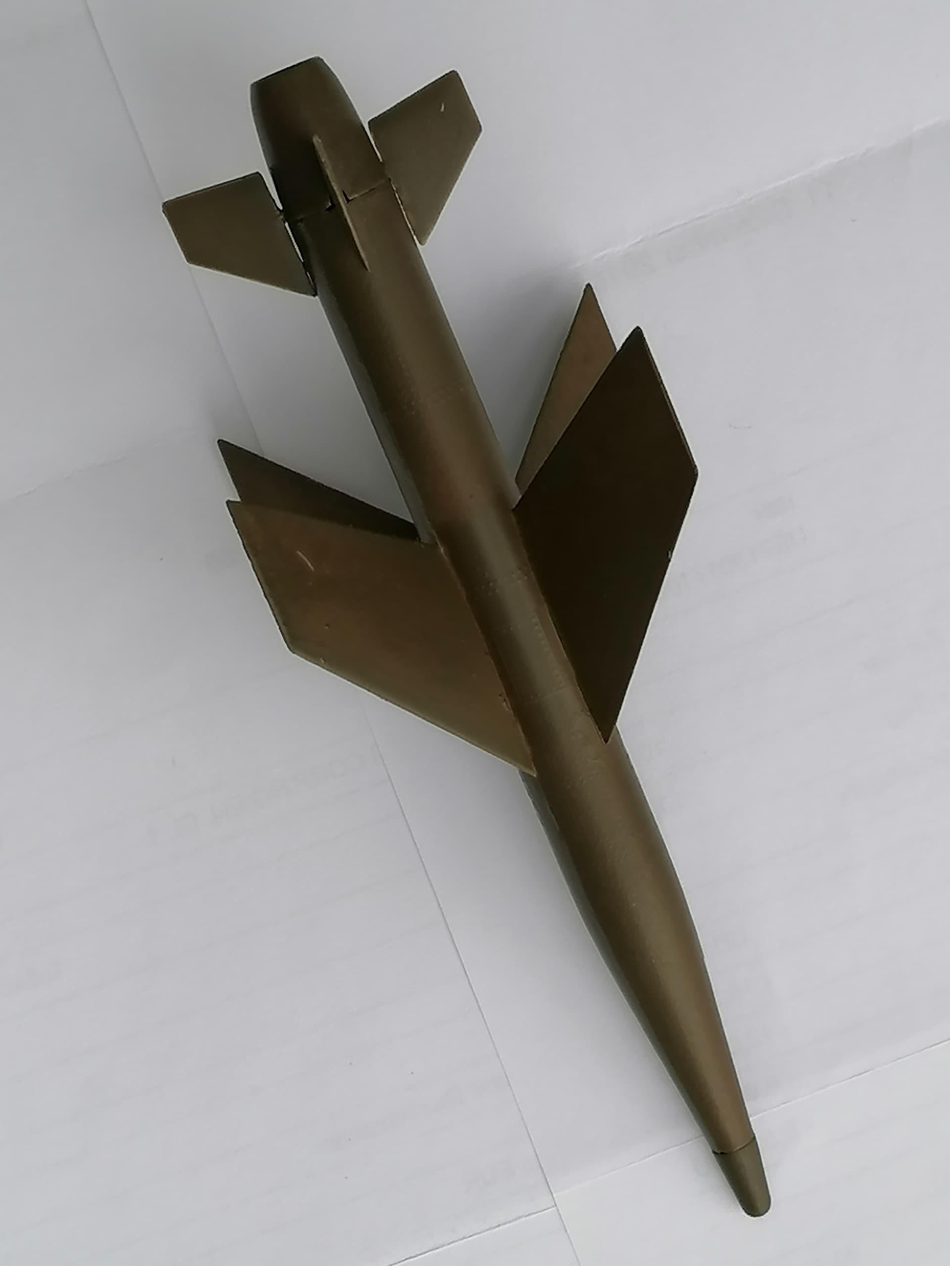

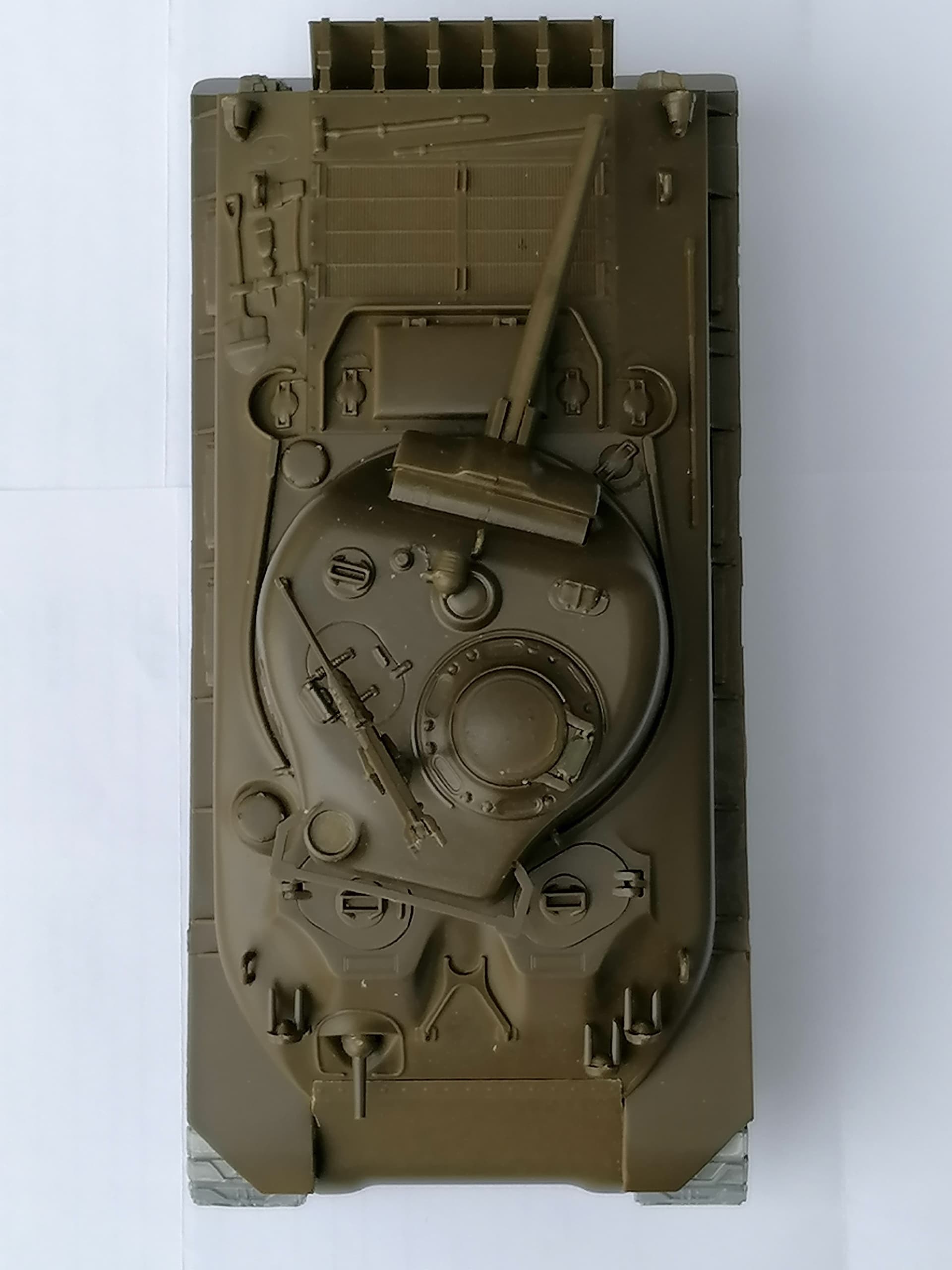

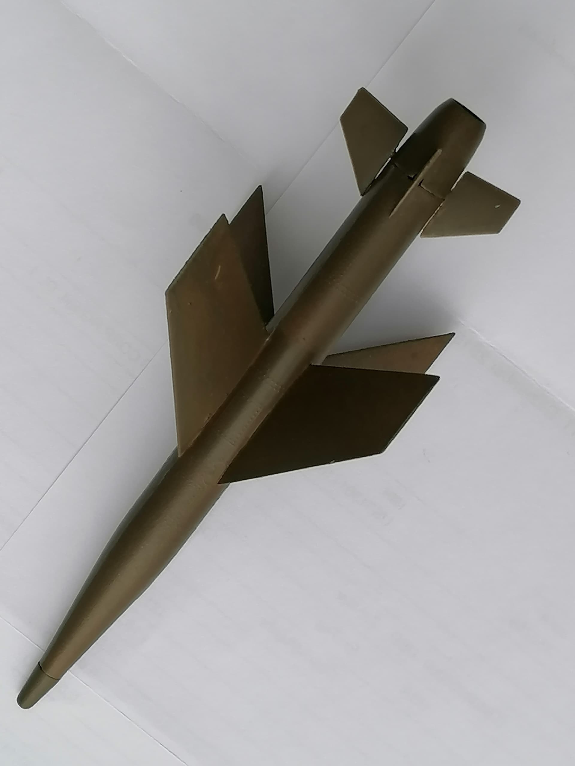

In 1966, a fellow Bundeswehr conscript “liberated” a half-empty rattle can of the Olive Green we used on our 1:1 M41 tanks and gave it to me. Obviously, my modeling and painting skills were in their very early stages, so no priming etc. - please take these pics as color refences only! What a difference the base color would make can be seen at the tip of the Lacrosse missile where I had replaced the kit’s white nose cone with one made from olive green sprue. And I have absolutely no idea what RAL number the stuff might’ve had. (Both kits are by Revell, claiming to be 1/40 scale.)
Note: the definite brownish hue ist not only in the pictures, but on the models, too.
Peter
