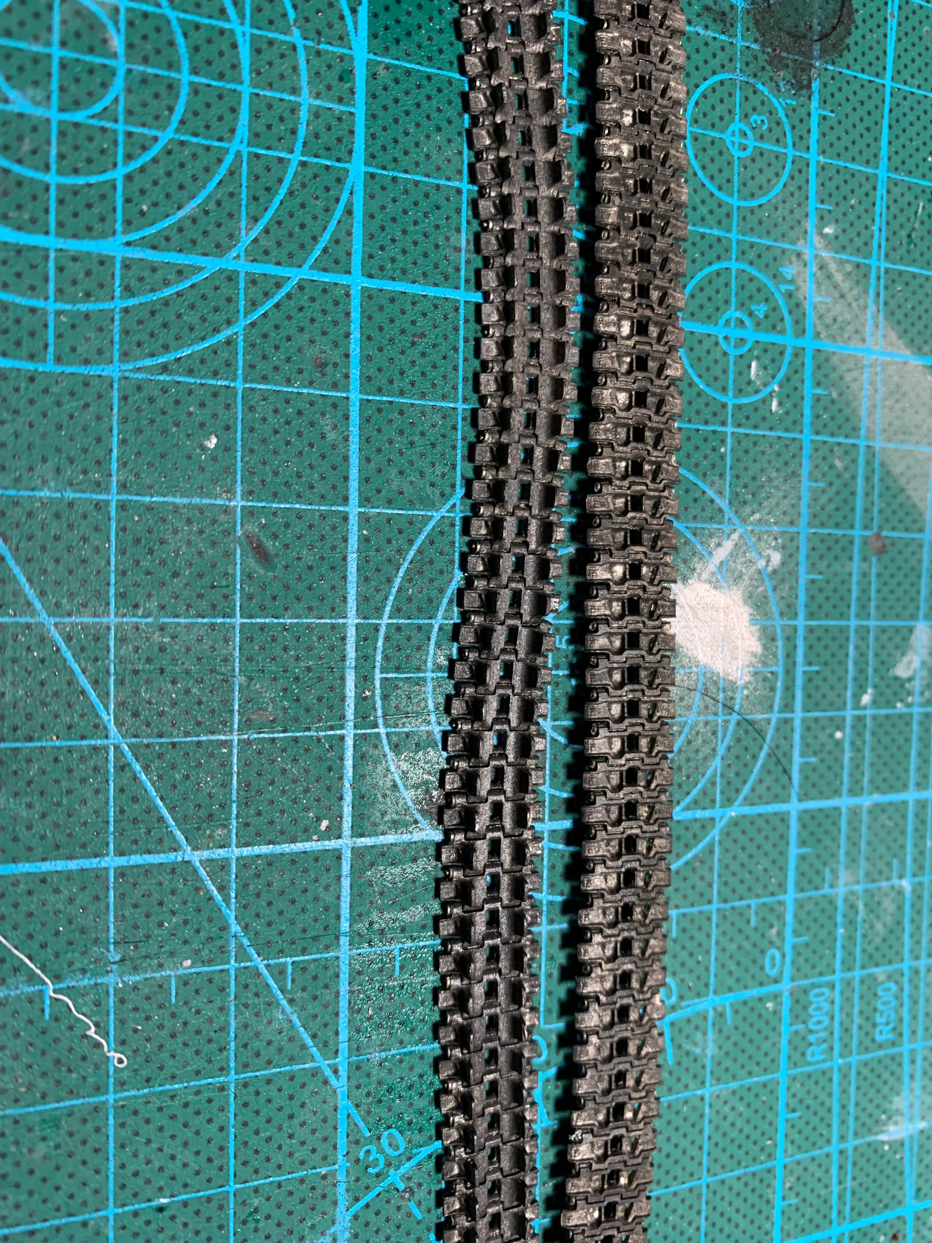

Think I’m sold, here is a test track

Thanks for the advice! I gave it a try.
Really happy overall! I did notice some spots where the blue didn’t take, possible it didn’t have enough contact time. Considering giving them a second dunk, or hitting letting weathering cover it up. Most noticeable in picture 2.
The tracks also developed a tannish brown colored deposit which is some of the speckling in the photo. May need to scrub them a bit more
Those small bare spots are an almost universal problem with any of the chemical coloring solutions and metal tracks (all brands and sizes). I’ve yet to sort it out and discover the actual issue. Pre-washing with soap and water seems to help some (perhaps creating a slight “wetting” effect). Agitating also seems to help, but also doesn’t completely eliminate the issue. Nytril gloves and a scrubbing in the cold blue solution works, but it’s really messy, and, IMO, hardly worth the trouble if later weather.
Good to know. I did follow your instructions, so glad it’s not just my error, I plan to dirty them up some anyway.
