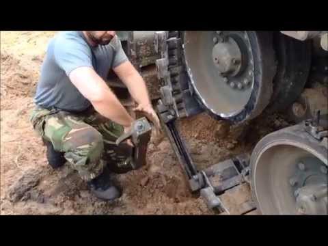

Leopard tracks are not painted at al… And why should they? The amount of wear just by driving around would get rid of the paint very quickly.
Here is a nice video of track repairs, showing some great details…
D’oh :man_facepalming:
Should have checked first. I was going off the instructions but you are right they look unpainted on every tank photo. My bad!!
Just edited my post by adding a vid…
Ahhh, the joys of fixing track! Lovely video, by the way. Lots of memories there.
Ken
I didn’t know this operation. Thank you for the video.
You really need to research tank track type before painting them. If you did this color pattern for modern Russian tanks it would look good but it would be incorrect. Their track is almost a bright steal color when used.
