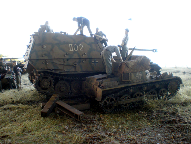

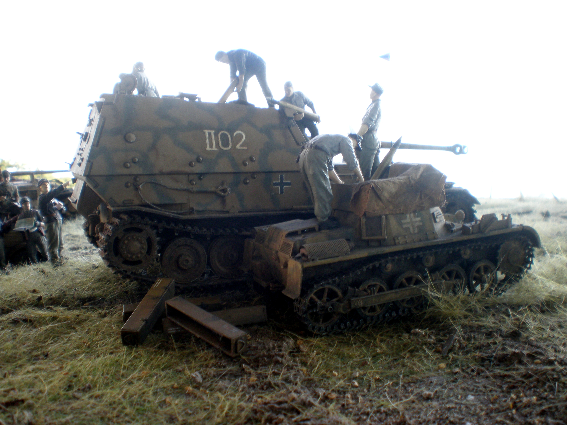

Once I did apply some OD with a sponge over decals to show some chipping of the white and yellow paint:
