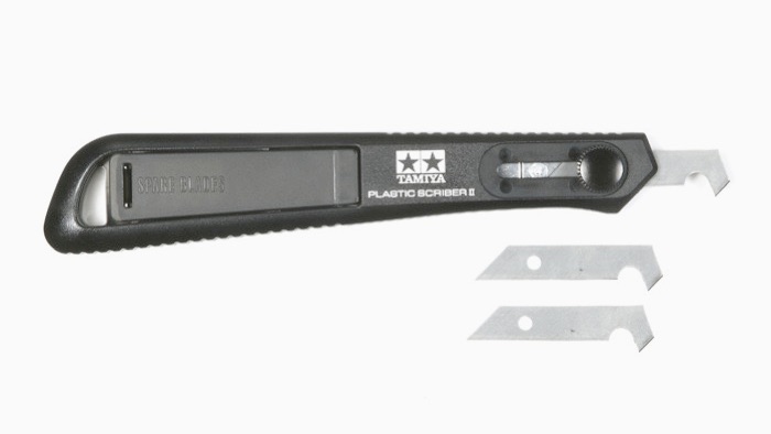

FWIW: The ‘Tamiya Plastic Scriber II (74091)’ has been my general go-to.
‘Plastic Scriber II (74091)’
More options to consider (3 different profiles)

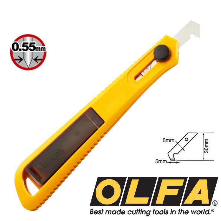

And if you cannot find the Tamiya scriber you can go for the olfa one which is the original manufacturer

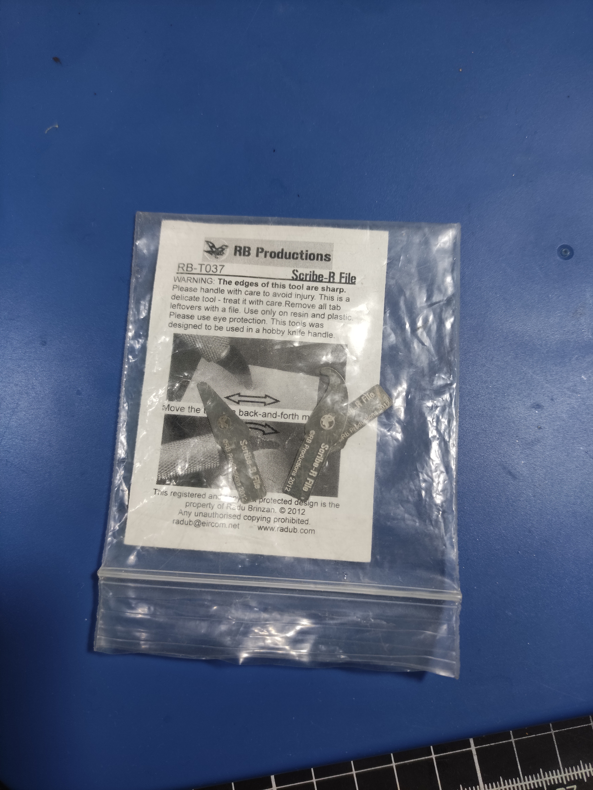

Apart from the Tamiya scriber, I also have these from RB Productions:

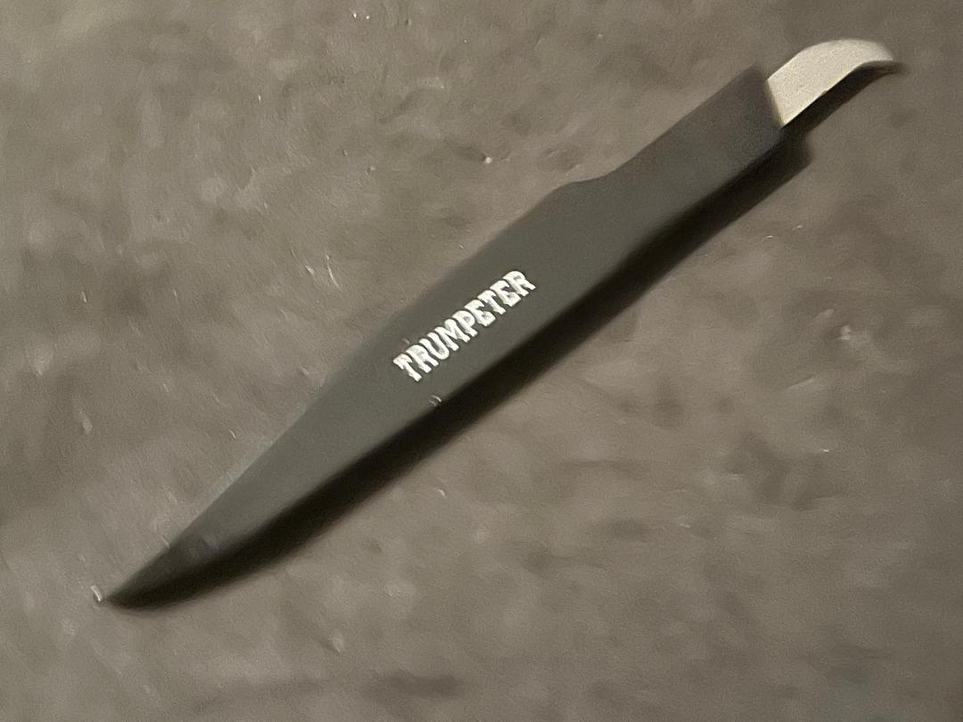

yeah i have the trumpeter one as well
