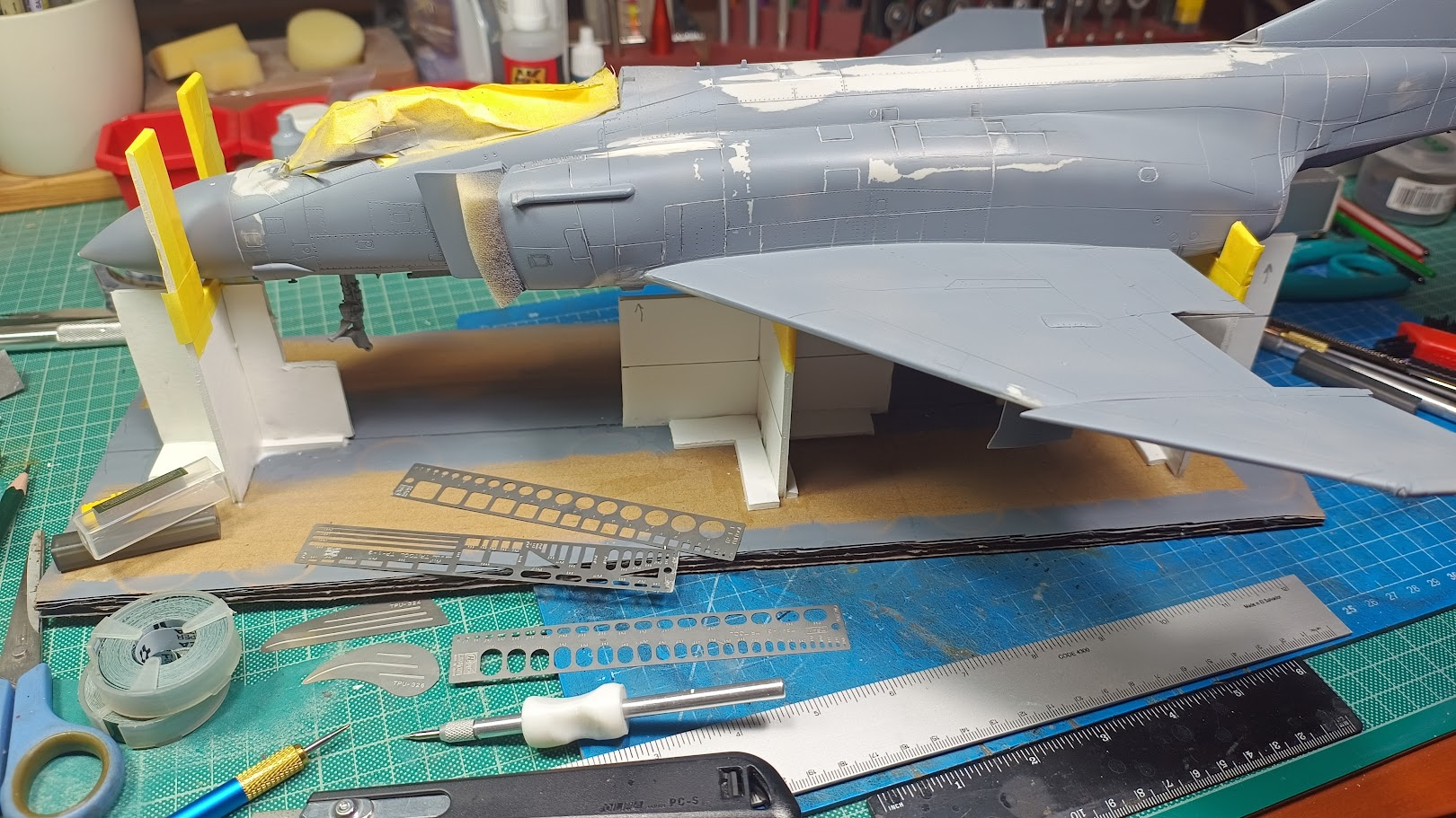

Dymo tape, Hasegawa tritools for panel shapes. I also use the sides of the tritools as rulers.

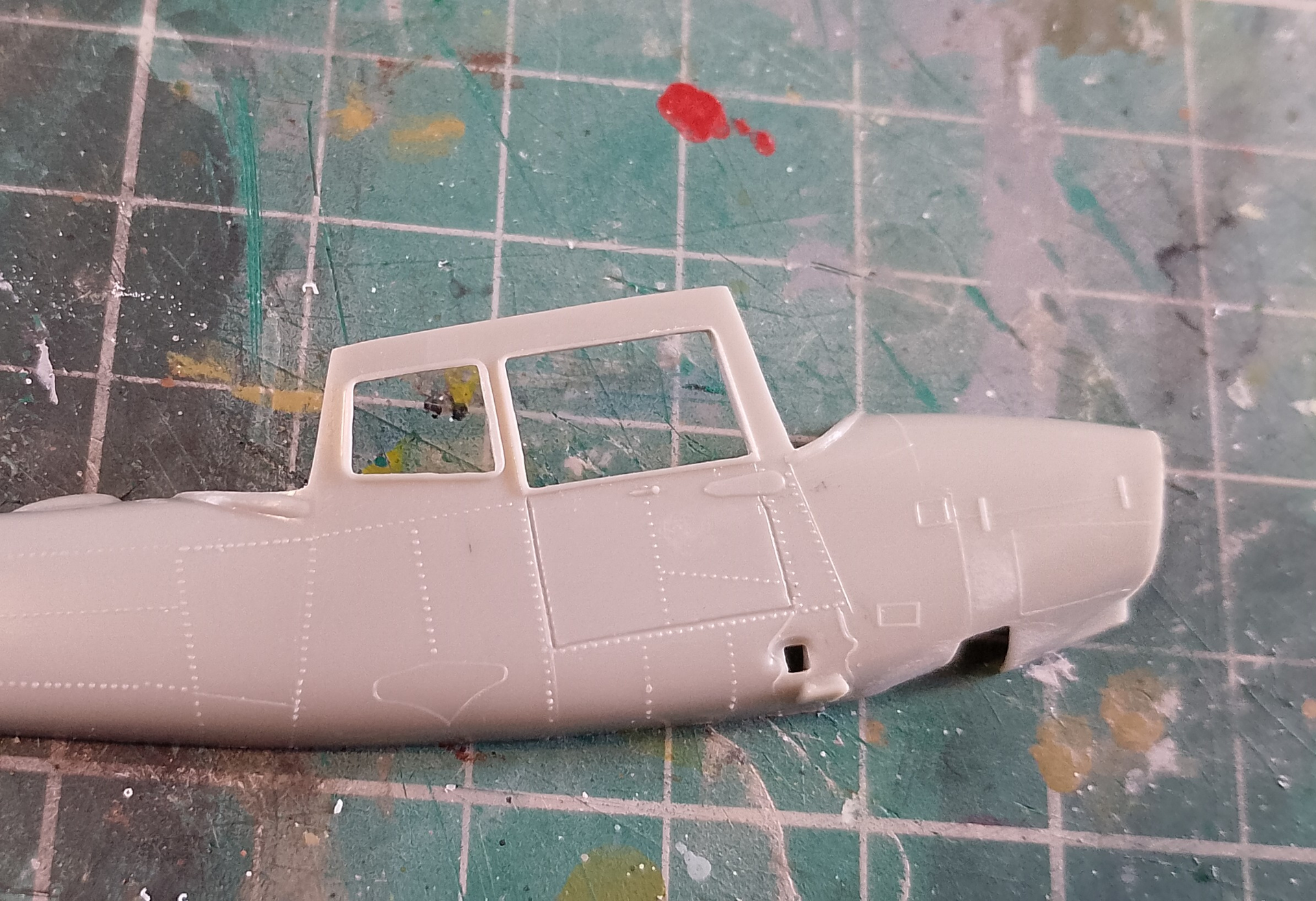

Used Dymo tape today to do the door on the old Airfix O-1. Cut a piece into 3 thinner strips, attached, scribed and then used a little Tamiya ultrathin to clean it up.
I’ll also use a steel ruler for longer lines. It’s not often I rescribe lines, usually only if I really need to. As for doing curves, yeah still haven’t found a way to do that.
Is that the Birddog kit that is missing the odd shaped window that has to be added? I think I have it in my stash but I can’t find it.
A missing window? You never I’ve never noticed. And I’ve built several of these over the years. Bloody undercarriage is always the first thing to go.
I’ll have a look at that though. I know the O-2 has a funny shaped window on the pilots side.
One of them does. I bought three different observation aircraft a few years ago and can’t find them now. But yes - the window had an odd shape and either had to be reworked of totally added. I can’t remember which.
