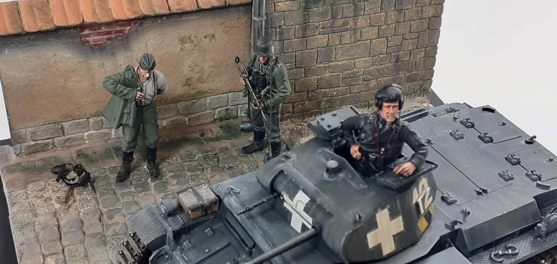

Panzer II D Pologne

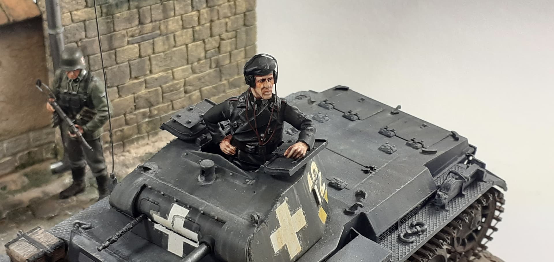

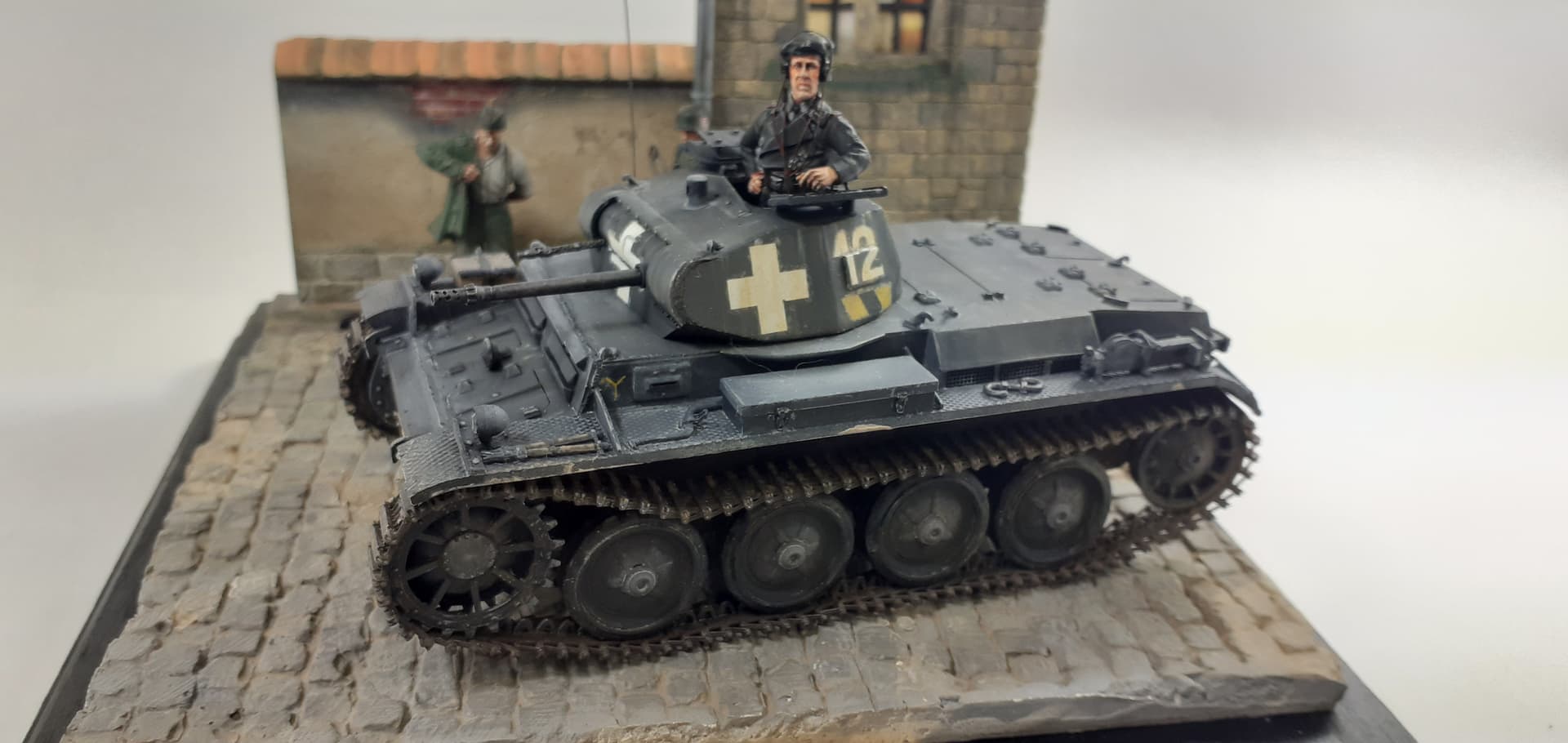

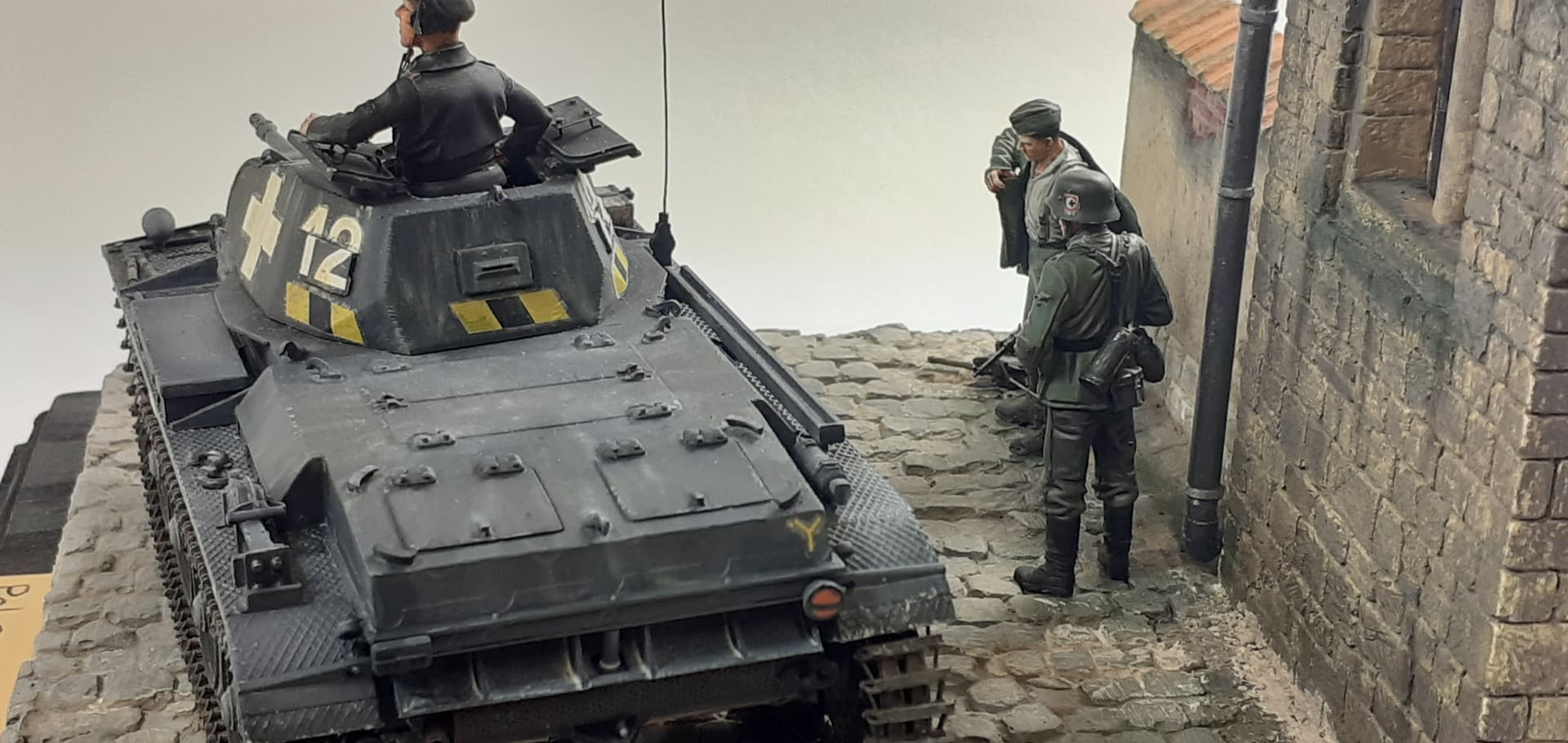

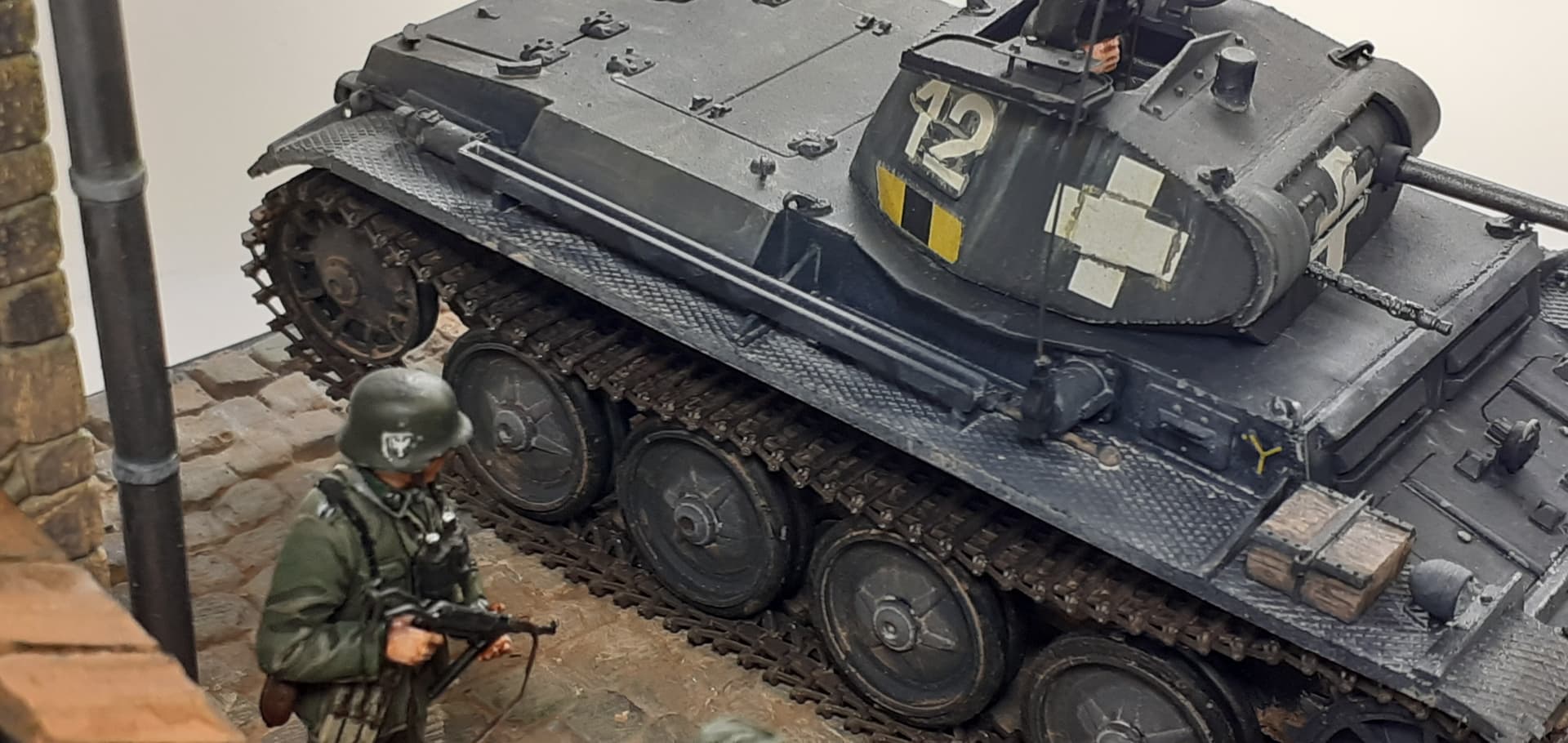

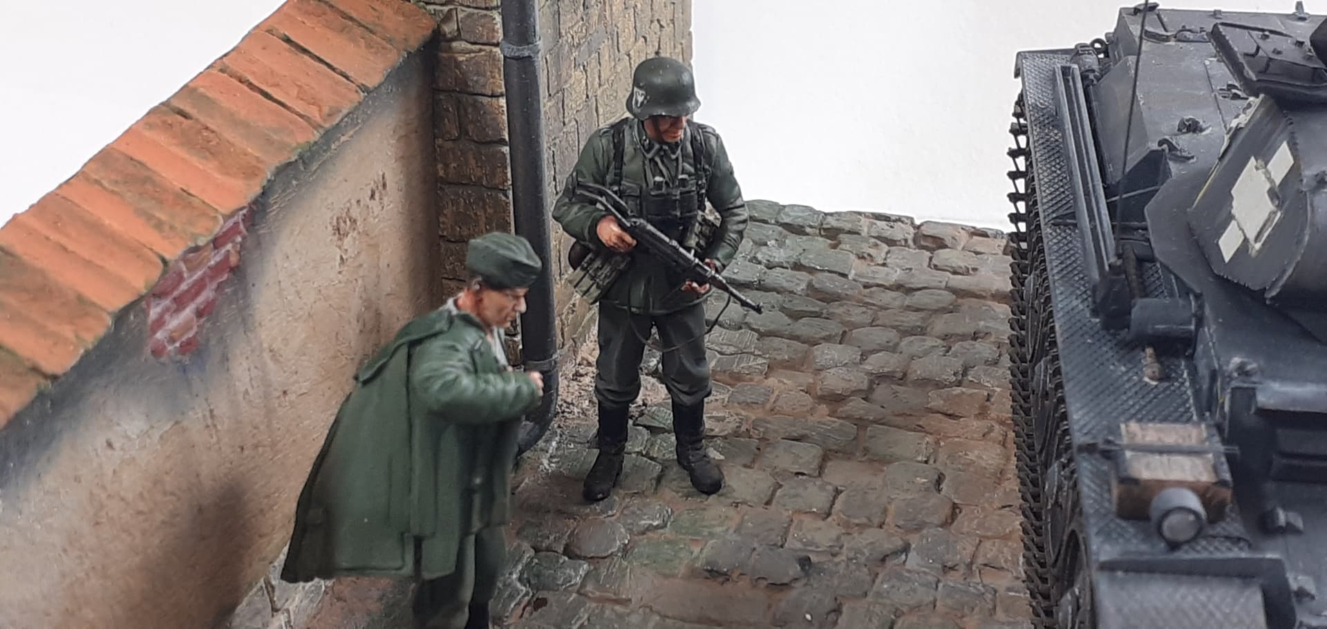

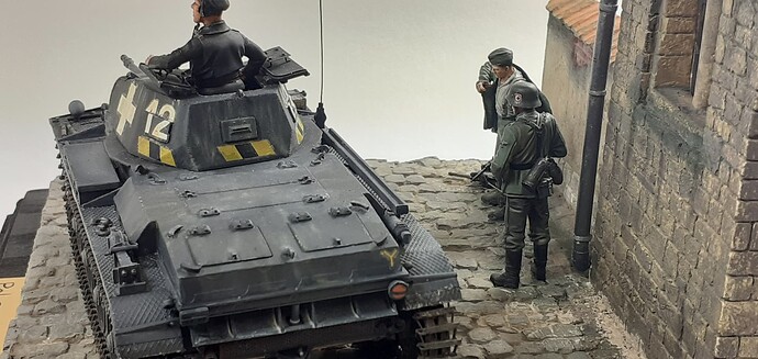

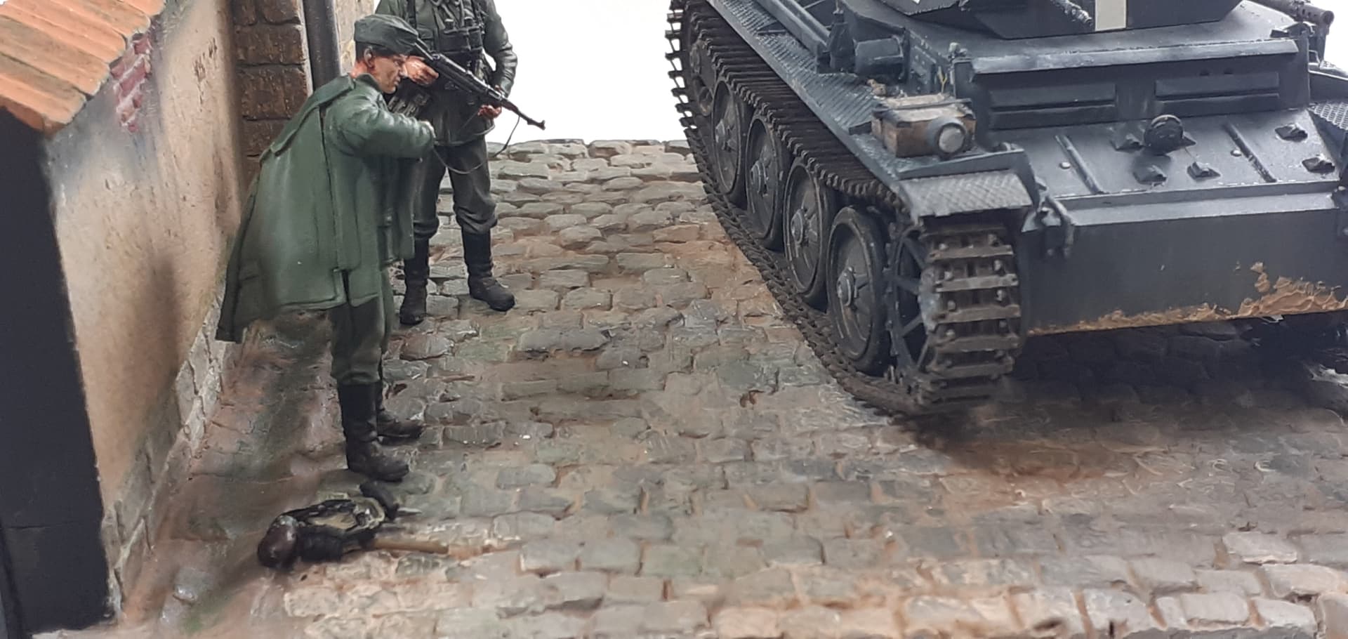

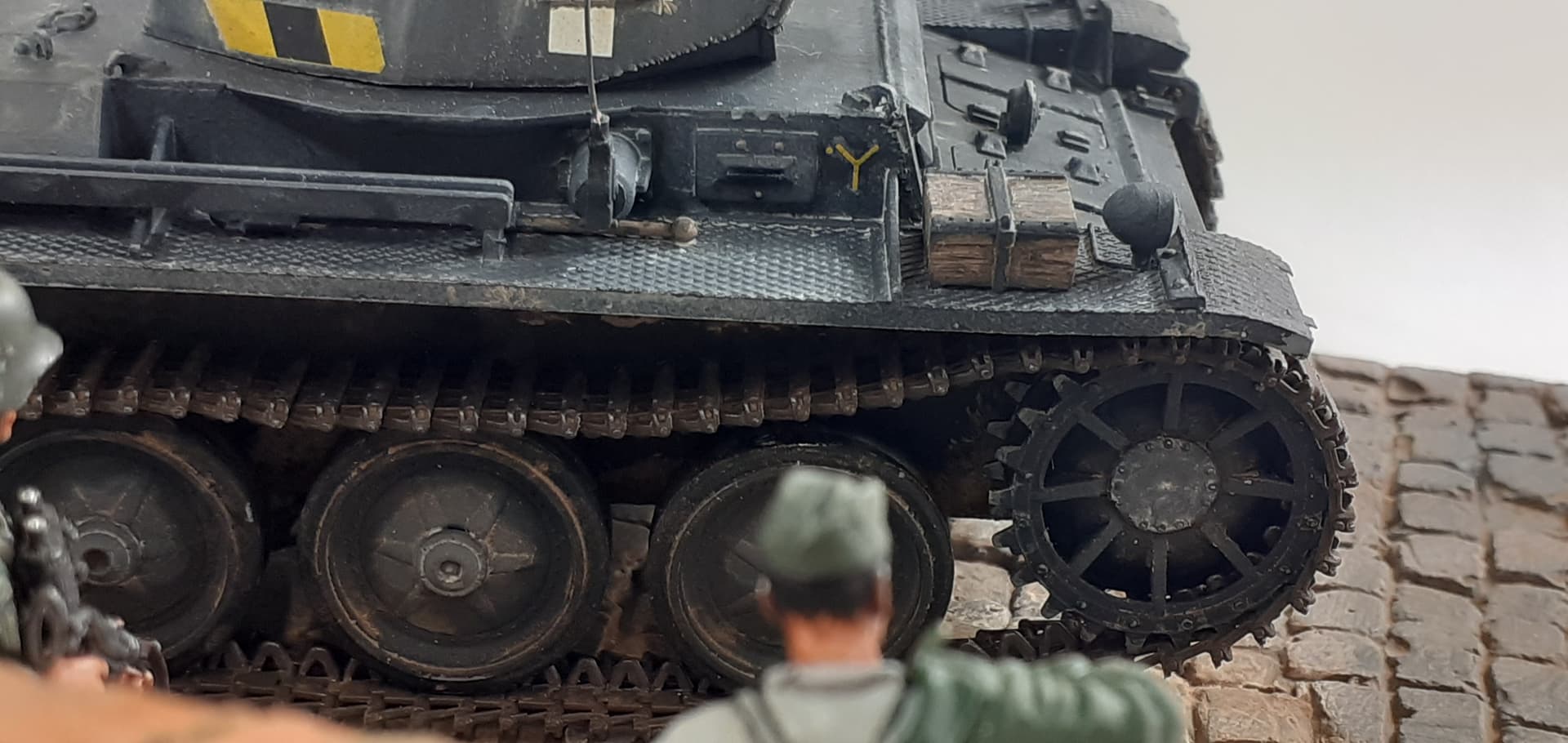

hello friends my latest diorama.
To my knowledge, only Bronco released and perhaps Gecko, there has been work to bring it up to date.
lots of details have been redone on the turret, elements from Panzer III were used for the damping system, the barrel was drilled with several holes, I redetailed the jack, the tracks come from the scrap box, lots of parts have been refined the putty is required. The on-board prize also comes from the rabiot box.
Thank’s and Happy new year.
Pascal76.
Pascal, nicely done! The attention and detail to the tank commander and his head gear really stand out. The head phones were the first detail to catch my eye.
Looking forward to seeing more of your work.
Beautiful work.

I really like the figure putting on his jacket. Did you make this figure?
Ca c’est superbe mon vieux!! J’aime beaucoup le soldat qui met son manteau. Aussi les pavés et les murs sont bien faits. Bravo!

A very fine job indeed! As well as the orange headphones, there are a number of detail points from this early stage of the war that are not widely known. In the interests of historical accuracy I would offer the information that the tank would almost certainly have had splodges of brown cammo paint (very hard to see on old photographs), and leather Y straps were rarely if ever seen on German infantrymen during the Polich campaign.
