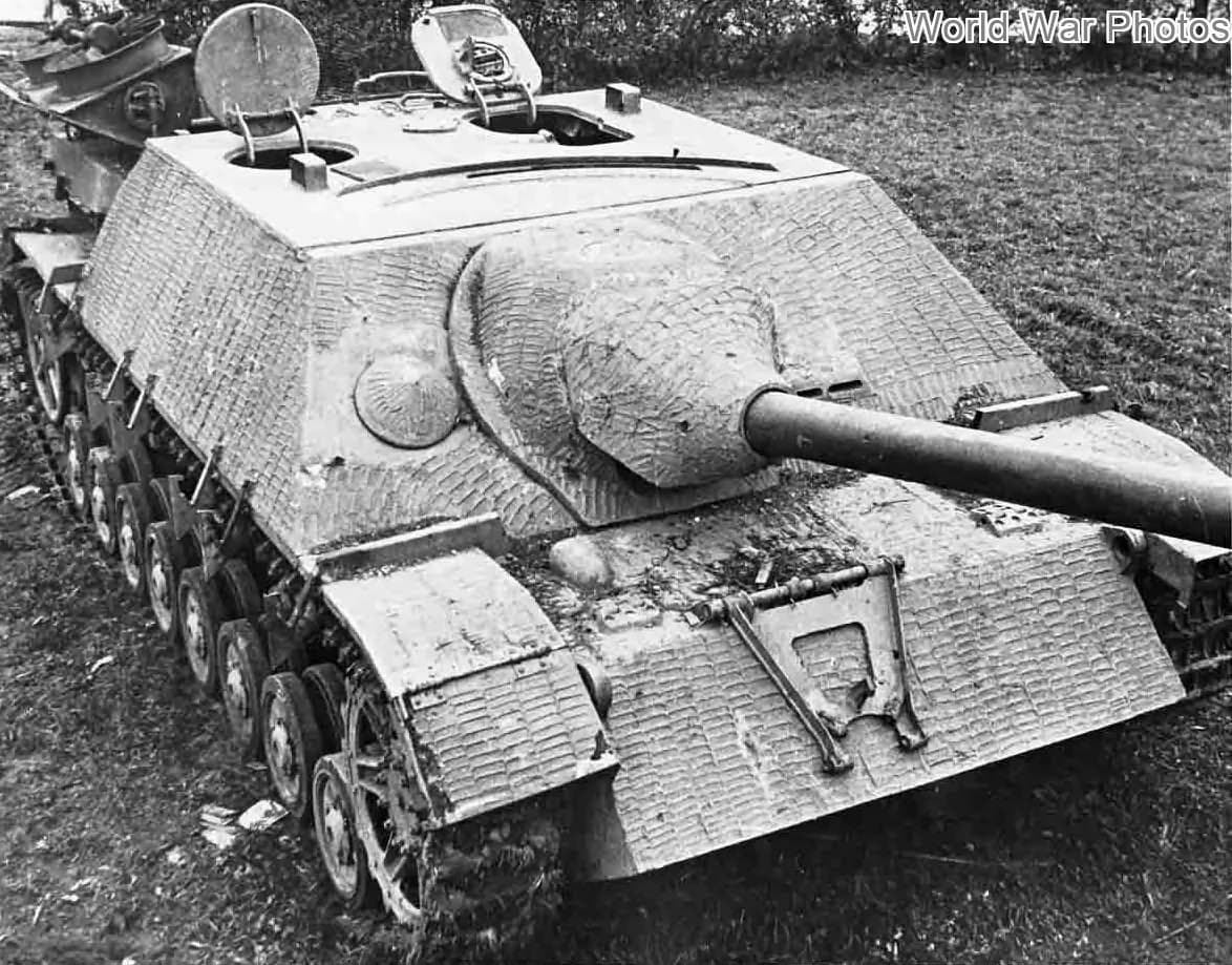

Finding photos of PzJg IV/48 and /70 V with Zimmerit are not a problem.
Zimmerit application was ordered to be discontinued on September 9th, 1944, so there were probably less than two dozen PzJg IV/70(A) completed with Zimmerit.

Jagdpanzer IV 70(V) with zimmerit
Alkett versions can be found, it’s Volmag versions with Zimmerit that can’t be found.
Wrong! Geez… :woozy_face: Other way around. V’s can be found, it’s A’s I haven’t seen.
