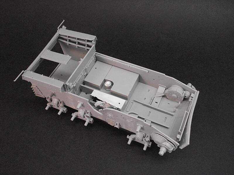

Hy!

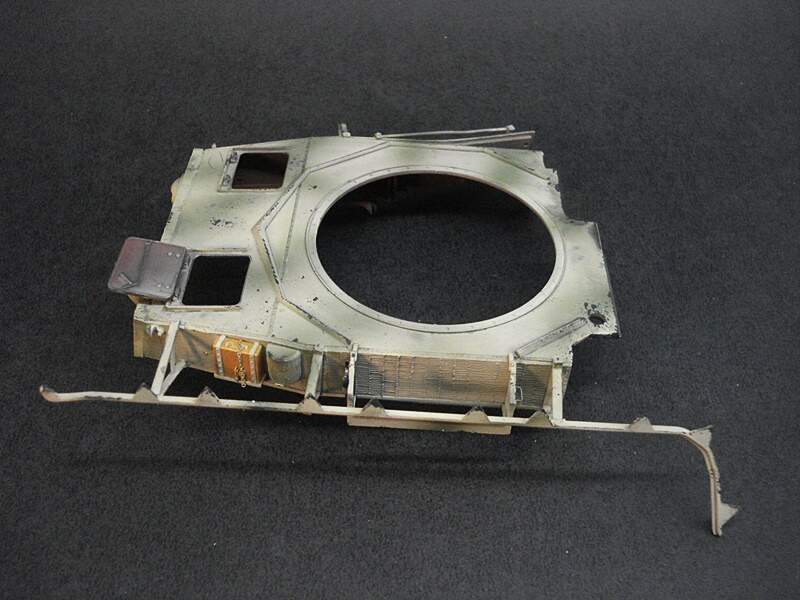

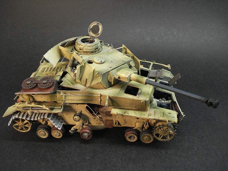

This is a very long term project. I really don’t remember when I have started it. Anyway in the meantime a lot of Panzer IV kits with full interior have been released. To put forward the plans I have to use parts from Dragon (DML), Trumpeter and scratch to achieve the desired configuration. The hull came from the spare box and it’s DML. The engine compartment, transmission an interior from Trumpeter Östwind, the upper hull is from DML Ausf H unused parts. The tower is also from DML spares, included the inner basket. The tracks are from RFM and there are also some Tamiya tools and accessories included.
Till the next step.

Hy, Jerry!
Thanks for the words. I’m certainly not an expert about this matter. The Elfenbein color was effectively used inside the german tanks. Toward the end of the war the Red Primer becomes more evident. According to my references only the side walls, ammo boxes, instruments panel and the roof was painted Elfenbein. The turret was also painted in this color (except the floor) .

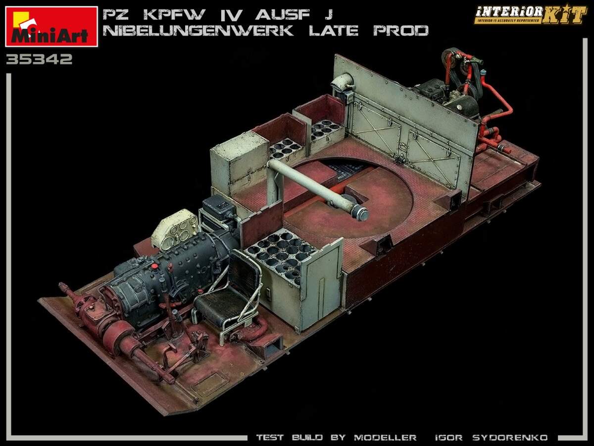

I intend to show a vehicle partially burnt out and I’m still wondering what to do about the light color parts, how they look after a fire or a explosion happens inside. It’s not the same vehicle but I’m using the MiniArt Catalog as a guide. Just for the discussion purpose.
There’s a lot of work still ahead.

Thanks, Richard. But I should better choose another way to go. I’m not sure about the kind of finish I have to do.
Yeah, maybe it should better to abort this kind of finish, close the vehicle and throw it in a ditch. It will be much more practical. Thanks a lot for pointing out those details.

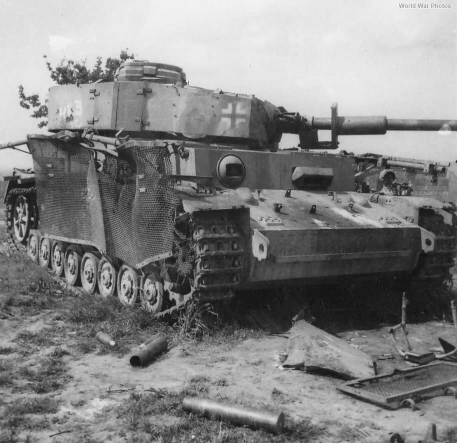

And another J model; this one with the “Drahtgeflechtschürzen.”
Jerry and Carlos,

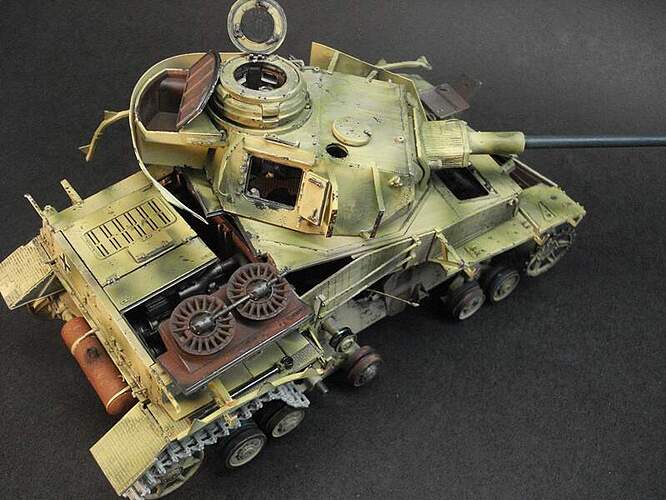

I should try another aproach. My first inttention was to make something like this, a frontal penetration (over the frontal transmission deck - hit the ammo depoist, right side and an internal explosion but not too much burning:
Anyway something has to be done. Thanks for the words and directions.

My first inttention was to represent a vehicle hit by AT fire with an internal explosion. But I’m not sure if this can cause also some “burnings” and how to represent it. The files you posted had some very interesting wrecks of Panzer IV. I will study them carefully and see wich way to go. Thanks a lot.

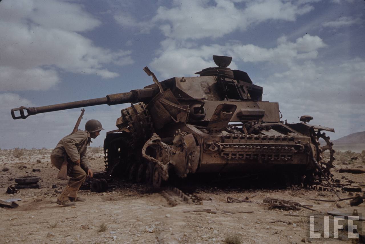

There always these ones from the same Life series as the Panzer III photo that I posted earlier taken in El Guettar Valley

Hy Carlos and Glenn!
Thank you very much for the support and the very good words. I will try to go ahead with the references you gave me. I hope I’ll find the proper way to finish the job.

I got what you mean and appreciated what you and the other fellow modellers have done. I guess I will do a little deviation on this project using those new intel (for me at least). However it will take some time.
Thanks a lot.
