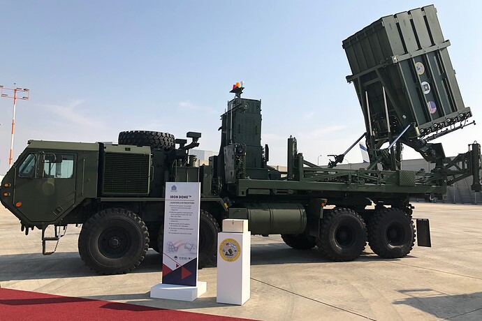

Isn’t Israel’s “Iron Dome” basically the same tech?
The “Iron Dome” is a counter-rocket, artillery, and mortar (C-RAM) system that is cheaper, lighter, more plentiful, and meant for other purposes, mainly to intercept incoming artillery and drones on friendly troops. “Iron Dome” has a range of about 43+ miles (70 km). It isn’t really meant to intercept supersonic aircraft but can intercept slower drones, cruise missiles, and rotorcraft.
Patriot is a SAM for air defense and is meant to intercept high-speed aircraft, rotorcraft, and certain kinds of high-speed ballistic and cruise missiles. Due to miniaturization technology and smaller microchips, what was once four Patriots in a launch box can now be 16 because the Patriot SAM has gotten narrower, but there are other wider versions of Patriot SAMs too so that’s not always the case. A mix-in-match of Patriots might be needed for effective air defense coverage. Patriot isn’t “Iron Dome” in that if you use Patriots to counter incoming artillery and drones, the launch box will quickly run out of missiles, and Patriots are indeed expensive to fire.
“Iron Dome” uses the GhostEye MR radar or USMC’s G/ATOR rotating radar since the incoming are smaller and closer so the radar can be more compact and transportable. Patriot requires the larger RTX Lower-tier 360-degree AESA radar for faster and higher altitude targets.

US Army’s “Iron Dome” (or USMC’s “Medium Range Intercept Capability” = MRIC) has 20 SAMs in a launcher, 5 rows x 4 deep = 20. “Iron Dome” uses a battery of three or four launch boxes = 60 to 80 SAMs.
Photo from Defense.gov
