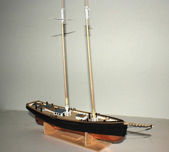

My phantom pilot boat build, I started this a few years ago and never finished it, I would say it’s bout 60%, nice little Model shipways wooden kit. I have a few pics of where I am at so far, all my old pics are long gone, this will be a long build even a small boat like this takes a lot of time if you want a decent result. My first step starting from this point will be to do the copper hull platting. All comments welcome.

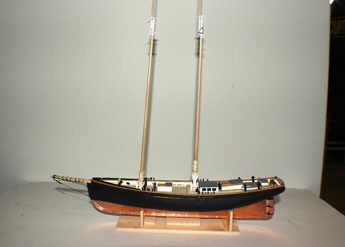

Thanks guys for all the comments, I will be cutting copper plates for the next few days, they will be 1/4 inch long by 1/8 wide, when I start coppering I will post some pics. I will also make the pictures a little bit bigger.
Hi guys time for a small update, I added separate planks to the all roofs and painted them Tamiya light grey, I left some of the wood texture on purpose showing through as I like the wood grain. I have also made the picture just a little bit bigger so you can click on it. All comments welcome.
Time for an update, in the center of the picture I added the 2 black painted pumps and filled the mast hole in, the mast hole was about 1/8 inch to far to the back, I will drill a new hole later. To the right of the pic I added the companion way and the ventilator painted black.
I have started to add a few copper plates but am not happy how they turned out, I will have to remove them as they are to small and difficult for me to handle. I have ordered some new copper plates off ebay, These new plates are 1/96 scale but they appear to be a little larger than the ones I made, I will give those a try, I will post a pic as soon as I install some. All comments welcome.

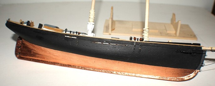

Time for an update. The first pic shows the new copper plate at the top and the old one I made below it, I will be using the new one much bigger and easier to handle and they have the nail head detail on them. The next few pics show the mostly finished bow sprit and some rigging I added, this piece is a small model by itself, I think I counted with the rigging about 45 pieces. All comments welcome.

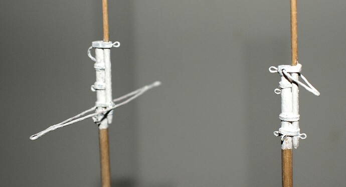

Hi all, way past time for an update, first pic shows the hull has all the copper plates installed from the water line down, I think it went pretty well and I am happy with the results. I have added a few shots showing all the masts installed and most of the fitting for them (the white needs another coat of paint) all the blocks and standing rigging are next, all comments welcome.
