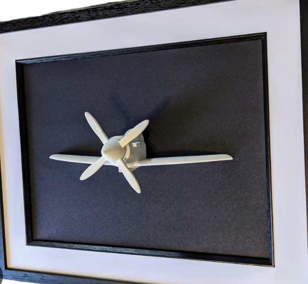

On top of those there is many different angles coming out of a picture frame.

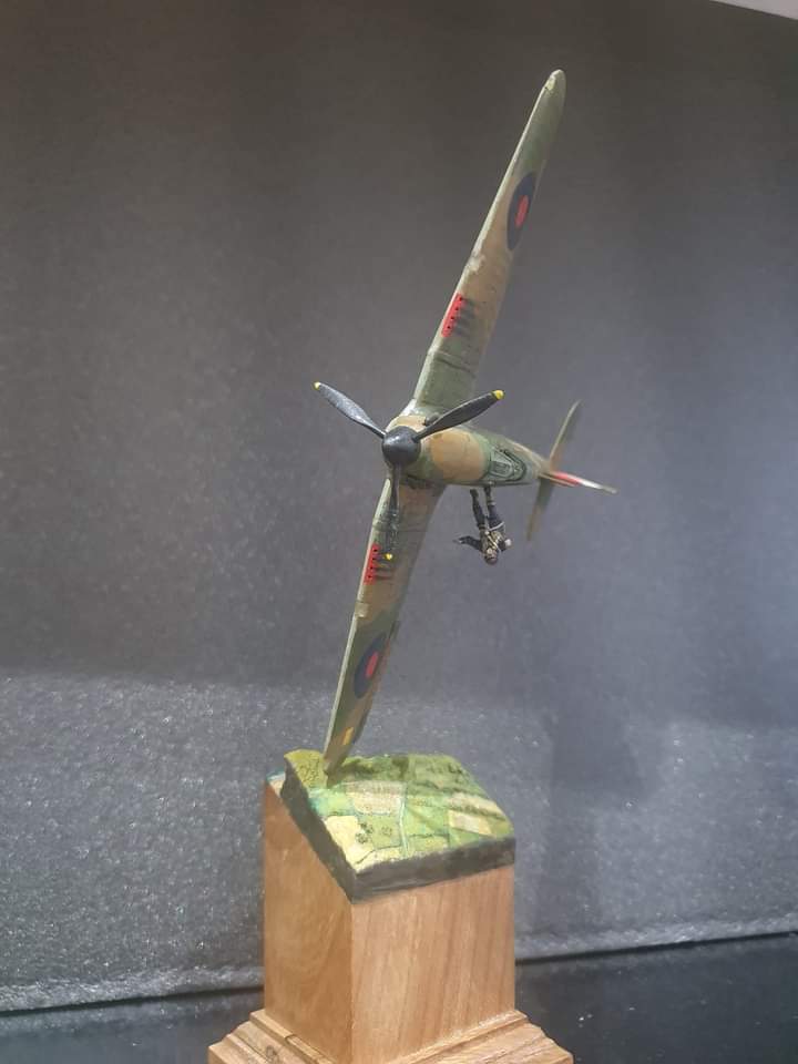

A wing tip barely touching a tree as the aircraft banks around in a tight turn.
Hide a stiff support wire in the wingtip and in the tree.

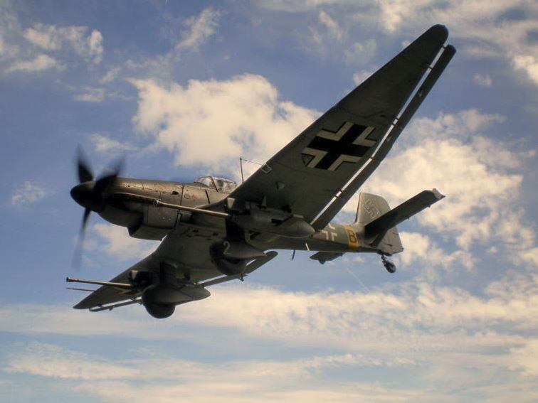

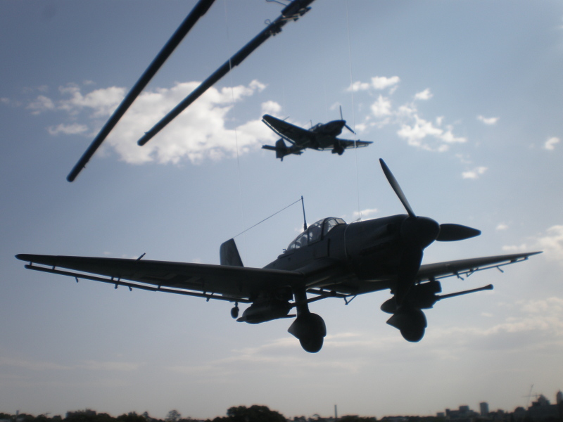

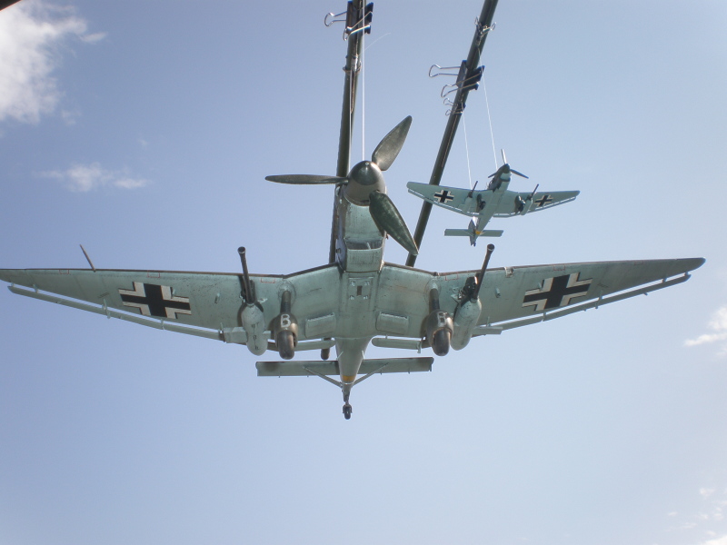

Or you can go this route and not try to hide support - just make it pleasing .
There’s obviously no way of completely concealing support(s), but I still prefer the least obvious. The following were only intended for photographic purposes & not for display (the fishing lines being airbrushed away) but if I ever did want to display the Stukas I’d probably try to find thick Perspex or glass rods to rest across the top of an open-fronted Perspex/glass box, suspending the planes within…
(That’s a Hasegawa 1:32 & a Dragon (?) 1:72) –Mike Koenig (165thspc) did the airbrushing on the last photo)

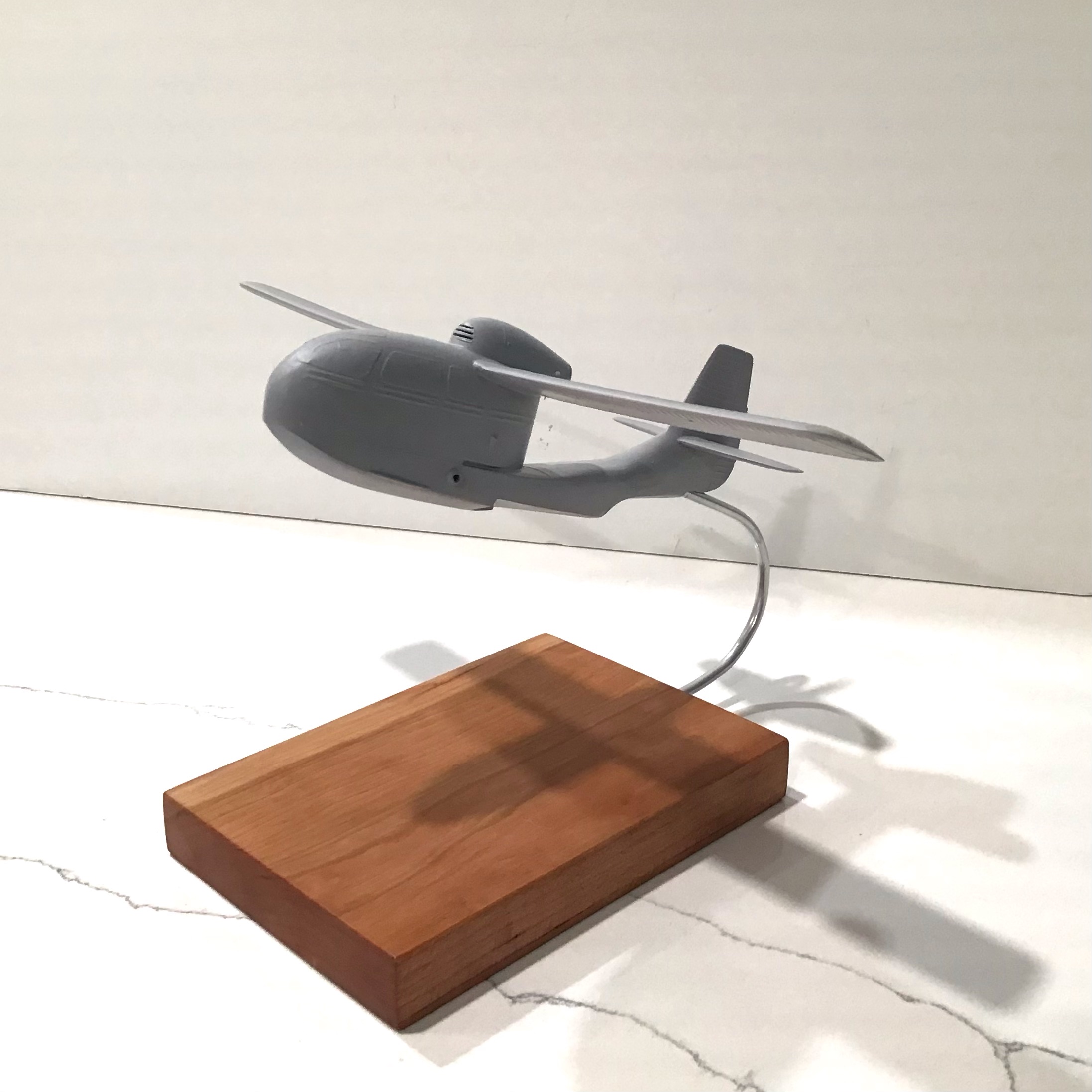

Saw this one just today on the “Art of Modeling” website as done by Phillip Donnelly:

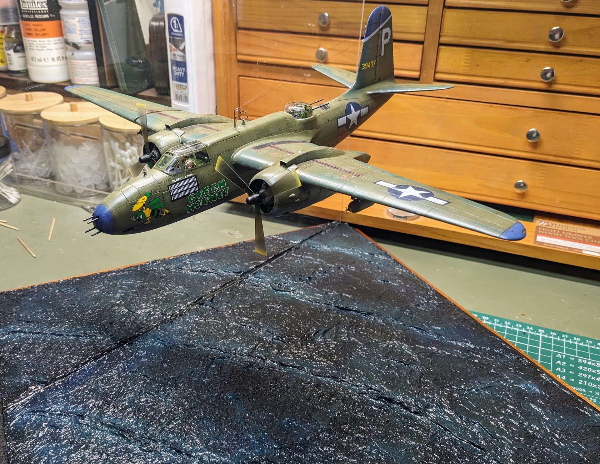

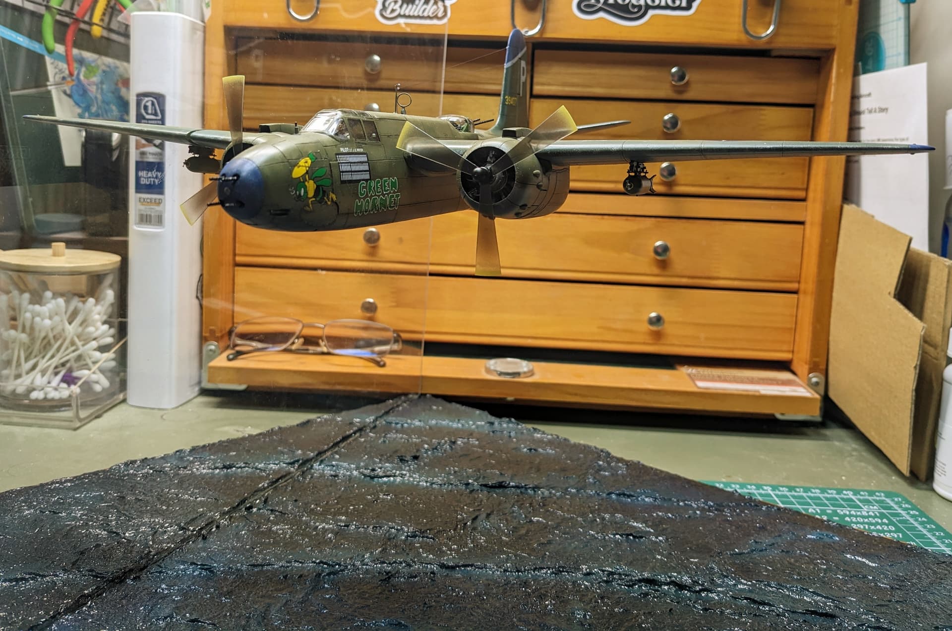

Here’s one I completed back around February. There’s a build article here on the Forum if you’re interested. Basic idea was to mount the aircraft on an acrylic sheet though the wing.
