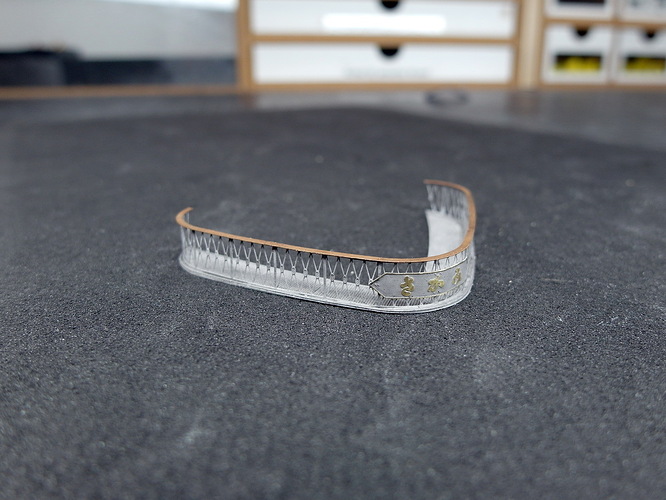

After cleaning the very delicate components, I decided to solder the railing to the upper handrail. To do this, I secured the upper section to a block of wood using a little Micro Liquitape and carefully soldered the railing into the groove, piece by piece.
The second groove was then attached to the gratings, and the two round mounts were also secured with solder.
Assembled, and then everything was given a coat of primer.

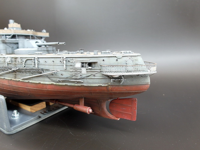

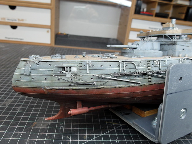

Tacked the gallery to the hull with Blu-Tack to align it properly.
After that, I secured everything properly with acrylic adhesive and attached the struts and the stern anchor. The rudder has also been fitted into its mounts. However, I’ll leave the propulsion system for later.
And with that, the gallery is hanging in its place.
I am very glad that everything worked out well, given that I had made quite a few changes to the hull—such as all the profiles—so I was really worried that something might not fit. But as you can see, it is hanging straight and at the intended height on the stern, exactly where it belongs.
I initially considered replicating the small release mechanism on the stern anchors as well, but ultimately decided against it. I’d like to get this model finished soon, and I’ve already scratch-built plenty of details. That should suffice; otherwise, I’ll start losing interest.
So, I can report that the final components on the outer hull can be considered complete.

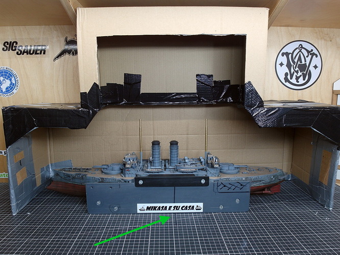

Before I can turn my attention to the masts, I have to attend to a mundane but necessary task.
The model still needs protection against dust, as it will be several weeks before I finish the Mikasa.
Up to now, it has been sitting under a simple, custom-cut cardboard cover. For a project spanning over two years, this is essential.
Now that the masts are to be installed, more vertical clearance is required. So, I got a second piece of cardboard, cut both to size, and joined them together. Everything is held in place and reinforced with duct tape.
Of course, it is important to measure everything precisely beforehand—to avoid any contact between the masts and the cardboard later on. I’ve marked the positions on both the model and the tabletop using a permanent marker. This ensures the model is in the right spot when I slide the dust cover over it.
As you can see in the following picture, the ship’s layout isn’t perfectly symmetrical. That explains the markings and the generous cutout in the cardboard. This way, there shouldn’t be any issues once the masts are fully installed.
And so, I believe the model is well-protected against the looming threat of dust bunnies while it awaits completion.

Unfortunately, the next minor setback wasn’t long in coming. Towards the bow, the cutters and the guy ropes got in each other’s way. So I carefully removed them from the boat decks again. It’s a good thing I rarely use superglue these days.
I’d actually done a lot of test fittings with all sorts of components beforehand. Precisely because I realised I’d made quite a few changes. But as you know: you only find out whether everything actually fits together in the end during the actual building process.
And in this case, the cutter was simply a good bit too far forward. The green arrows show exactly where the boat cradles were originally positioned.
But as we all know, there’s nothing an ambitious model-maker can’t sort out! So, without further ado, I fetched some paint and a wash, painted over the old marks and repositioned the little boat. And lo and behold: it fits perfectly again and the rope runs past it smoothly.
