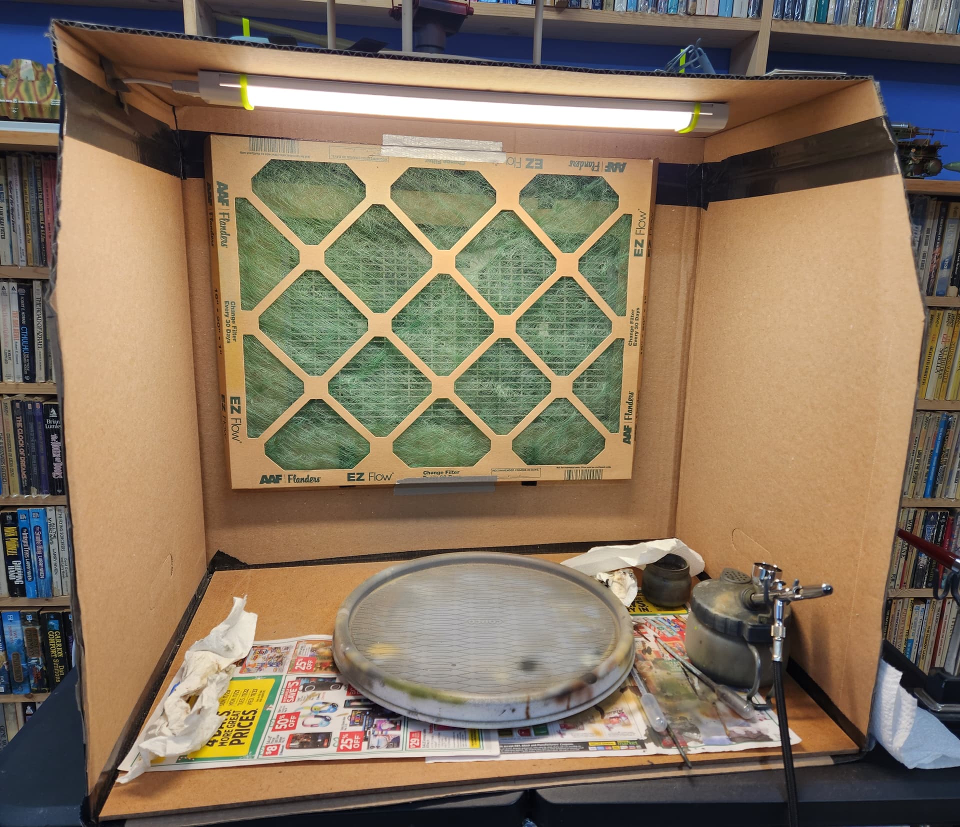

I just built an airbrush booth out of a cardboard box, duct tape, a small window fan, and a length of dryer vent hose so I could move out of the garage for the winter.
I have seen one made from old computer parts and a rectangular section of air-conditioning vent. The guy attached the side cover of the PC to the open end of the vent section. He’d cut out holes and used the PC’s twin fans turned around to suck air out through those. The motherboard and power unit of the old PC was screwed to the outside of the vent section to supply power to the fans and also to the lights he installed. The lights were also from the PC. Only thing he bought was the filter pad and length of pipe to vent the paint out through the window.
