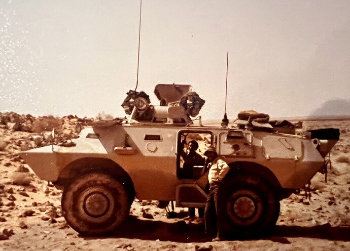

I rode the V150 as an advisor the SANG (Saudi Arabian National Guard) in 1978-1979. My favorite was that with the Oerlikon turret. Blistering good gun!
I have pictures somewhere.

@Ted_Dannemiller - if you find those pictures, please post them here, maybe somebody can use them and it would also be cool to see the differences between V100 and V150 and how Hobby Boss confused then!
Did you know Oerlikon is a suburb of Zurich, Switzerland? They had this factory there where they made guns, but also railroad air brakes, thay are also called Oerlikons, at least here in Europe.
@Pawel_Krasicki
IF you can find the April 1983 copy of SOF (Soldier of Fortune) magazine, you’ll see a few of them. The “author” lifted them from me, unbeknownst to me. I have several pics in a box.
I did not know Oerlikon is a suburb. I should’ve visited a few years back!
I knew that they had a broad portfolio, but not specific about the mobility products. Cool!
@Pawel_Krasicki
I’ll empty a few boxes today!
@Pawel_Krasicki
Dug around. Here you go (multiple posts because of site limitations)
Pics taken in 1978-1979, various place and mostly during training.
@Ted_Dannemiller - thanks a lot for digging those up! Might come very handy for somebody building the V150.
1978-1979 huh? around the time when I was born! :slight_smile:
