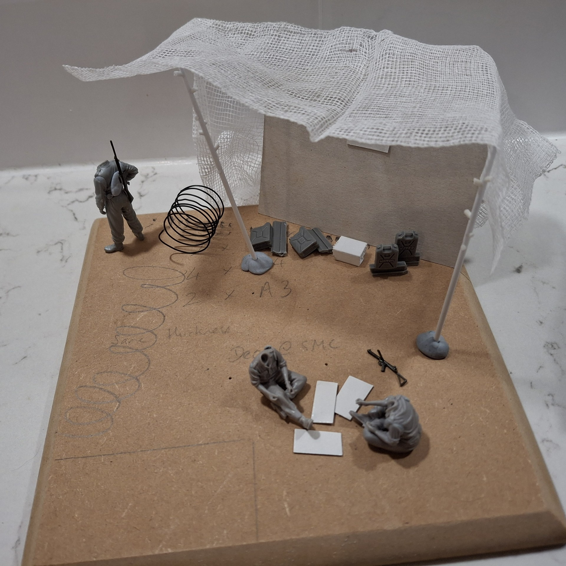

It will be on a small base; this roughly shows the layout:
The figures are I believe, from Firestorm:
They will be modified.
The coil of wire indicates a much more comprehensive defensive set up of barbed wire; I just had to make sure it would all work.
Some of the impedimenta that will be displayed will include jerricans, and perhaps a rolled up unused cam net.
This will all help set the scene for a small dio showing part of a Divisional HQ in the field, as I remember it. This will be, roughly, 1974/75.
Maintaining momentum might be a bit tricky, and getting the cam net taut will be crucial, although I have a cunning plan(!)

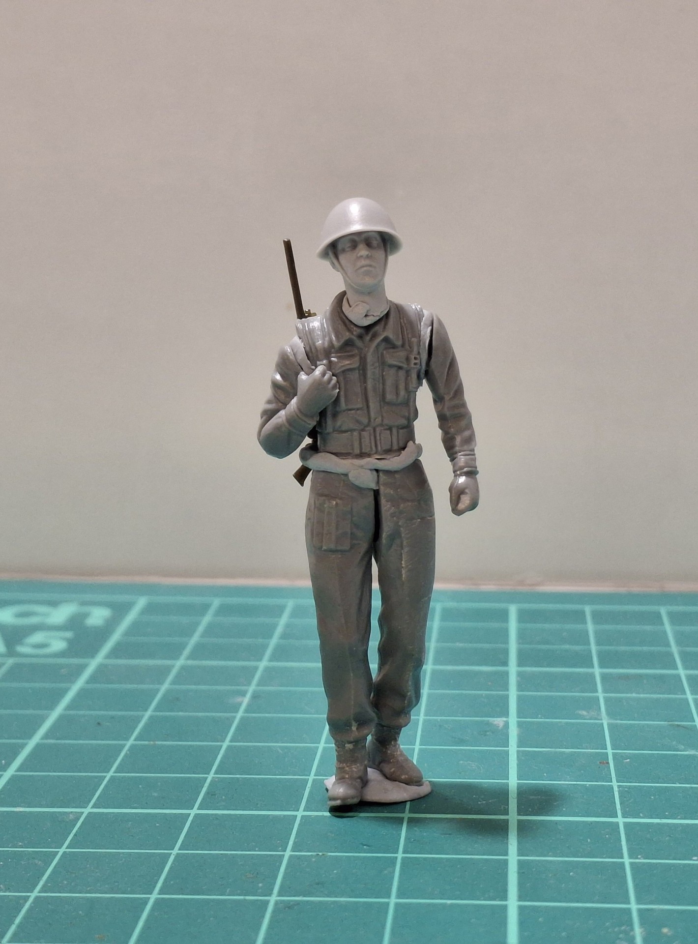

I suspect the most difficult aspects of this project will be the cam net, and the Sentry figure, so I think I’ll start with these first.
Div HQ - as indeed at all deployable HQs - has some type of defence unit (depending on the size of the HQ - Corps I think, had a battalion assigned to it); anyway, back in the day we had a Platoon from the Royal Pioneer Corps, who, in addition to their dedicated labour-role, often involving the malodourous, provided security; they were responsible for setting up the wire around the HQ, and then controlling access and providing a sentry.

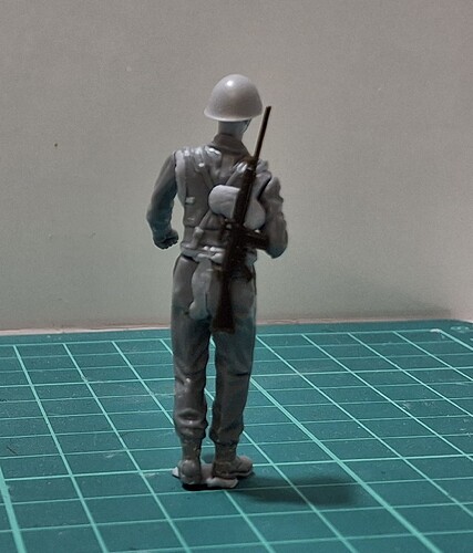

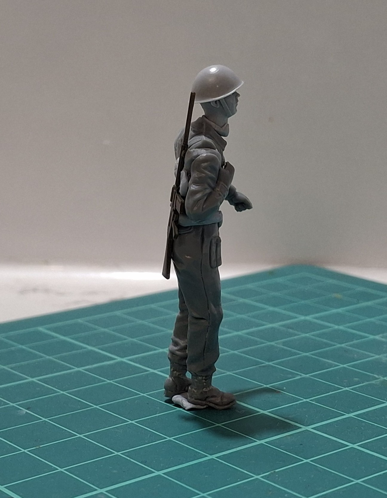

I selected a figure from Tamiya’s pretty well-detailed WW2 set:
Most of the detail will, however, have to sanded off; here’s the figure temporarily positioned with Blu-Tak just to scope the art of the possible. I’ve added a Hornet Head and an Italeri rifle:
So, all I have to do is just about remove all the detail with extended sanding, and replace with card (pockets), Magic-Sculp (Combat Smock), fashioning along the way ‘58 pat CEFO, SR6 respirator case (more Magic-Sculp) scrim up the helmet, add slings and straps (probably lead foil) as necessary, and replace the anklets with puttees. Piece of cake!

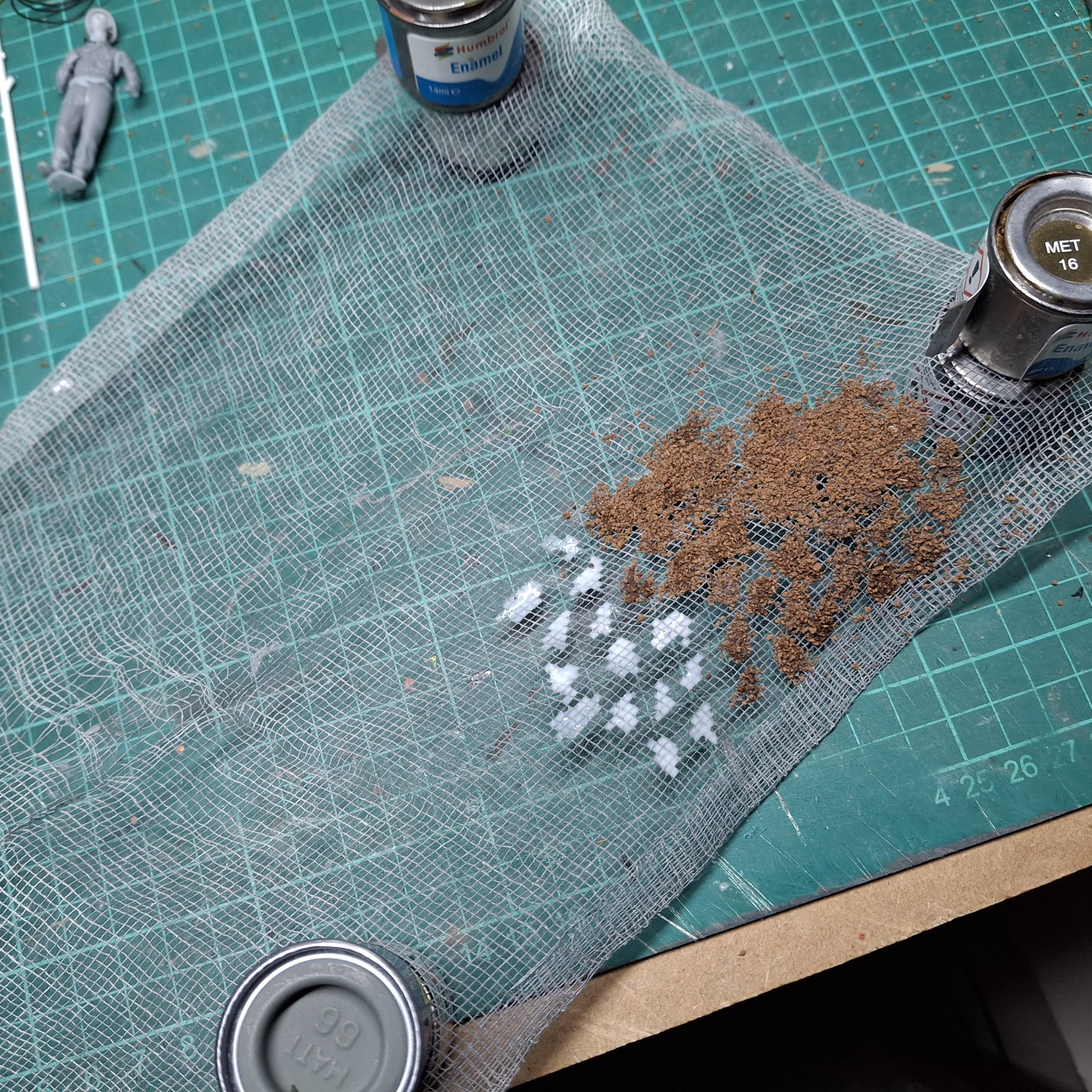

As it happened, I decided to tackle the net problem first. This was my cunning plan - I still do not know at the time of writing this - if it will work.

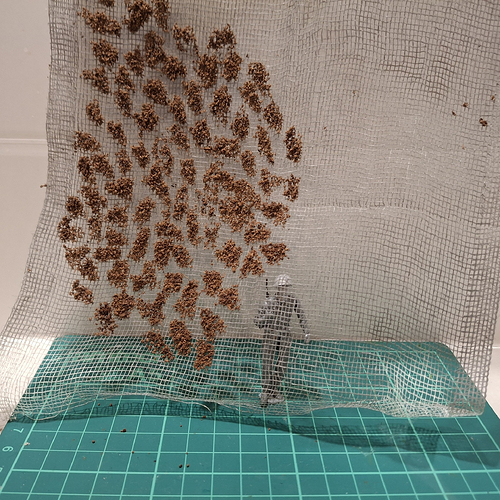

I was going to spray on the gauze bandage I’d selected, a mix of diluted PVA glue, using one of those spray bottles one can buy. Then I thought, why not use spray starch? All I want is a little bit of rigidity and I’ll be good to go, so that’s what I did. It ended up not being especially rigid, but I then sprayed it with a quick blast of primer (rattle can stuff from a car accessory shop). This seemed to work, more or less, though gently does it is the by-word.
Mixing up a not too sloppy mix of PVA glue, I then applied patches where I wanted the plastic scrim (on the real thing) to be. In the Brit Army these (used to) come in roughly triangular patches, green one side and brown the other. Try as I might, I couldn’t get the PVA mix to conform to that shape, so had no real choice other than to apply the best I could. The problem I decided was that the mesh is just too large and the strands not fine enough in 1/35, but to be honest, I don’t think there’s much of another option for deployed cam nets. I let the PVA dry off a bit and then sprinkled over used tea leaves, as I do whenever I use draped cam on AFVs and the like. I haven’t blown away the excess just yet, and will let it all dry a little longer.
If it works, I should be able to wrestle it into the draped cam on poles effect require for this dio.
Fingers crossed folks! If I can keep awake I’ll report back later.
Well, whaddya know? An effect at least; not perfect but I can live with that I think:

Troop Trials far from complete but I reckon I’m just about there.
I’m quite chuffed actually(!)

Brian that cam net is looking good! What are you using to tie it down?
Only nit pick is with the figure. You may need to tweak a bit. If he’s supposed to be Pioneer Corps then he needs an extra 30kgs or so, mainly around the stomach. He’ll also need a new head. One shaped like, and the size of, a pumpkin. He also has to have a nose that looks like it’s been broken weekly since they joined up!
Well, it’s going be a fragile beast (the net not the pioneer) so careful positioning I should think 2x poles to prop up and possibly some pegs to make it taut enough or the illusion thereof.
