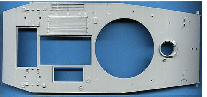

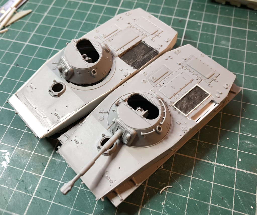

No, they definitely made two different hulls. This is the part included with 00379 and 00380:
It is generally acceptable for an early hull.

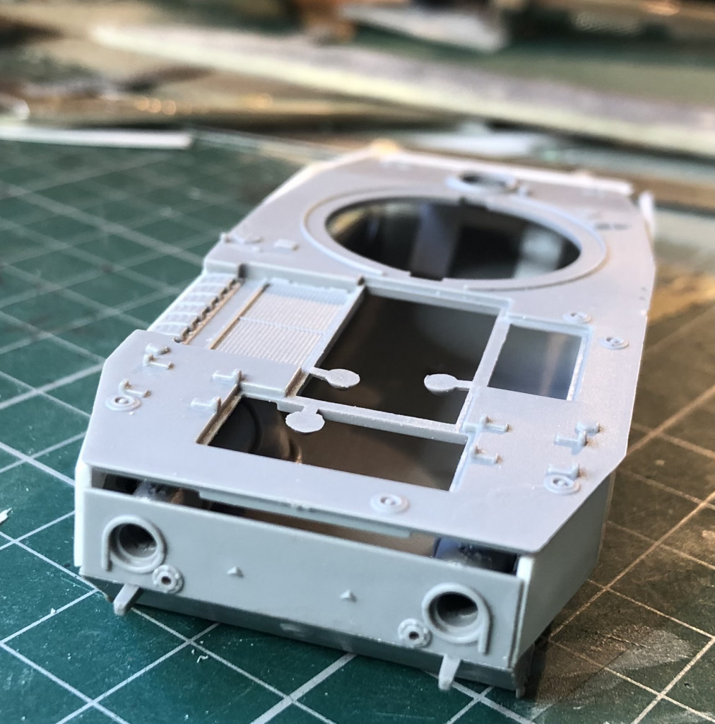

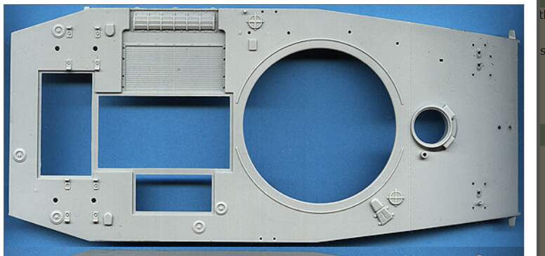

And this is the one included with 00381 and 00382:
I sold mine and can’t remember the specifics but as I recall it is the height of the intermediate hull but it includes the recessed engine compartment of the late hull.

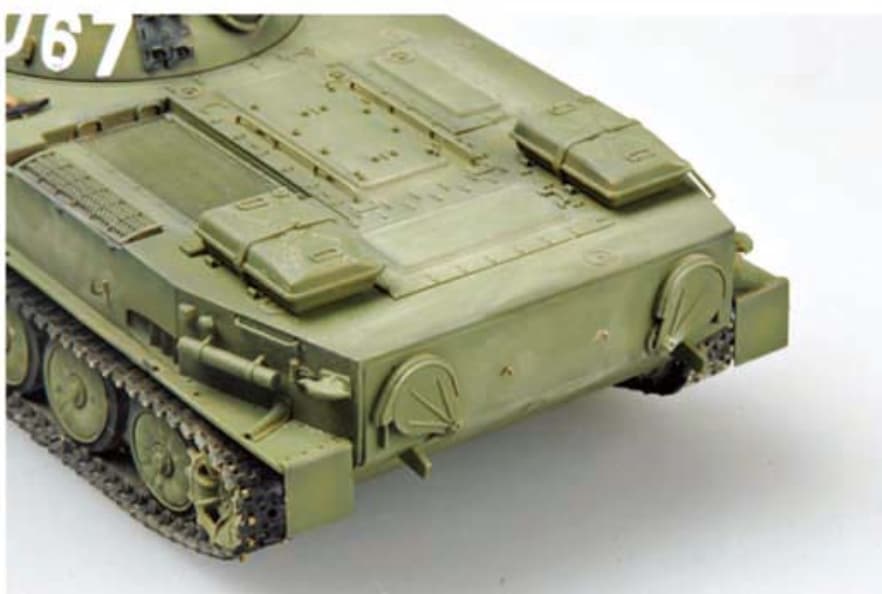

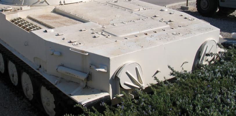

Compare that to what the tail of a late hull with the deeply recessed engine compartment looks like:
KL
Revell copied the exact same problem with their PT 76B hull, you can raise the engine compartment with surgery to get a mid hull
Hi Kurt,
judging from my references, Trumpeter did the hulls right. You can see it from the position of the “bend” relative to the hatch. “Early” hulls have the bend tru the hatch opening, while on “late” hulls the “bend” sits above the hatch.
Hull, singular. The early hull with 00379 and 00380 is correct. The hull in the other kits is not because it mixes intermediate and late features.
KL

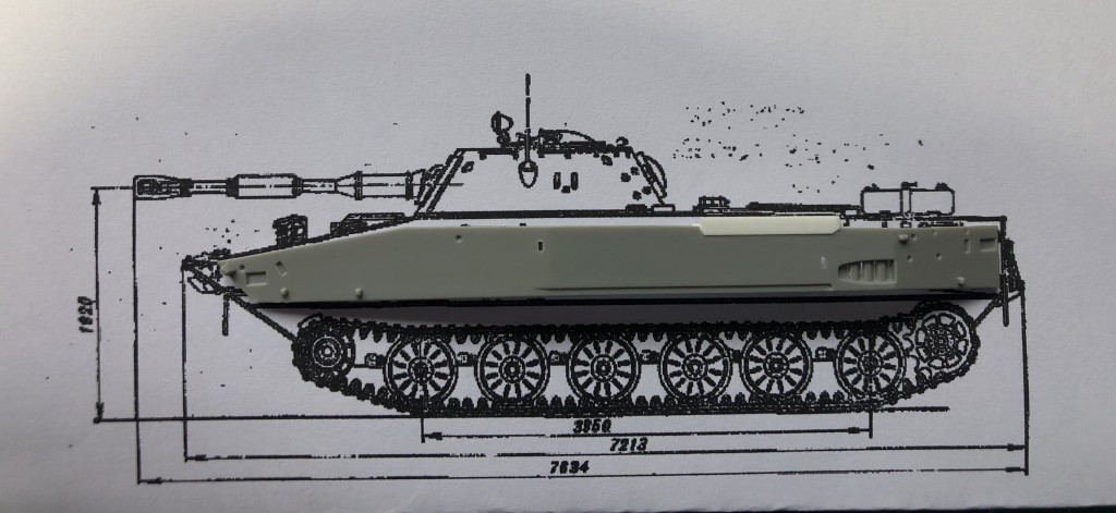

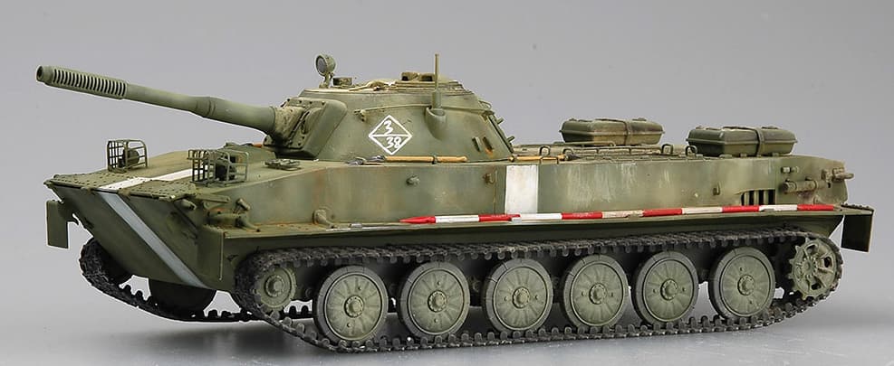

I think I will build this particular PT-76.
PT-76 B_01
PT-76 B_23
Which base kit would be recommended?
Well, none of them. That’s a late hull. Trumpeter’s kits are only good for early hulls and, perhaps, conversion to an intermediate hull. A late hull like requires a significant amount of modification work.
If you see a notch cut into the left side of the hull:
Screenshot 2024-05-24 194337
It is a late hull.
KL

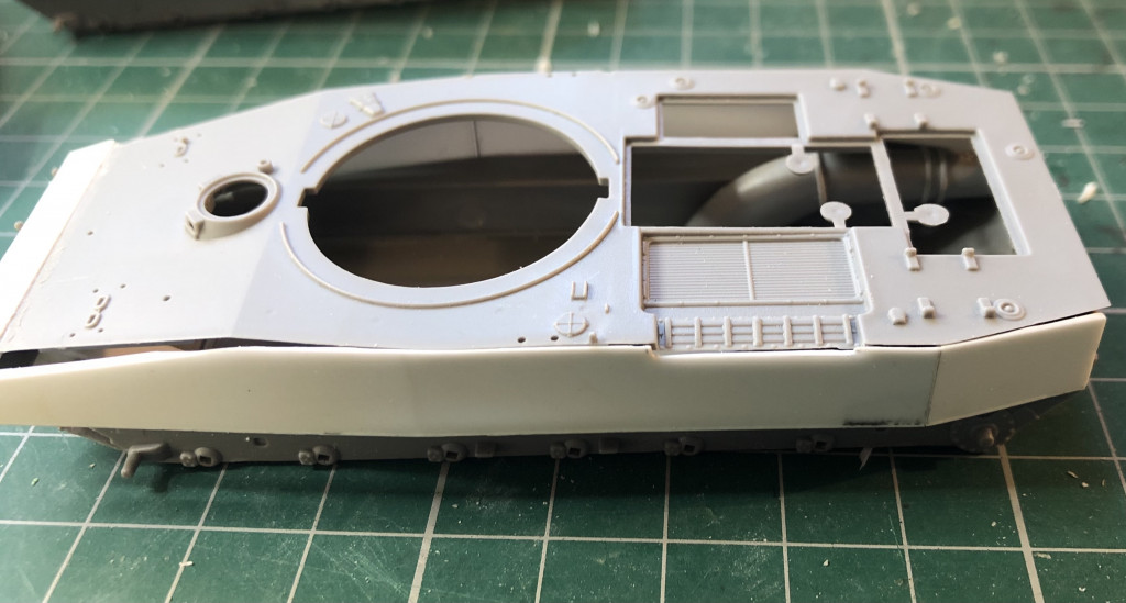

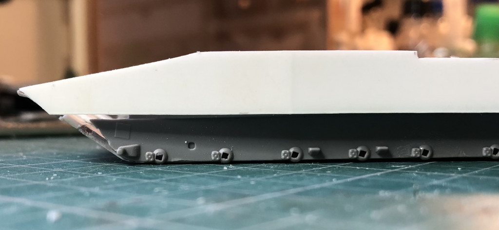

Although I only do 1/72, the Revell PT 76B is an exact copy of the trumpeter kit (only smaller) the intermediate hull is the easiest to do
Fill the notch on the side cut out the engine and raise it up.
The late hull is more difficult
Requires completely new sides, although I have seen it attempted by cutting the sides horizontally and adding a strip! You can also see how much needs adding to the upper glacis.
The lower hull also requires surgery as the lower glacis is now at a new angle
The rear will also require adding to.
A conversion to the intermediate hull is the easiest option, plus they are quite common unless you are modelling a specific vehicle.

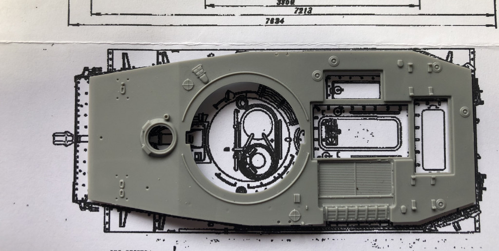

Add to the woes, not all plans are created equal either, a lot of PT 76 plans are just either a plain PT 76 or an intermediate hull altered to show details, I did find one set of Russian source for a late hull and sized them to the kit,(which happily turned out the correct scale anyway)
Tankograd book hold a 1/35 scale 5-side drawing that looks convincing. But before I get into PT-76 I need to takle my BTR-50 indy link tracks.
