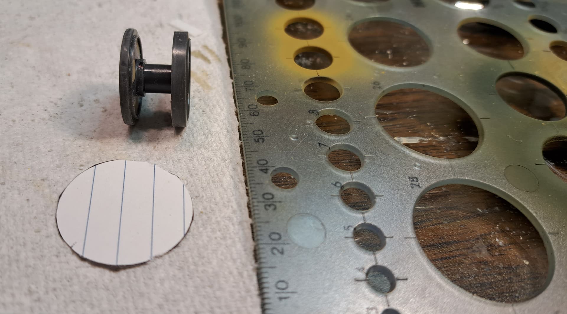

The kit wheel assembly.
It’s OK except there should be three wheels instead of two. The big wheel is roughly a double thick single wheel. It should be two wheels.
Here’s an an example from the web of what the wheels should look like. Three per assembly.
TAG120018.1_300x300

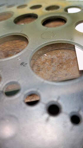

Kali Kat & I concocted a scheme to modify the kit wheel to simulate three wheels.
Needed to cut a groove in the middle of the fat tire to help give the impression it was two tires. The circle template with a card stock spacer would place a razor saw in approximately the middle of the tire. The spacer could float but would be trapped under the beveled edge of the circle template if the template was placed accordingly.
The groove jig…
The kit wheel after four revolutions in the jig, sanding, hand scribing to widen groove and Testor’s Liquid Cement.

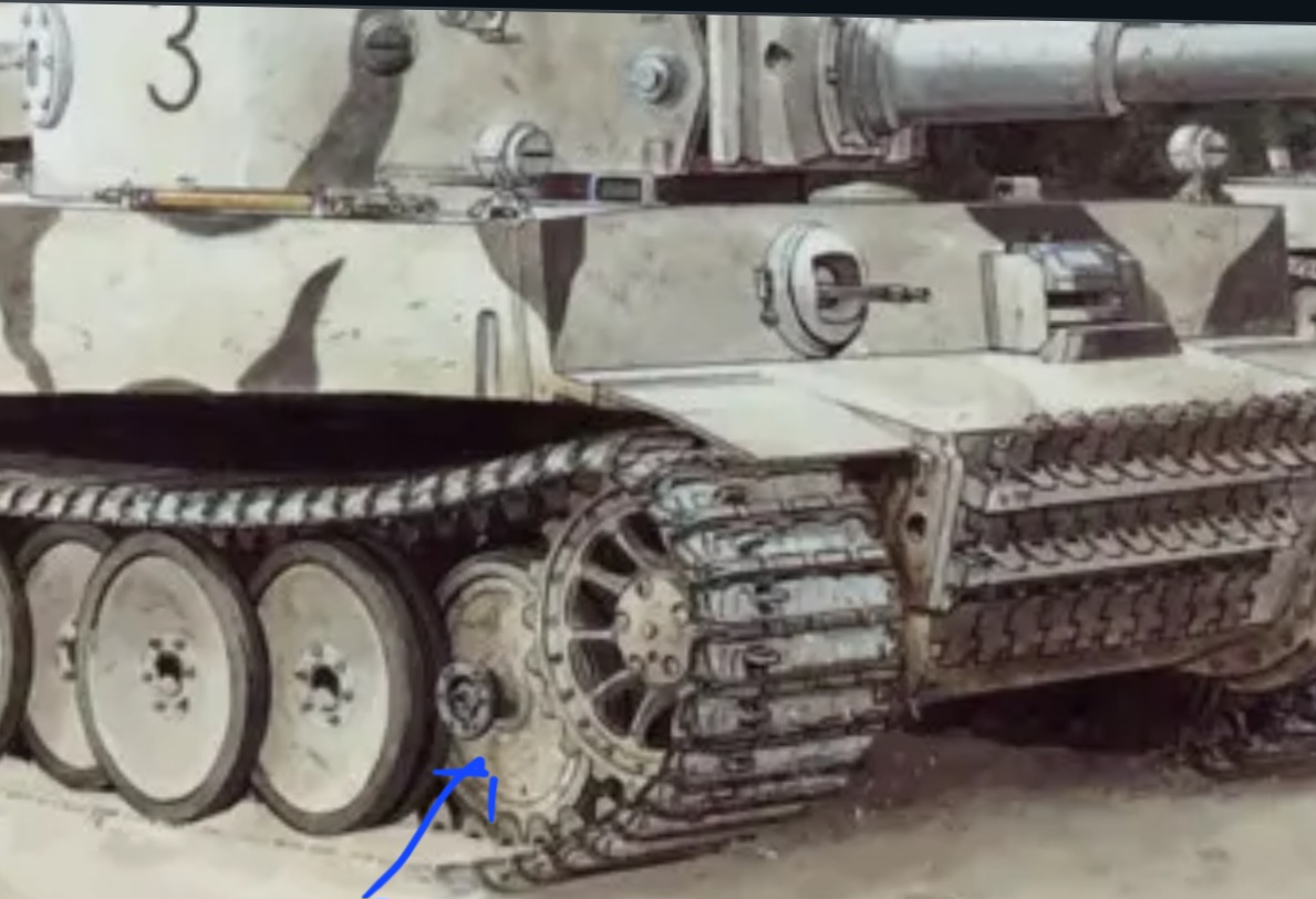

Goal is to have the first road wheel station per Dragon’s box art for their Leningrad 502 Tiger.
I think the kit already comes with those parts (pointed with blue arrow - B16).
If you do not have the parts; I have them (off my “Tiger 131” build) that i can happily mail to you… If you need them.
