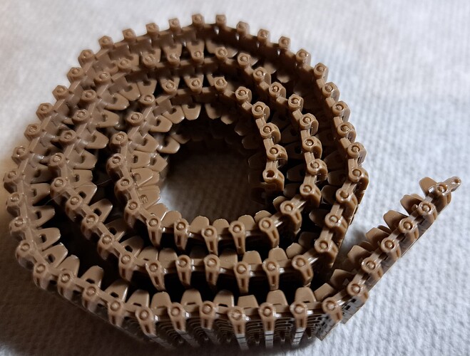

Working on tracks…I belive 96 was the magic number for a real Tiger. I’ll build two runs of 95 and add extra link(s) as needed when test fitting tracks to the model. Have ~85 assembled for one run…

Halfway there, I think 9 hours one track.
Pretty impressive with the quality engineering & design. This is the only set of injection molded plastic tracks, I’ve seen that flow and move like high quality 3D printed or white metal.
However, they are fragile, just check out how little of that pin circled in blue on the left can engage with the arttached link.
To the second track…

Finally both tracks are done!
Total time: 14 hours & 32 minutes.
My time likely would have been about 18 hours without the Zoukei-Mura & GodHand nippers. The sharp point on ZM’s proved superb nipping parts but especially small track pins on assembled tracks. I couldn’t do that with the blunt nose GodHand’s. Nipping the nubs on the guide teeth after cemented to the tracks for me the GodHand’s were invaluable for fine trimming.
None of the links bind or cemented together. In part due to care in assembly but also due to outstanding design. Only two track pins were lost in assembly of 960 parts. Usually, 5 to 15 fly away/tweezer lanch but due to good engineering that just didn’t happen with this track set.
Easily the most amazing injection molded plastic tracks I’ve assembled.

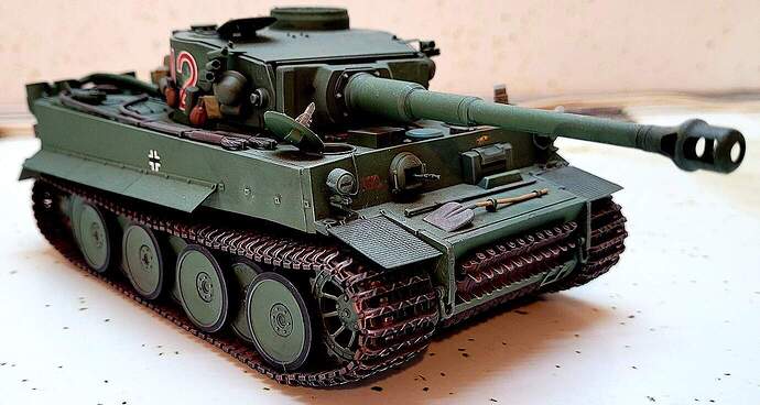

Thanks to my youngest sister who rescued it, I still have my 1/25 Tiger that I bought at the PX in Ft Leavenworth in 1971-72. Got repainted in the early 90s.
Now covered in cobwebs on top of a bookcase.
And this is a kick ass build you’ve got going Wade.

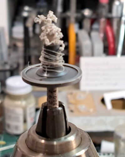

Set the razor saw jig up again and cut rhe other seven wheels. Did all eight outer sets so I can pick the best six sets. ModelKasten wheels will replace the front pairs.
The rough cut grooves. Worked over with back of an Xacto blade to clear debris from groove and make sure the grove tracks correctly. Follow with widening grove with scriber.
The process was smooth as butter after working on tracks the last few days.
I think that will have to do for simulating three wheels.

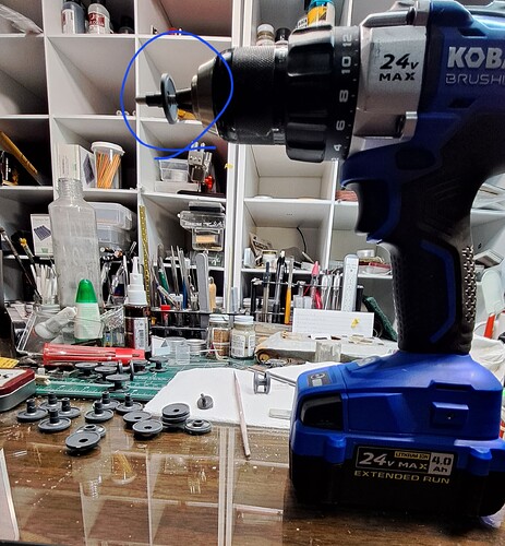

Wow! The kit outer wheel for the other set is too FAT, compared to my grooved wheels!
Plan A
Zero issue, will chuck it in the drill and cut it down to size. Oops, the spindle is too big for my MiniCraft drill even with an adapter (old paint brush handle).
Defeat
Plan B
Zero issue, will chuck it in the MiniCraft lath with the big drill and cut it down to size. Oops, the spindle is too big this one as well even with an adapter (old paint brush handle).
Defeat
Rinse-repeat etc…
Defeat
Plan Z - Go Nuclear
Winner!
Blue points to wheels that was shaved down,to make thinner. Red points to the shaver. Wheel needs to be ~2mm thick so ~.5mm or so has to go.
Seven wheels remaining to thin and eight to groove
