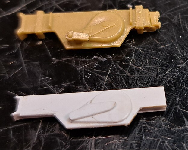

Continuing with the rear details, took a look at the kit jack (right/gray) and what was in the spare part box (tan).
I may steal the 1989 Late Tiger’s jack and replace the 1989 kit part with a Mig 3D printed one so the kit doesn’t turn into a fat box of spare parts. However, given the campaign, I think due diligence requires an attempt…
Sheet styrene to approximate size.
Sheet styrene plus C-channel styrene parts.
Filled, sanded plus “dog leg” snipped from .010 sheet with GodHand nippers then sanded.
Waldon punch & die set for the three large discs.
Four smaller round bits are needed. Grandtline hex bolts were used on the exhaust. I like to leave the shank on the sprue because it’s easy to make small bits with the #11 blade. Bits marked with red.
Added four fiddle bits. Took C-channel and spread sides to make end of jack. Additional six bits added to perimeter of jack.

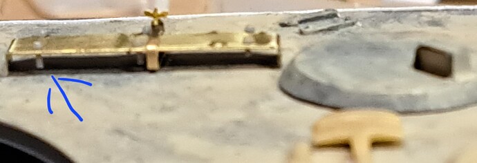

Surprisingly, OTM missed this detail. PE would have been ideal for this detail. Time to cobble up a custom artistic licensed fiddle bit.
OTM PE wing nuts, a PE rectangle cut in half from random PE fret, and styrene rod.
I taped over the PE rectangle before cutting it in half. That prevented either half from launching into oblivion. Glue together parts and install.
Yes, the scratch wing nut fiddle bits are slightly out of position. Left one tweezer lauched to the current spot. Decided to go with and attached other one accordingly. Sometimes that’s the calculated risk with CA on a small part in Wade’s World.
