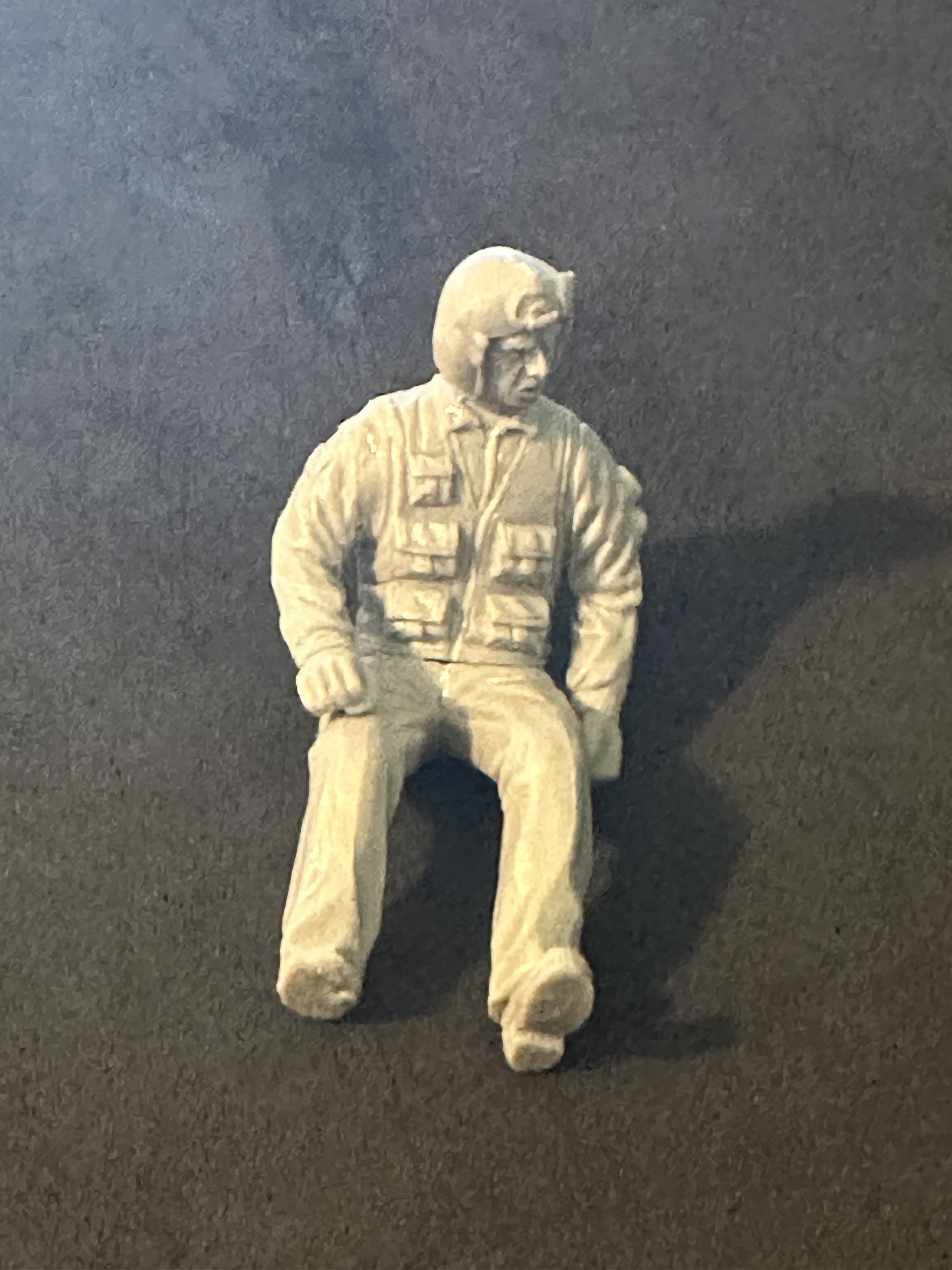

Been out of the hobby for years , getting back in , just tried puttying a figure with tamiya grey putty , not happy with it , any better suggestions? water soluable?

fill the cracks and seams where the main joints meet, how do you get into those very small and fine seems?
If they are very fine joints I thin out the putty with Tamiya’s Xtra-thin glue, then use an old fine brush to apply the mix into place. Don’t slop it all over!

My solution for years has been to shave off pieces of the sprue the figures came from, and stuff the shavings into the joint, then apply liquid cement. I then press it in and shape it with the tip of a blade. I think it was a bout a year ago I heard that others call this “sprue goo” although they mix it and then apply it. I prefer stuffing the shaving into the seams first. Since I’m using the same colored styrene the fix is virtually invisible.
I did it with this guy for instance, after turning his head:
Why is this better than putty? I like this method because after it cures you can easily trim it and blend it with an X-Acto without worrying about it chipping and flaking. It also doesn’t shrink.
