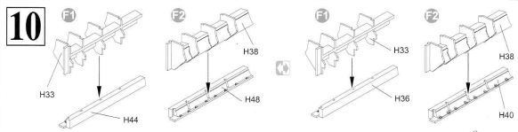

hi, what difference is between this two parts of air intake H44/48 and H36/40?:
are those differences connected with tank producer/time of assembly? its quite hard to see this on old photos…
Are these Panzer IV air intakes? That’s what they look like. The difference seems to be louvres open / louvres closed.
Have you looked at the actual plastic parts to see if there is a difference? I know Dragon instructions are notorious for having errors. I don’t know this kit but IMO it looks like a printing error in the instructions.

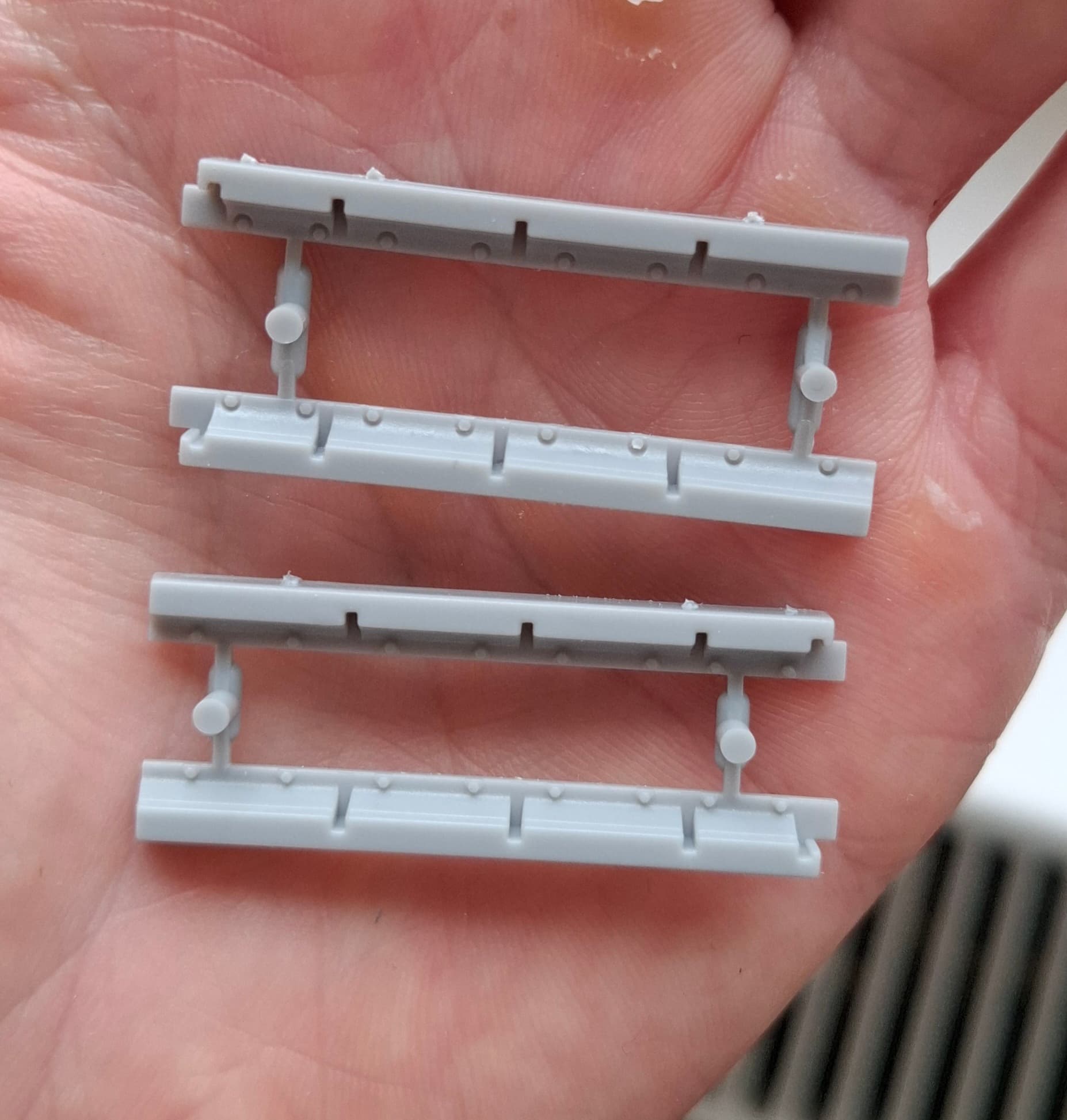

Parts H44/H48 have a different bolt pattern than H36/H40. One is slightly recessed; the other flush with the surface.
Which goes with which is your guess; not Dragon’s.
Here they are:
Are those differences connected with producer or period of vehicles assembly ?
Could be either, but I don’t have any resources that detailed. If it was a Stug, I could probably tell you. I have a great book for that.
The same situation is with stug iv früh (dragon 6520) so… :smiley: if You have any informations about this it would be great!
