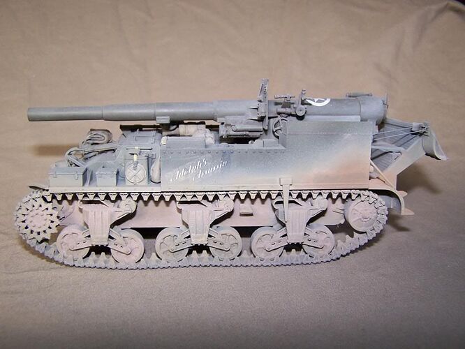

I built that kit many years back. I think that I used the heated screwdriver method, but don’t remember for sure. I’m pretty sure that the M12 kit had a bit of slack on the tracks

Nice work.
