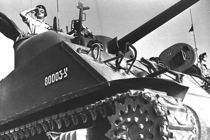

In the early days they used pretty much any Sherman that they could get ahold of

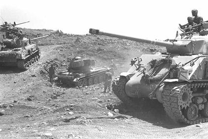

This M50 looks to use the hull from either an M4A3 or M4 105mm

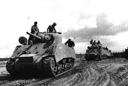

These two are using large hatch M4A3 hulls, but one curiously has an old M34 narrow
mantlet
Most of the earliest Shermans the IDF had were based on M4/105s. They got a lot of them with demilitarized 105 guns and fitted them with 75mm guns scrounged from all over. If you see top views of them you can see from the fit out they are 105 turrets.
But after the initial reluctance to sell them arms past they did purchase almost any Sherman they could get, so M4A3 76 mm would have been used. It’s just that most of the tanks they got were from countries that didn’t receive many and had mostly M4A1 and M4A4 which were more common in lend lease.
