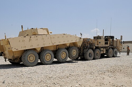

Is it possible to recover stryker in the same way what KTO Rosomar on the picture?

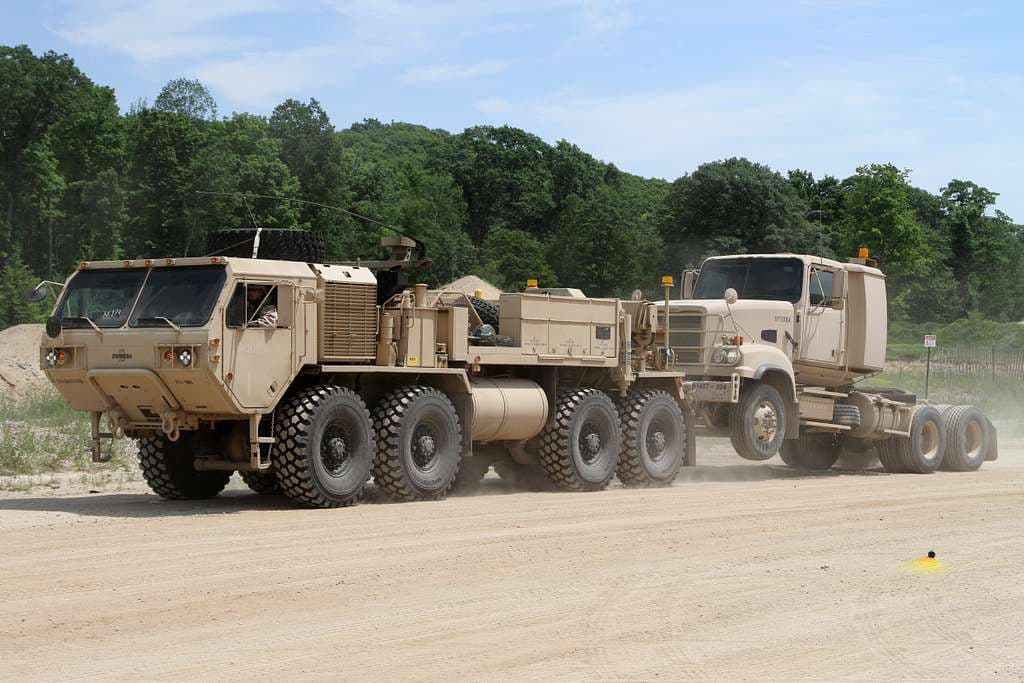

Yes, Strykers have basically the same tow points on the front and can be recovered in the same way.
The M984 HEMTT Wrecker can recover any vehicle with front tow point in that manner.
Some examples: of course I can’t find one of a Stryker.

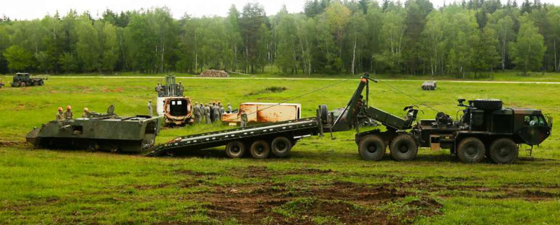

Negative, Ghost Rider.There’s a reason you can’t find any photos. They likely don’t exist.You can pull a Stryker by the front lugs, but towing by lifting is the front end is definitely a no-no. You could do it in an emergency situation, but lifting the front end will damage the rear suspension units. There’s a special system for it (which I happened to have photographed at Fort Sill) for recovering the Stryker - the Stryker Modular Catastrophic Recovery System .
Rob, this one?
In action

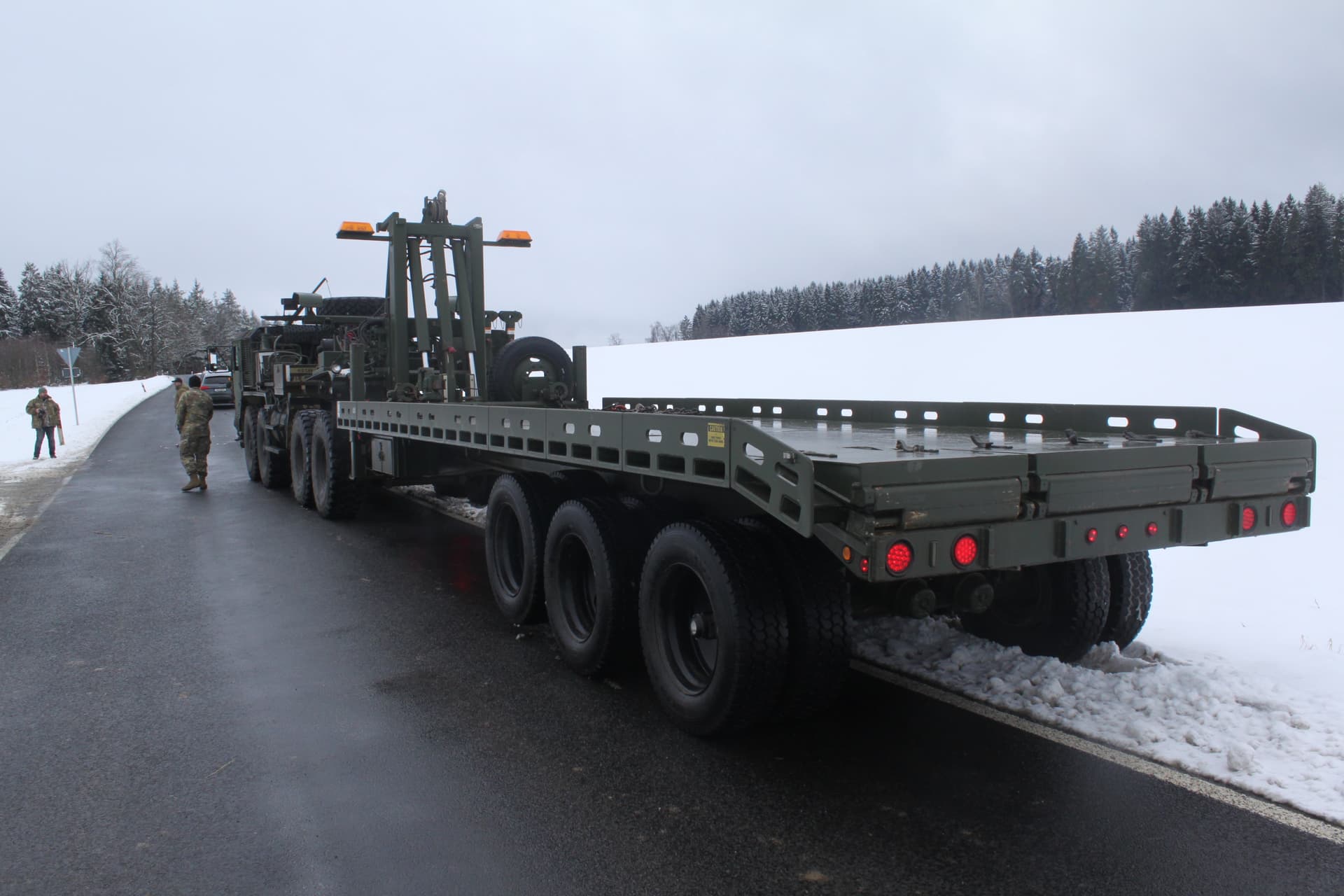

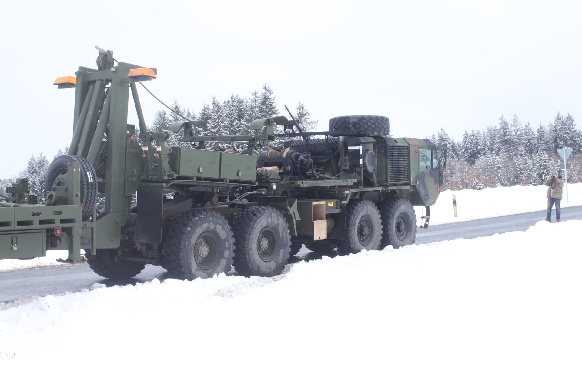

From the manufacturer (Tru-Hitch Inc) brochure

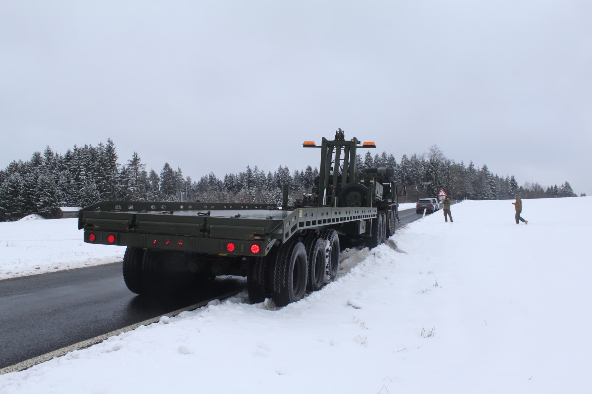

The top picture comes from the DVIDS website :
https://www.dvidshub.net/image/5533702/us-army-europe-aims-fulfill-h8-shortage

I have seen the trailer/system. I didn’t realize it was specifically designed for Strykers.
I was taught that this is the SRS (Stryker Recovery System). I never got to use one but have seen them running around.
