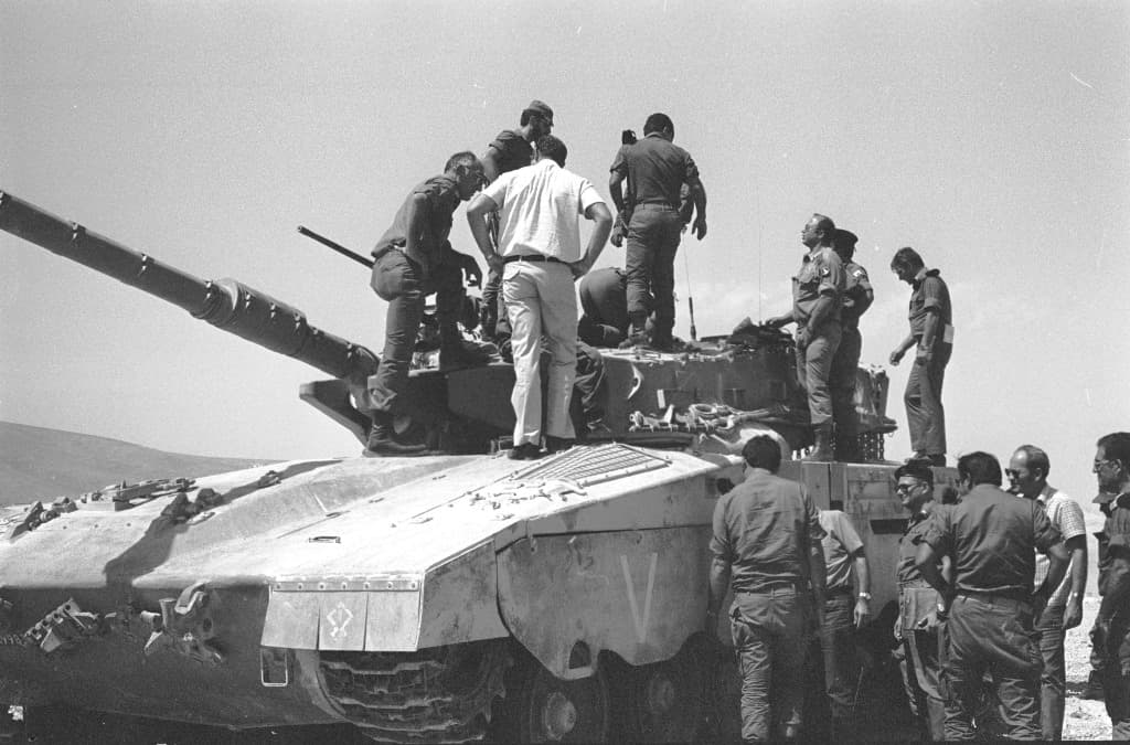

I believe the following photo is of officers of Brigade 211 inspecting one of their first Merkavas. There is a non-zero chance my grandpa is somewhere in the photo.
The Merkava Siman 1 has thin metal side-skirts, in Hebrew called Bazooka Plates. Like all mark 1s it has the basic rear turret storage basket, with the notable rounded corners.

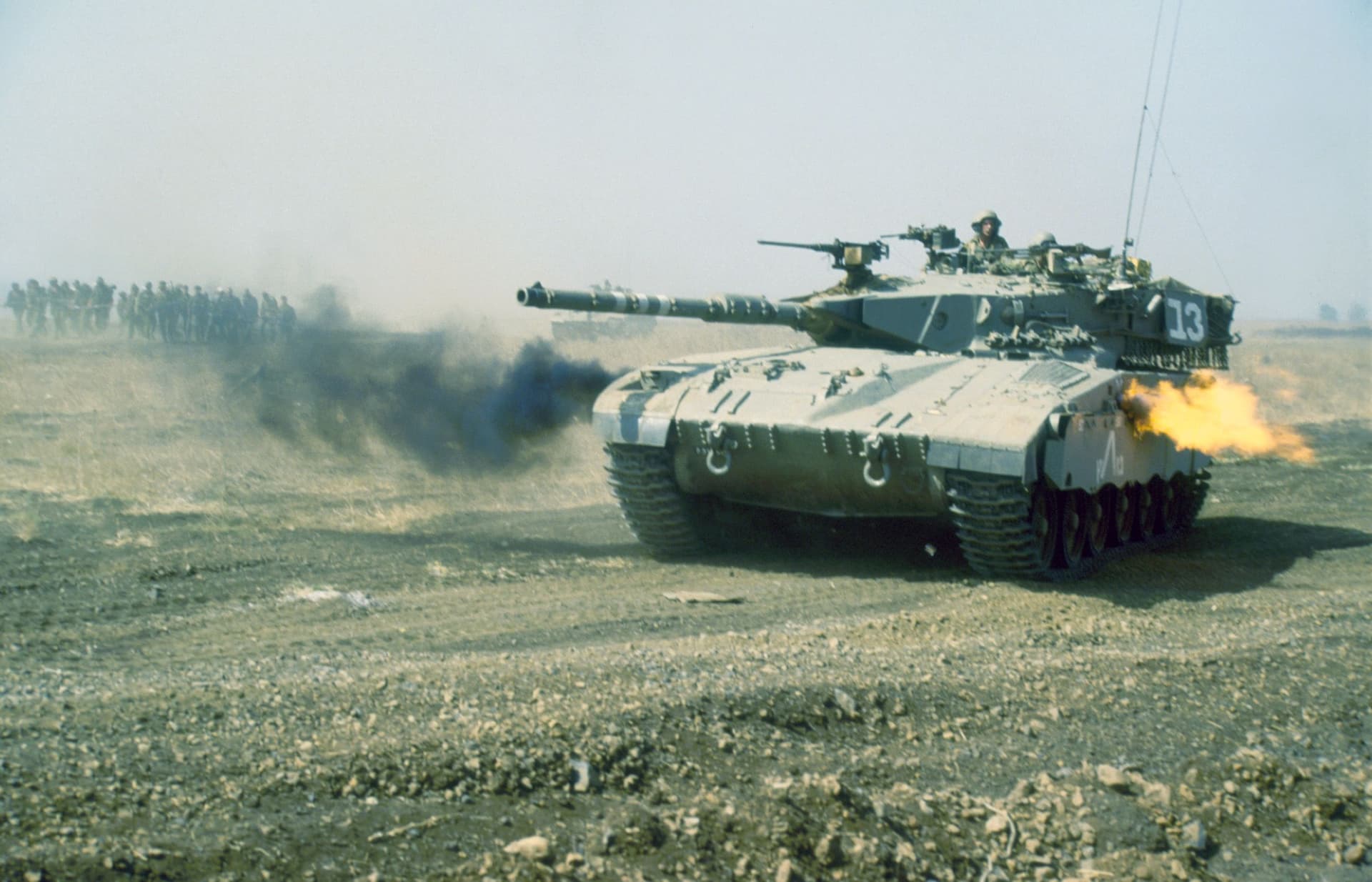

Merkava Siman 2 Alef, of Brigade 7, Battalion 75 “Romach”, “Machatz” company. I believe during an exercise in 1986.

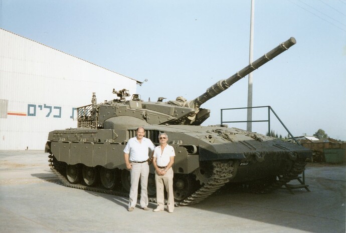

Merkava Siman 2 Bet serial number 815837 fresh off the production line sometime in the 1980s.

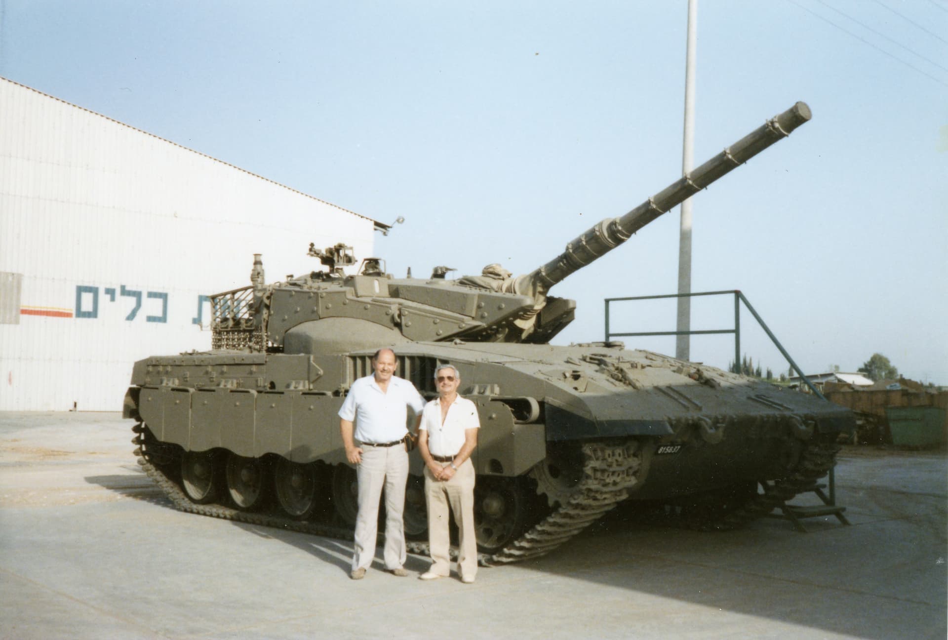

The exact same tank, 815837 as spotted by a friend of mine… Somewhere, not too long ago.

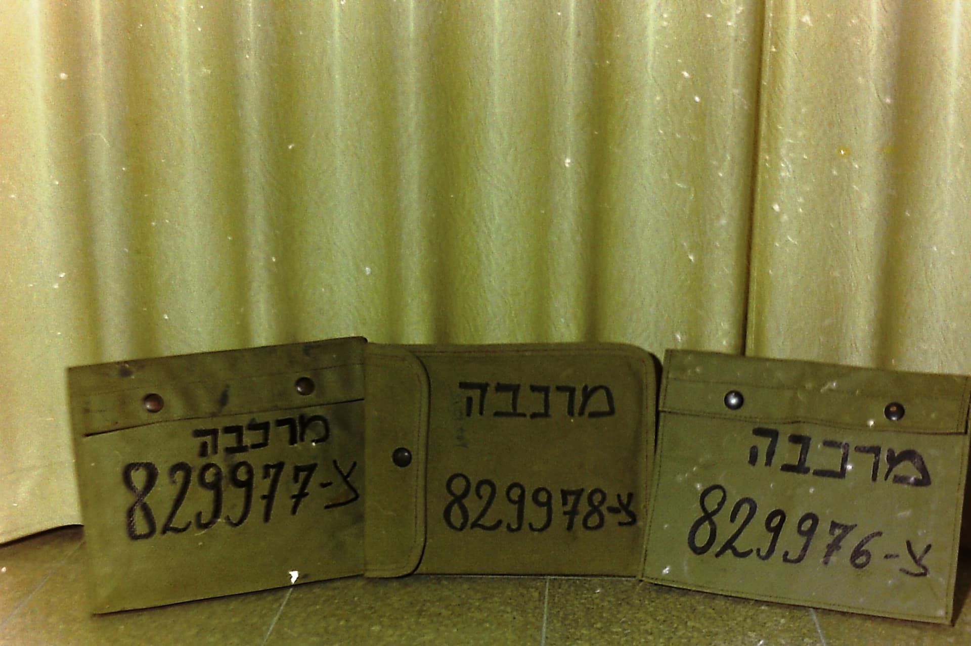

Flag kits for tanks serial numbers 829976, 829977, and 829978 photographed when serial production and transferral of the first Merkava Siman 3s to the IDF Armored Corps on the 16th of May 1990.
