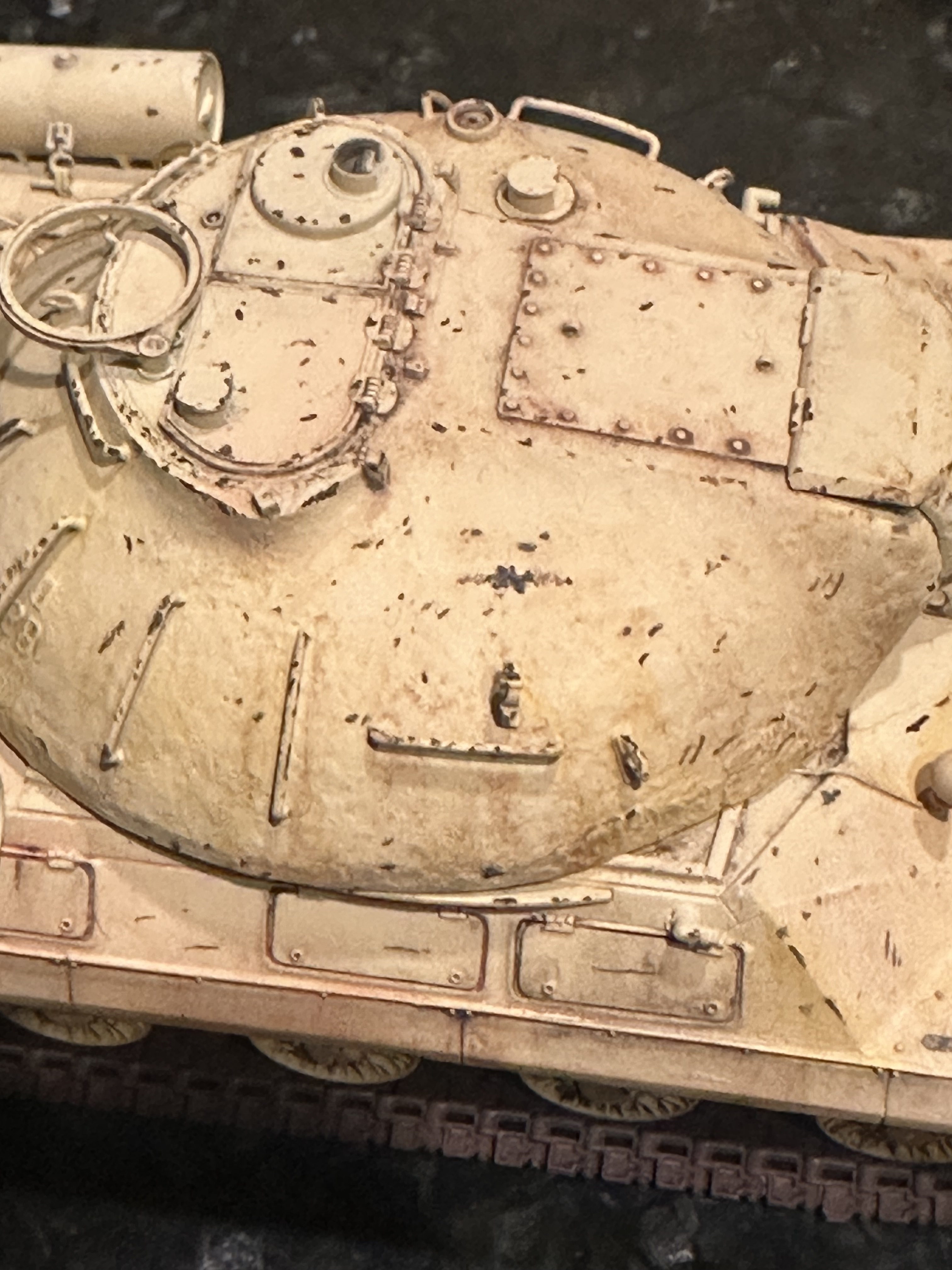

My attempts on an old IS-3M. I can see a bit of blue and orange peeking through in places, but it’s mainly become a muddy wash more than anything:

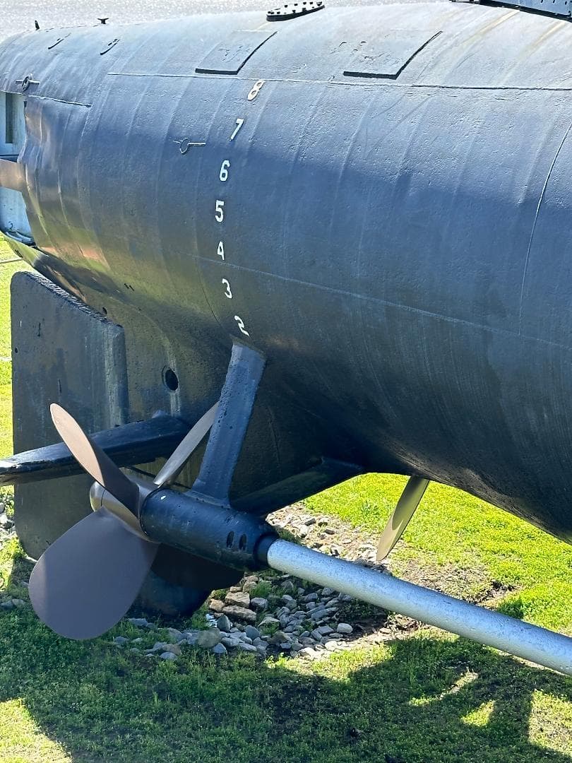

I did see the effects on the black painted parts of this submarine. It was quite interesting. But the camera was unable to really capture it:
