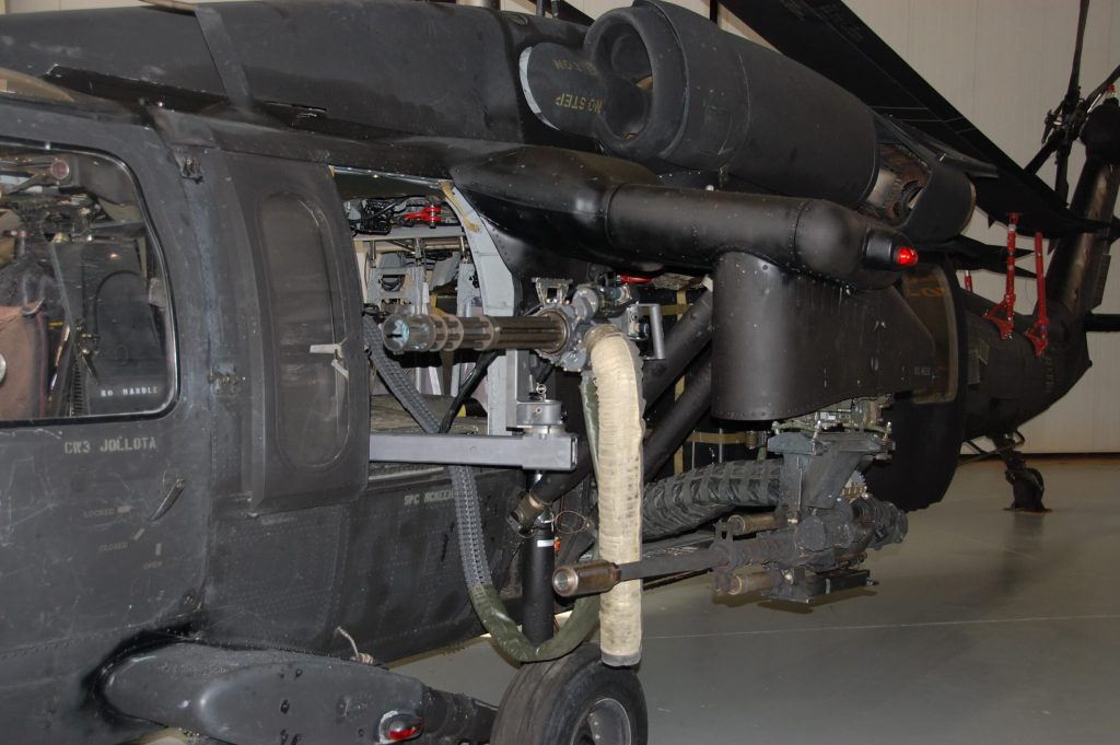

I have the Academy AH-60L kit in my stash and look for a model of the M230 Chaingun and the ammo feed. So any infos on the helo itself and the armament options will be great.
I guess you mean MH-60L :
Same gun on a UH-60L used in the Black Hawk Down fight in Somalia.
First off, as Frenchy noted, it is an MH-60L DAP. AH-60L is a misrepresentation by Academy. There is no AH-60 in the US military, they are all MH-60s with the MH meaning Multi-mission Helicopter as used by special ops units, specifically the 160th SOAR (Special Ops Aviation Regiment) in the US Army as the model depicts.
As to the armament options, all the ones in the kit are possible, along with the M230 Chain gun. For the chain gun, there was one available in resin by Cobra Company, who was sold to Lone Star Models, so I don’t know if it is still available.
There is also the chain gun and full ammo box, feed chute, and mount for it in the 1/35 Kitty Hawk MH-60L kit.
Thanks Gino!
Sprue F from the Kitty Hawk MH-60L kit has all the gun, ammo can, and mount parts. The feed chutes are on the PE fret.
The F sprue is for sale on eBay. You also get a bunch of extra weapons and other parts.
Sprue F eBay page
