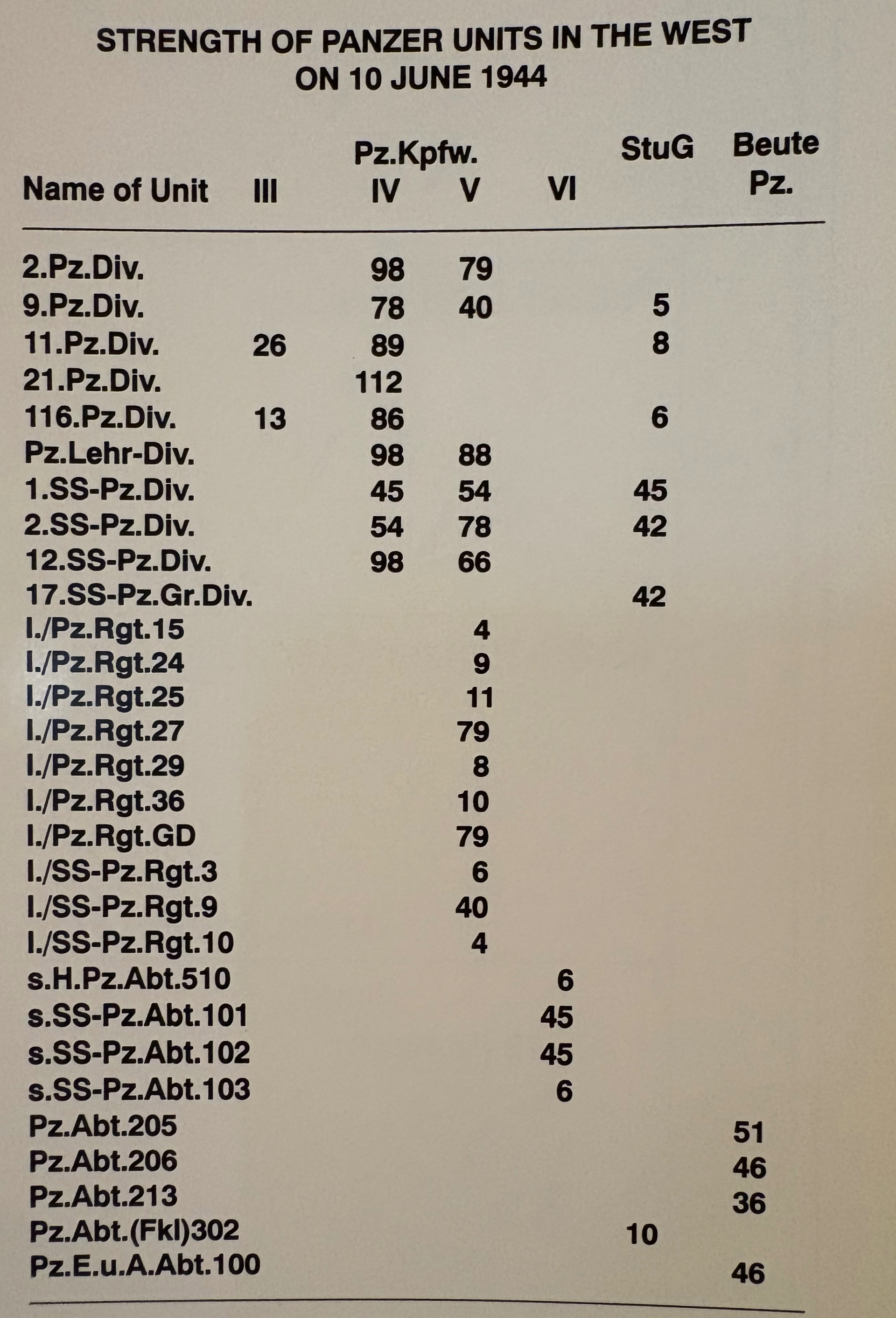

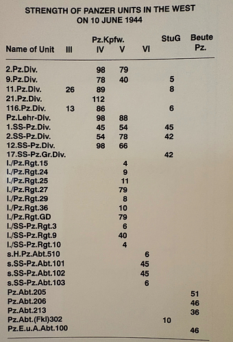

This table is from Panzer Truppen, Vol II, Thomas Jentz, page 177. Not seeing any Panzer III listed for Panzer Lehr. Looks like only the 11th and 116th.
Steven Zaloga provides a similar table with the same figures in German Tanks in Normandy 1944. No mention of Panzer IIIs in the Panzer Lehr.

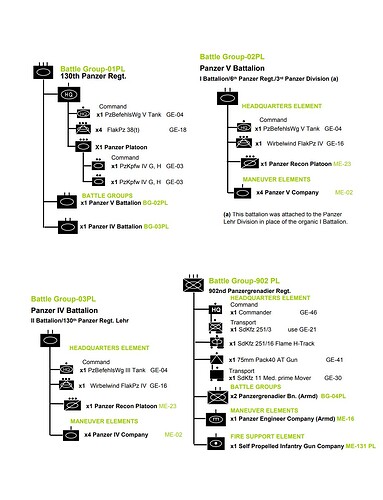

I was working off this Order of Battle chart
But had also seen commentaries that there weren’t any panzer iiis with Panzer Lehr.
That’s why I was hoping someone had the book which claim to have contemporary organisational data from the unit commander.
It’s Niehorster’s figures I’m hoping the book will substantiate and expand upon.

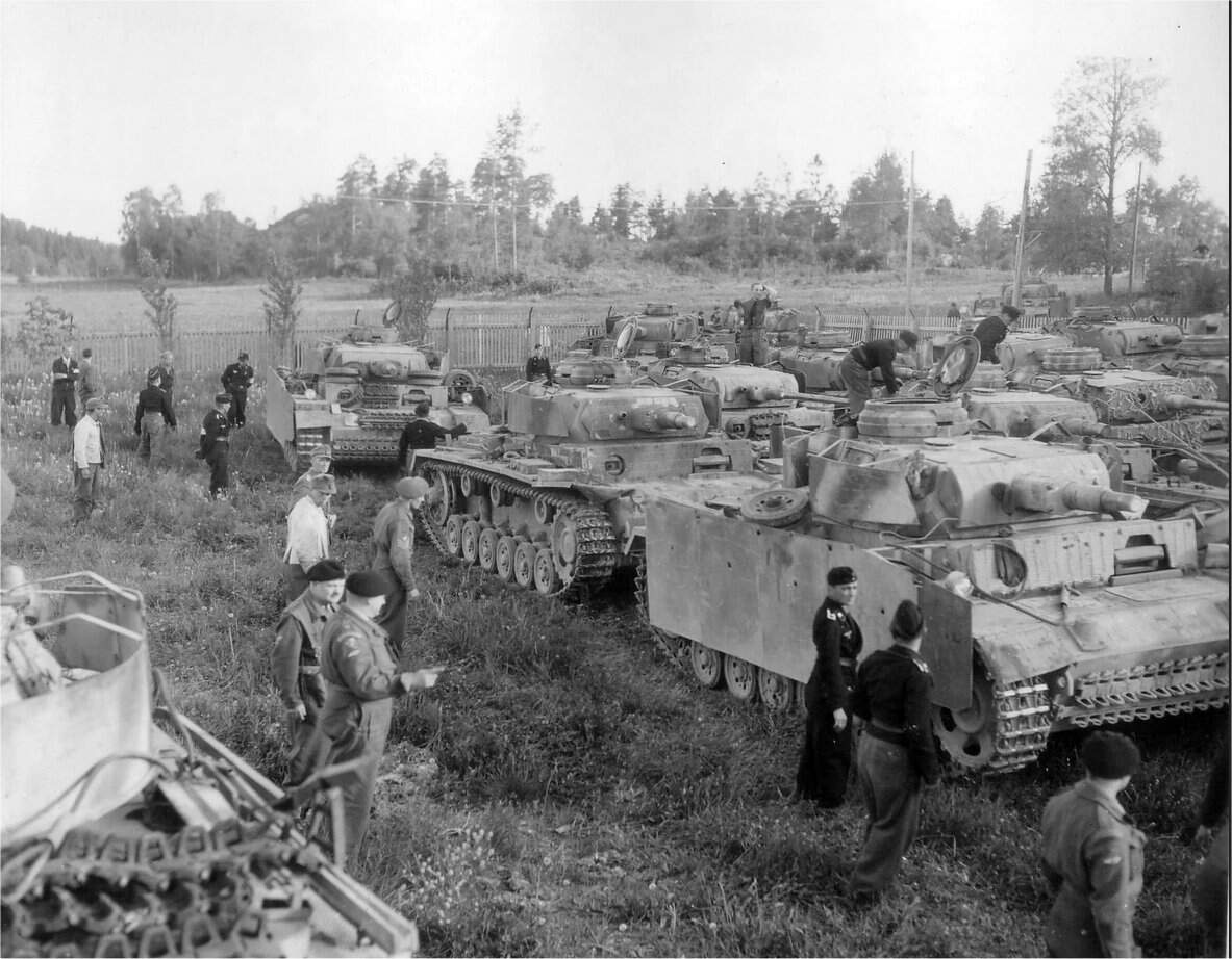

Just by way of nothing very much at all, I understand that the Mk IIIs were the main tank used by the German forces in Norway:
Tempting as it is, I’m trying to focus all my builds on Normandy ‘44.

I’m pretty sure these would have been Ausf K command tanks in II Battalion (the Panzer IV battalion)
