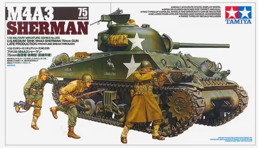

Could I use this model to build an early idf as the inicial picrure?
The IDF Sherman in the photo, is based on an M4 (105) VVSS, which would have a different engine deck and hull rear, additionally it should have a metal line used for connecting the canvas thingymajig on the turret face. Other small differences due to Israeli modifications.

No :slight_smile: That Tamiya kit is a large-hatch M4A3, the tank in the first photo is a large-hatch M4 with a different engine deck and hull rear, as well as other details. As @Sisay_E says, these Israeli tanks were based on M4 (105 mm) models (there were no other large-hatch M4s with welded hull front) but with a 75 mm gun and mantlet retrofitted. Modifying the Tamiya kit to that configuration requires more than just swapping the engine deck and hull rear with those from an M4 or M4A1 kit, though.

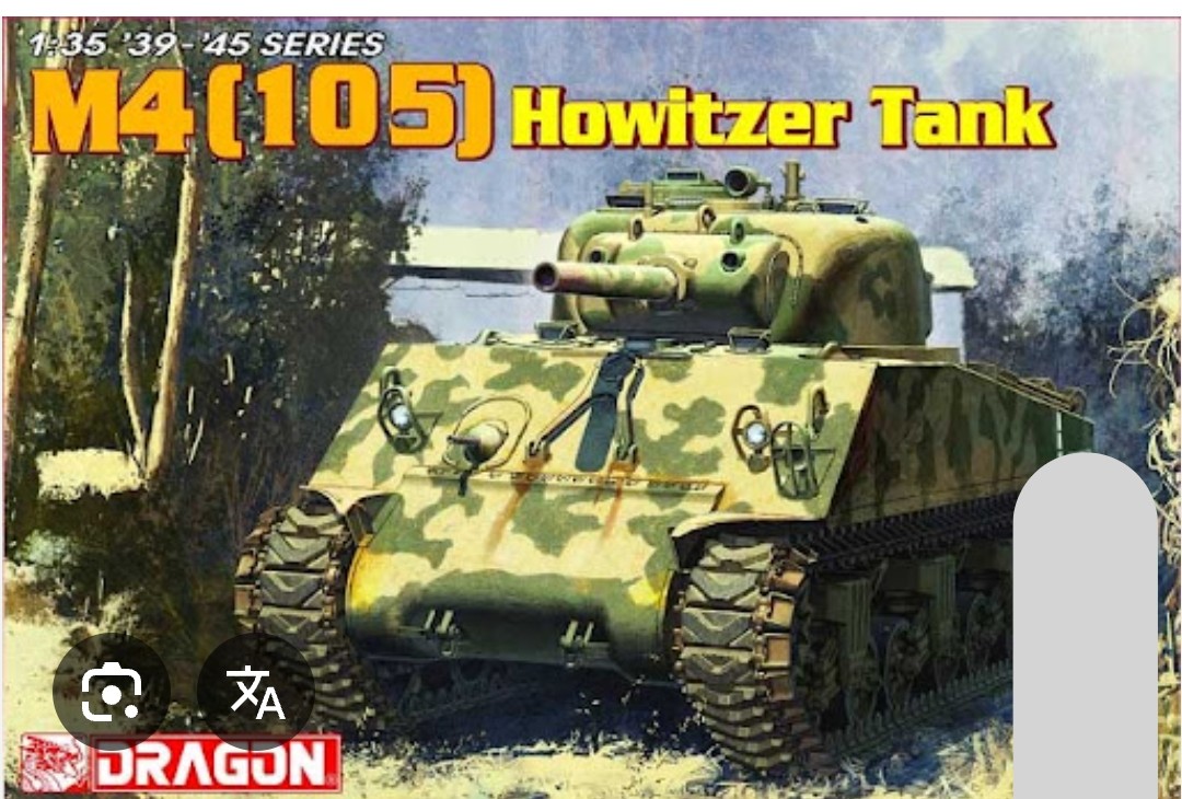

This one Could be a better match then for the inicial one?

Yes that is the perfect starting point. The tanks the IDF acquired had the 105 guns demilitarized by having holes drilled in them and were replaced by 75mm guns with their corresponding gun mantlets.
Many had miss matched road wheels and missing parts like head lights
Also most (probably 90% from the photo evidence) IDF Shermans used T54A1 tracks.
Most likely, yes. I don’t particularly like Dragon Shermans myself, but at least this should give you the right tank straight from the box. You may want to replace the tracks by T54E1s, like @idfpaul also says, and you’ll have to find an M34A1 gun shield and 75 mm gun somewhere, because those don’t seem to be in the box (going by the instructions). You will want those from another Dragon kit, BTW: Asuka’s, for example, won’t fit the Dragon turret.
