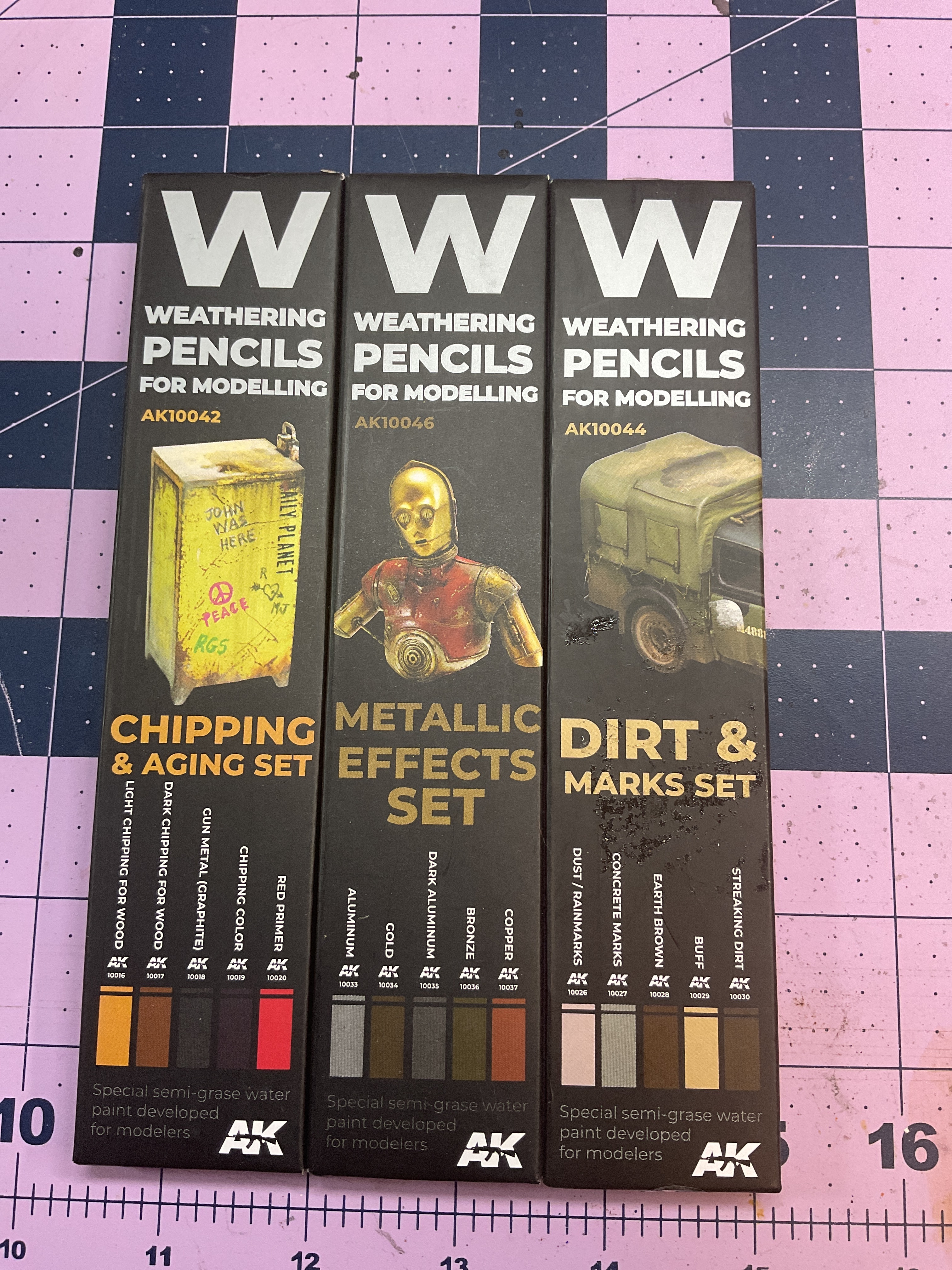

Sorry was enjoying my pizza and typing one handed, I meant sets w either 5 or 6 pencils, don’t remember the count. I got metallics, rust effects and dirt and grim sets I believe. I lucked across of pastels Prismacolor colored pencils at Hobby Lobby that for military models had a nice range of colors, it didn’t have your rainbow of colors so I grabbed them and use them all as needed. Sorry for the 5/6 confusion, if you see the fullest online you’ll notice it’s an odd number of pencils (for some strange reason). I wouldn’t invest in that, just try a pack or two that look like they are pertaining to the kits you like to do. Here’s the sets I got

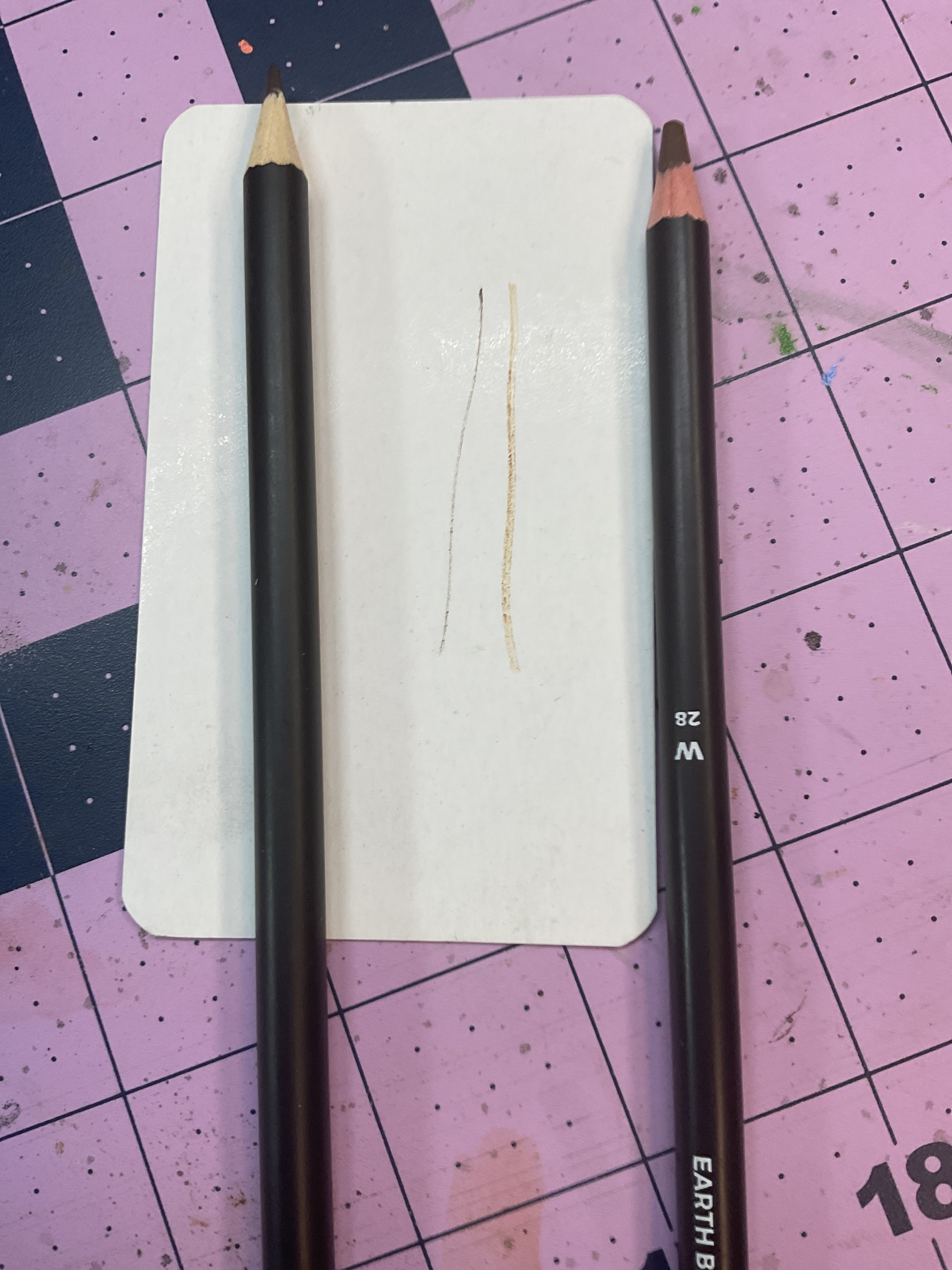

As I said here in the US you can find Hobby Lobby with a sale that makes it hard not to drop a few bucks to try the, out. For comparison here’s a generic pencil on the left and an AKnon the right.

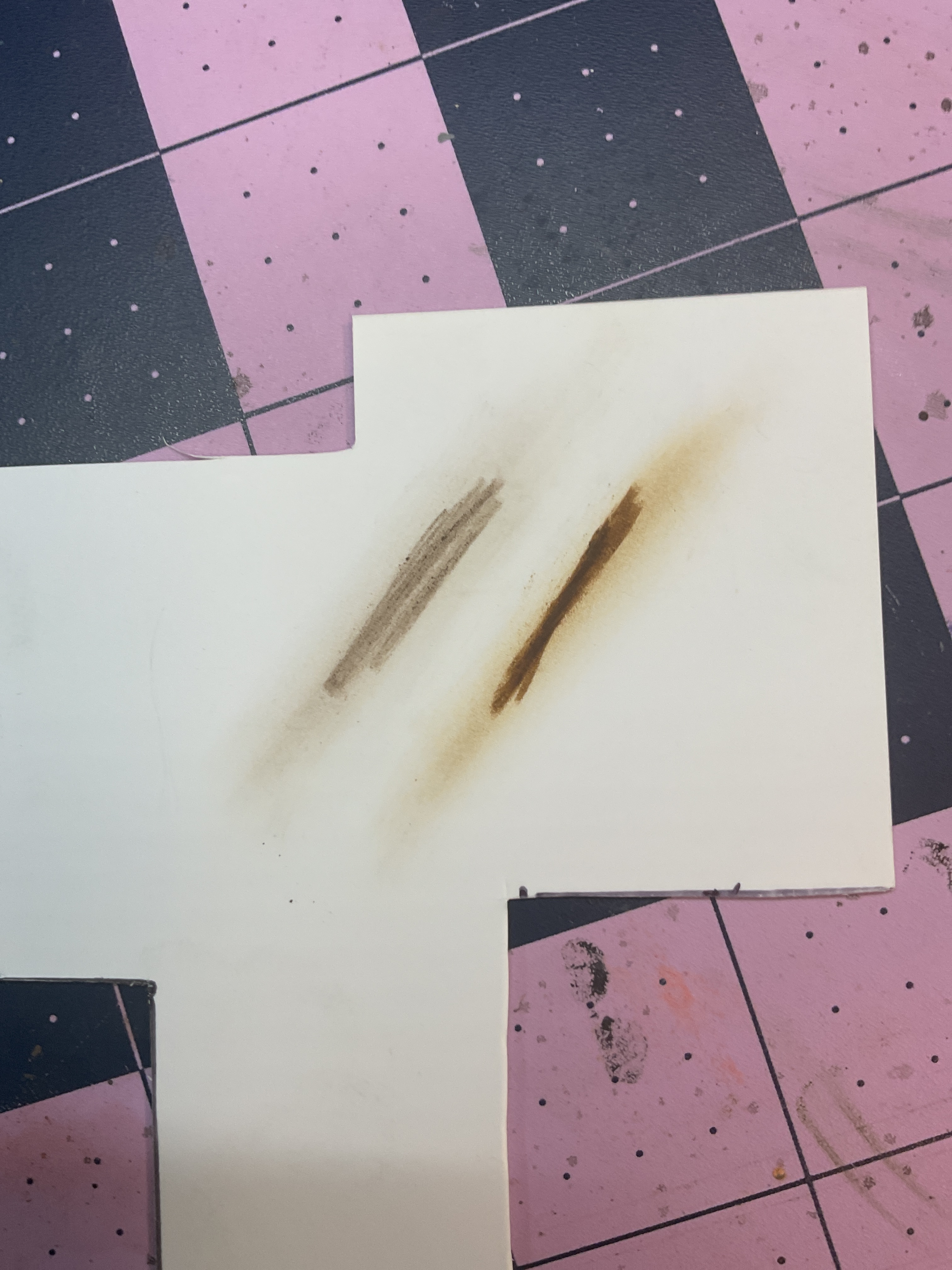

And here’s a example of each on scrap styrene, good solid stroke, then rubbed with a dry finger. Not super scientific but think the results show similar results.
Hope you find that somewhat useful. I got all 3 sets for less than $10 to $12 w Amazon Prime so what the heck.
