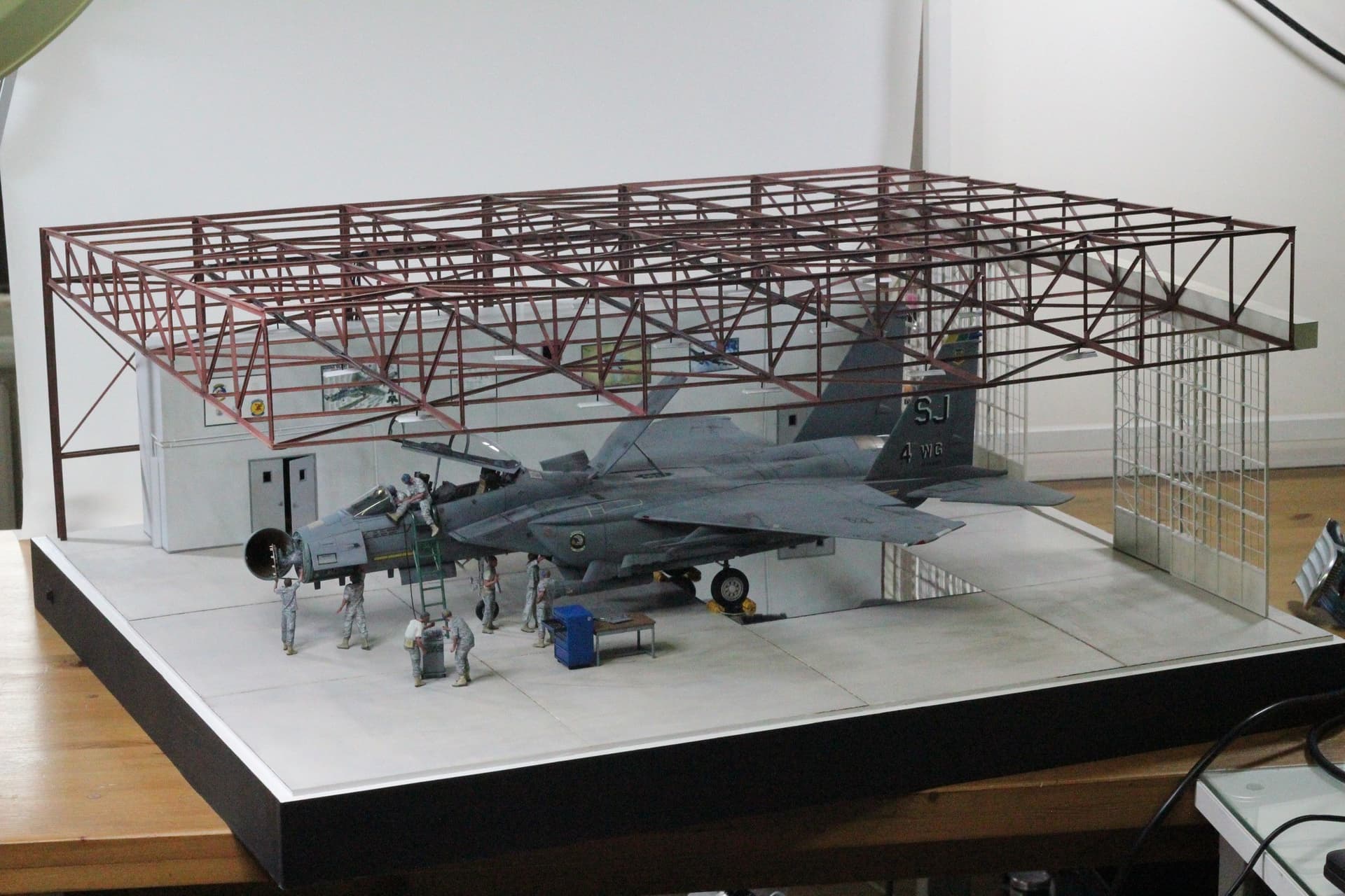

Not mine, but illustrates.
Of course depending on the size of the hangar would could go bigger than as described above.
Wade pretty much covered it. I would only add it depends on the type of maintenance for the hanger/covered and base.
HTH

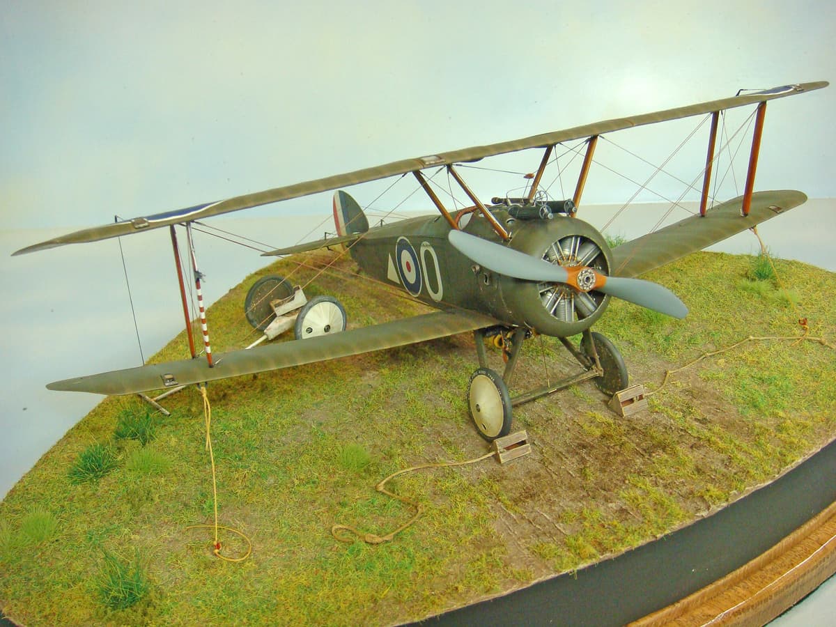

From my own point of view, I’ve found that most aircraft displayed on rectangular bases have entirely too much “wasted” space around them. This excess space and it detrimental effect on overall composition leads to modelers intuitively trying to fill that space with compositional elements that detract from the focus of the work - the aircraft model, itself.
This has led me to experiment with ovals and rounded bases in order to limit the space around the model (the space is a compositional element in and of itself, so too much or too little on any base detracts from the overall work).

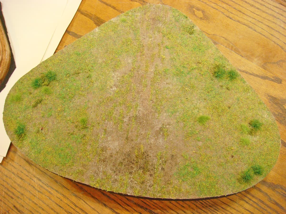

My own best solution so far has been a diamond or heart shape with radius turns that has been matched to the size of the model. I start with the paper template (using the model or a scaled plan view of it to represent the model) and adjust its size and shape before transferring the final design to my base wood and cutting that out to match.
There’s still a lot of compositional area that has to be dealt with, but this is the best general shape and adjustable size that I’ve come up with.

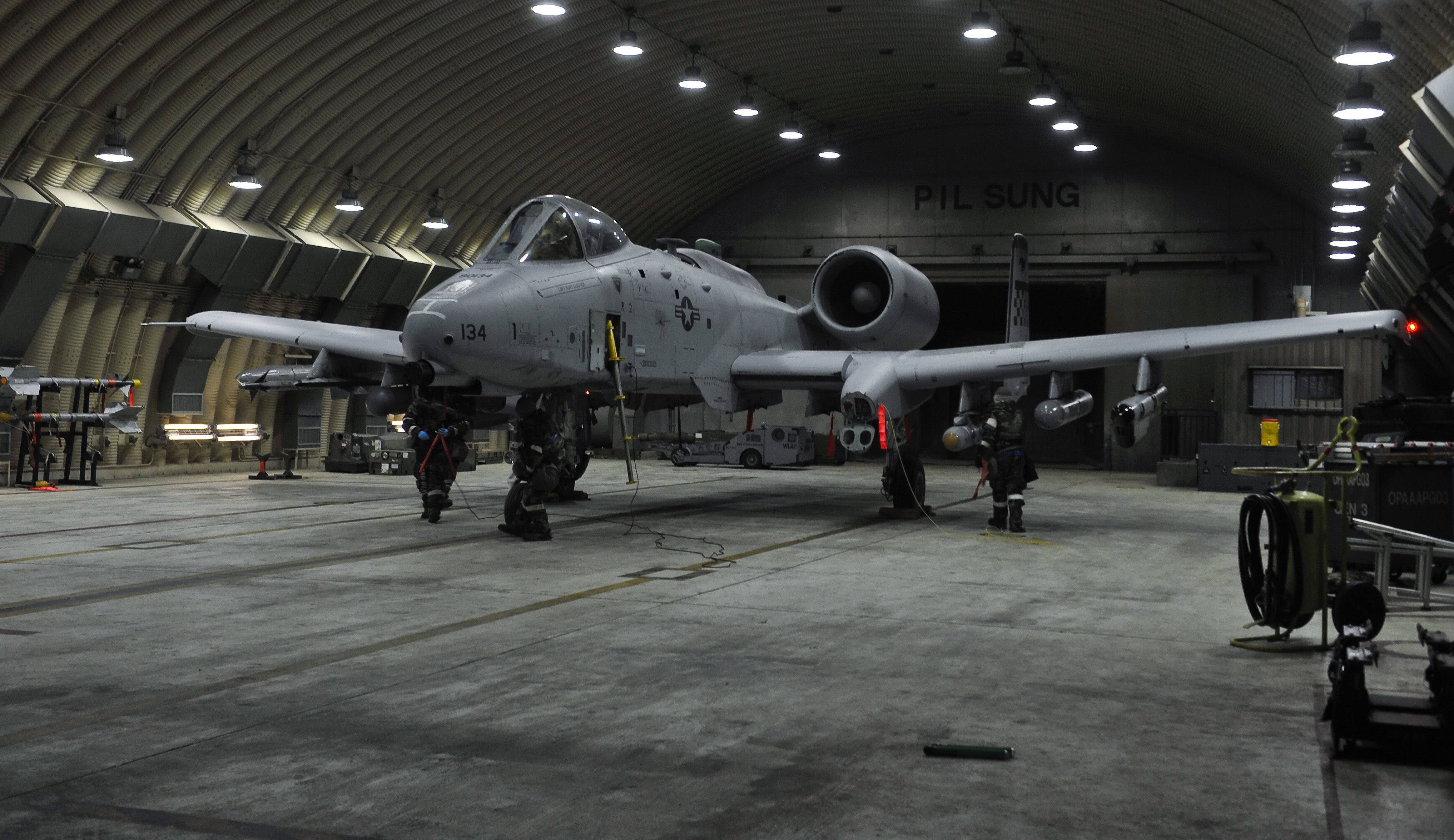

Perhaps something like this.
Laurie

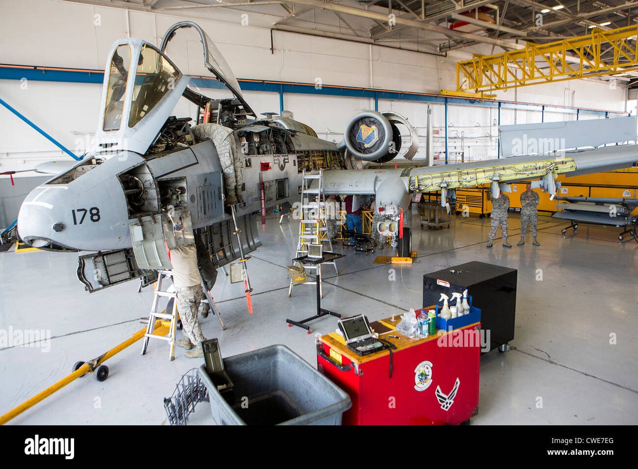

As for what I want is to have a major maintenance experience for my A-10a!
Sorry sir,
The photo number 1 of the A-10a.
You need to acquire the 1/72nd scale support equipment in the photo.
Build the equipment and start setting the pieces up around the aircraft. You do not normally want the aircraft sitting parallel or perpendicular to the edge of the base. You want it to sit at some angle to the side of the base. It is OK to have the wing extend beyond the edge of the base.
Draw the outline of the base that will include the aircraft and equipment. Finish work of the aircraft and equipment. Create the base using the measurements from your drawing. Attach aircraft and equipment to the base. Create a label for the base.

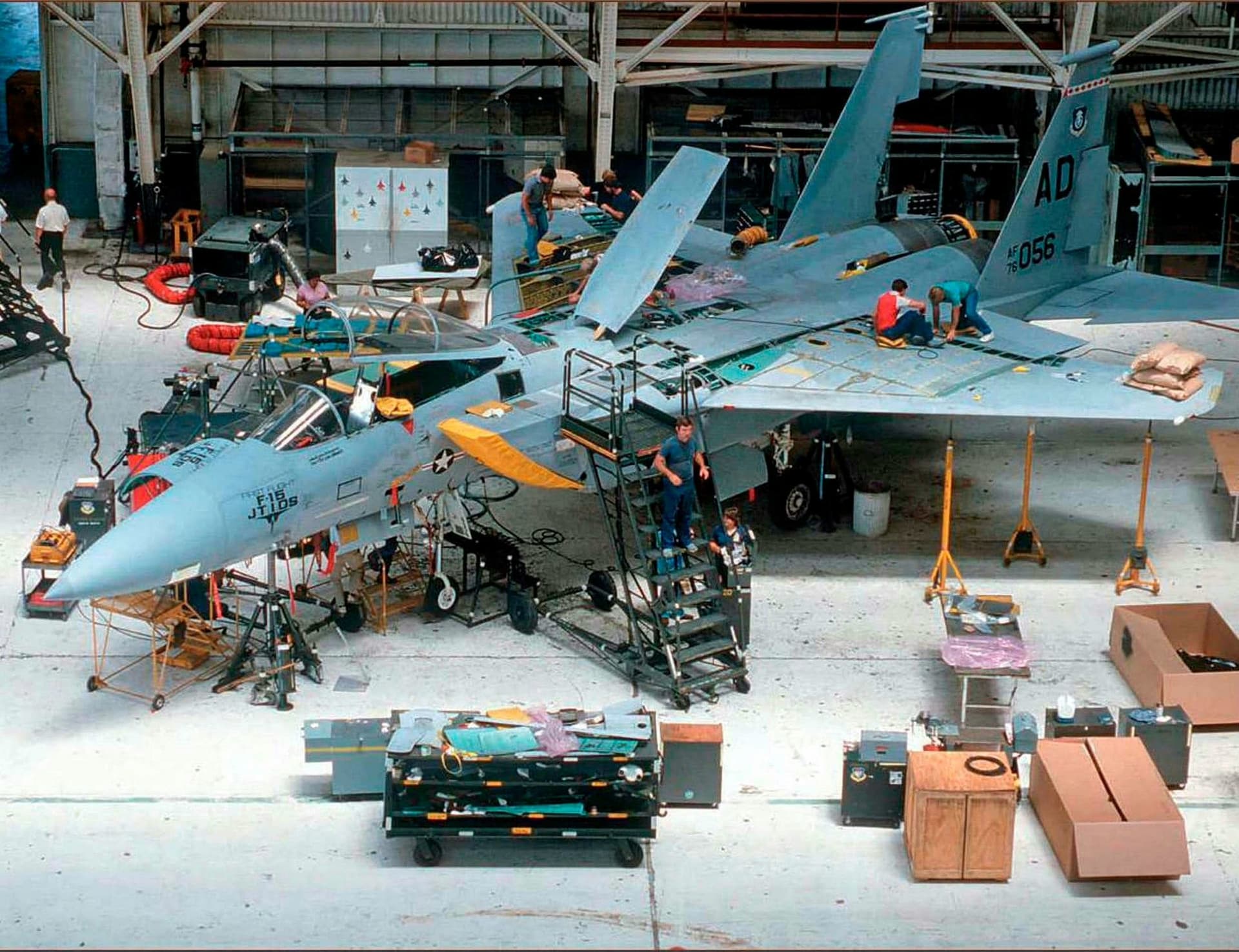

Sir,
This is exactly what I’m doing my A-10a but with the look of the F15 eagle diorama.
I hope you now understand what I’m trying to say!
