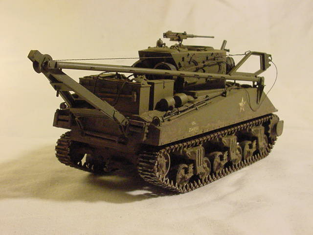

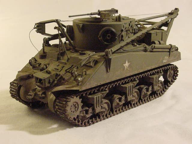

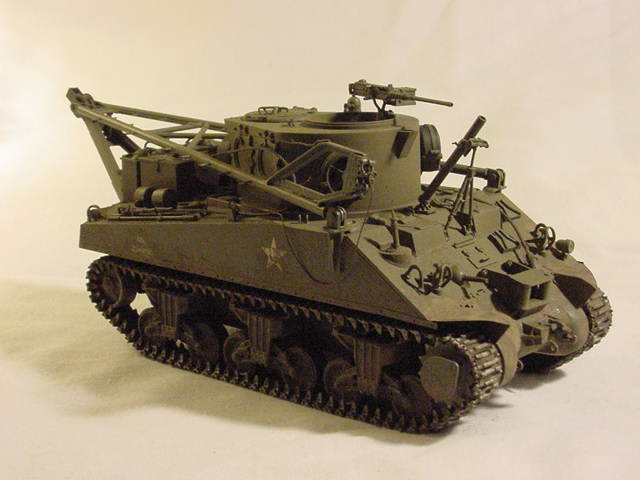

I found my M32B2! Not “Alice”. If I recall correctly, there is an M32B2 named “Alice”, but that vehicle features the early turret like “Almighty”.
The M32B2 I eventually decided to build is named “Lulubelle”, just like the M3 from the movie “Sahara”. A single picture of this vehicle appears on the Sherman Minutia site about a quarter way down the page.
There are some potential hangups. As mentioned by Roy, the Italeri M32 turret is kinda borked. The turret requires a second low prifile commander’s split hatch. Modifying the boom mounts to fit an M4A2 instead of an M4A1 probably takes some effort.

“Lulubelle” is an awesome M32A2 for a very specific reason–the second commander’s hatch. That is not a problem, it is a boon! With that second hatch closed, it is possible to build an M32 variant with no interior required! It also means there is no need to scratch build an entire M32 turret. One only need adjust the outer contours of the Italeri turret.

I found a very good picture of “Lulubelle” in the book Heavy Wrecker. “Lulubelle” is the retriever that put the Japanese tankette on the back of “Killer”. Another forum member is currently building the latter subject. I now have two good pictures of “Lulubelle”, good enough models for the job, and two options for more accurate turrets. My spares box includes an extra low profile commander’s split hatch so this project is also ready to go.

I used the dragon M4A2 hull too make an M32B2
