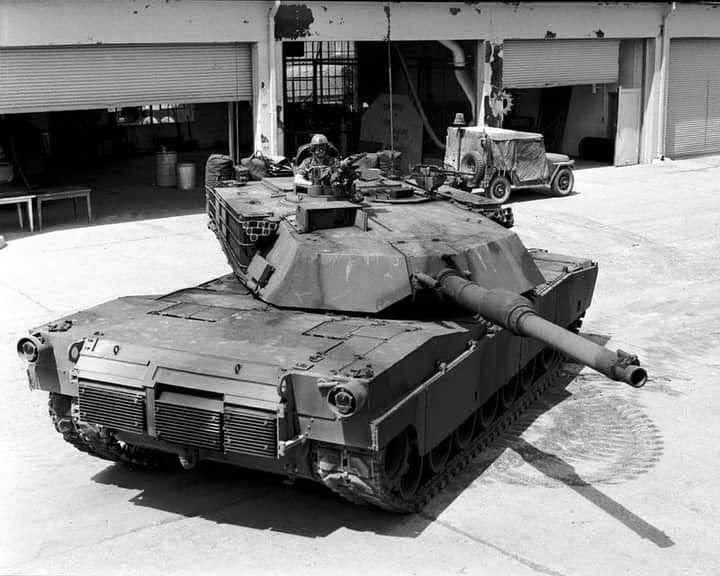

The big question is what kind of vehicle are you building, tank, APC, etc., and do you have a specific vehicle or unit in mind. Then we can get into more detail about just what you want. For now, here are a few photos to get you going:
dfsjf9
This one the light is broken!
Ken

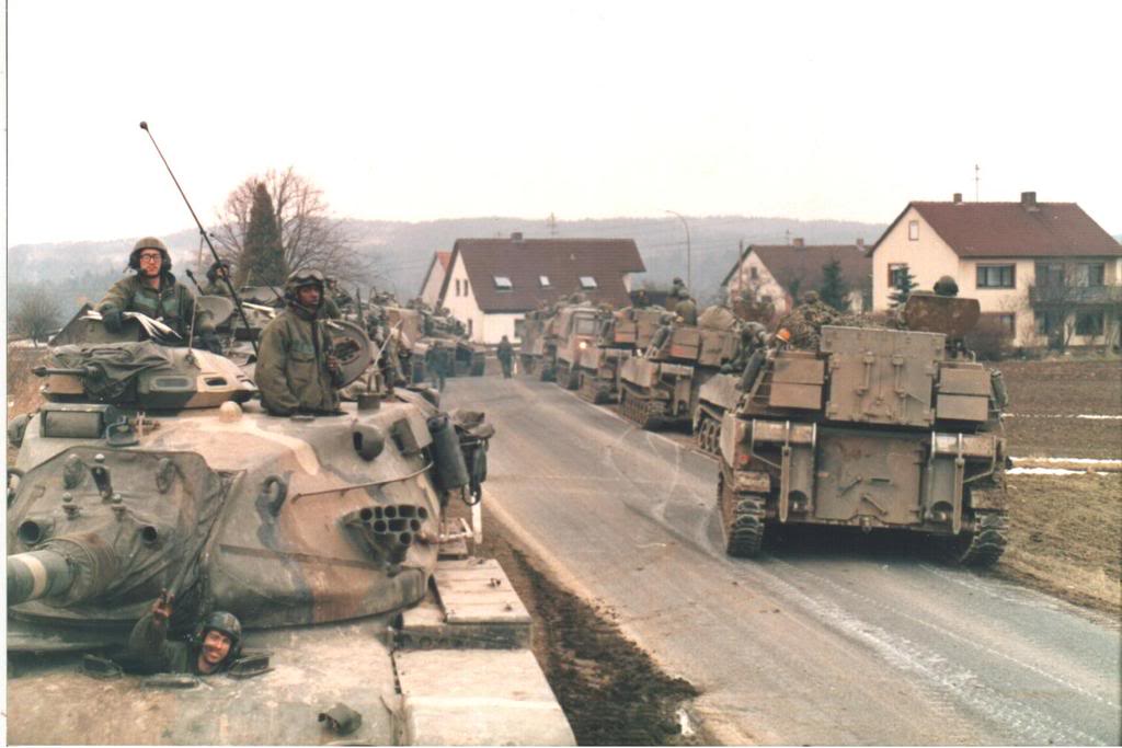

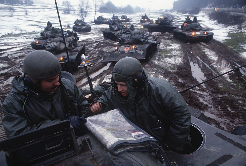

Heres some pics of my tank or others back in the day.
