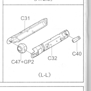

  • Is what Kitty Hawk calling “L-L” the Damocles targeting pod that was the main difference with the Standard 5s (parts C31, C32, C47)? It definitely looks like the one from L’Arsenal. And is the pylon in the kit still correct for a Damocles (also, why did they call these K-K or L-L and not their real names in their instructions?).
