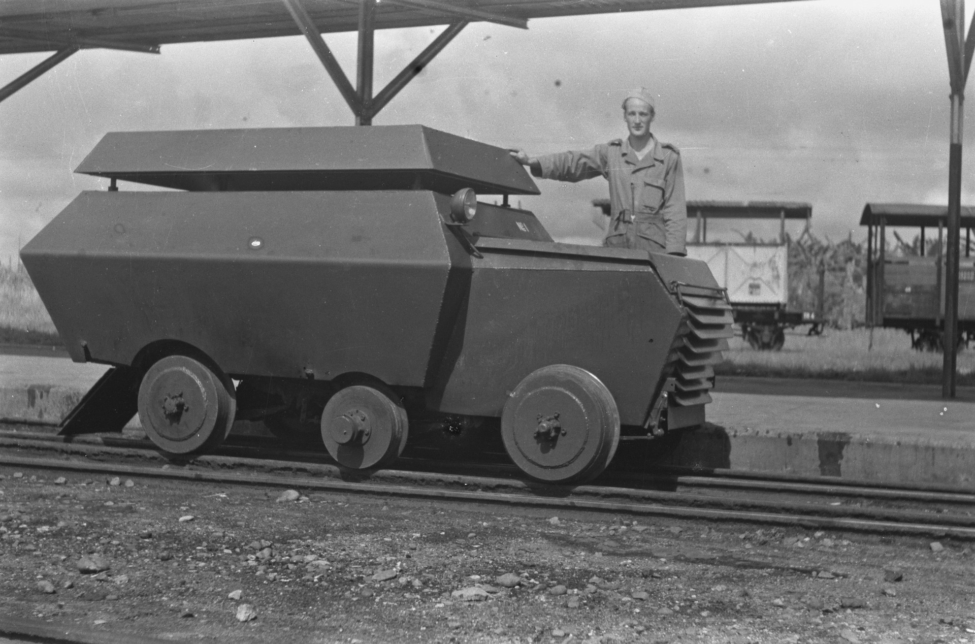

Another jeep used in Kertapati, South Sumatra ( Dutch East Indies) in 1947

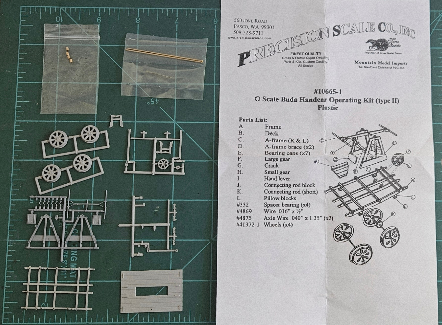

I originally bought this handcar kit to convert to On30.
That didnt work so picked up the On3 version.
These kits are similar to Grant line castings.
Easy to work with.

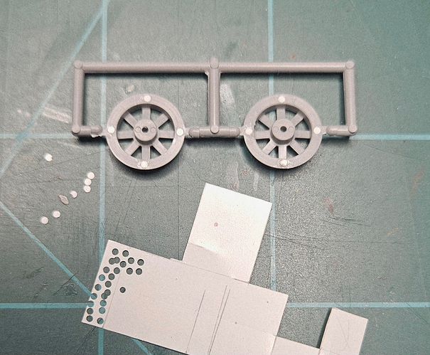

Little flash and some sink marks.
The only ones I was concerned with were on the backs of the wheels.
Some 1mm discs punched out of .005 styrene fixed that.

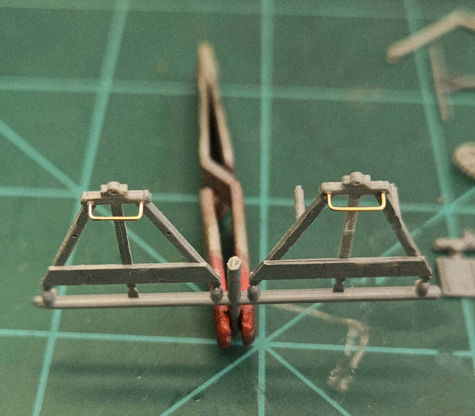

Next some .015 wire tool holders on the A frames.
And then some wheel masks.

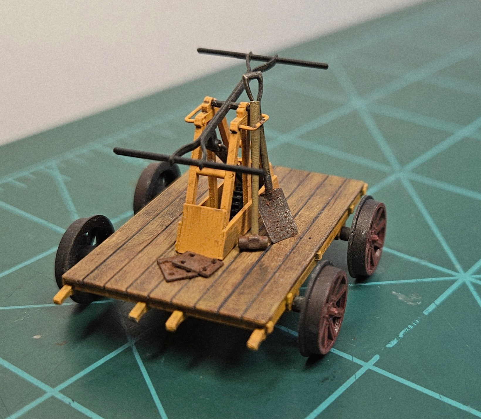

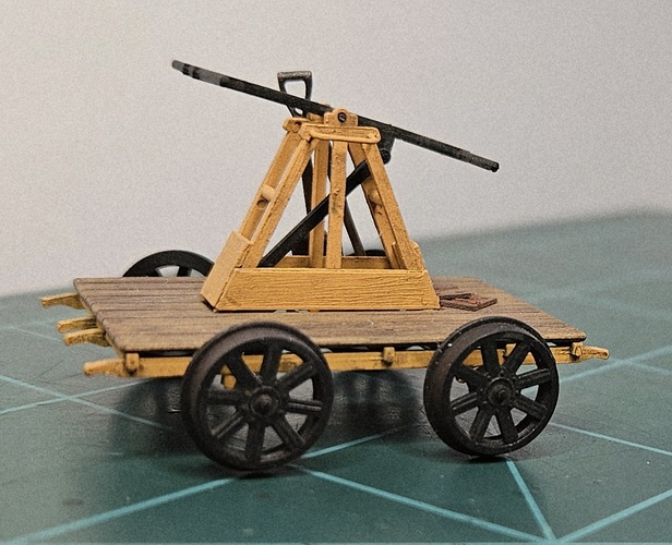

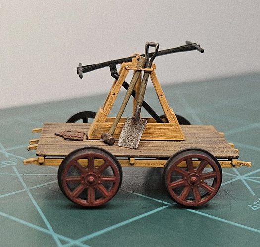

Pretty much done with this one.
Just needs some paint.
These PSC handcars actually operate.
If you push them the hand lever goes up and down.
Not practical but fun.

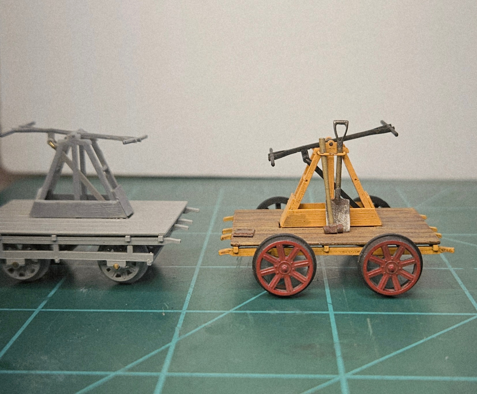

Calling this one done…
and an On30 version…

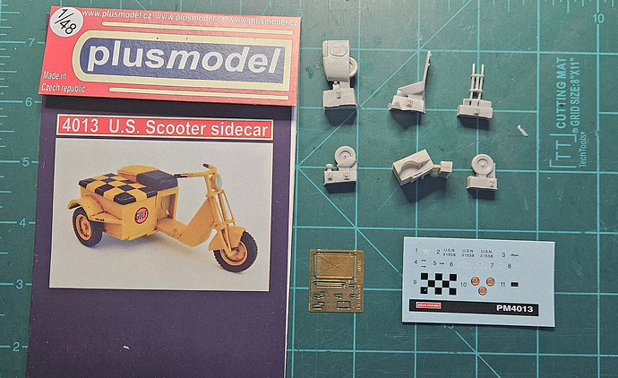

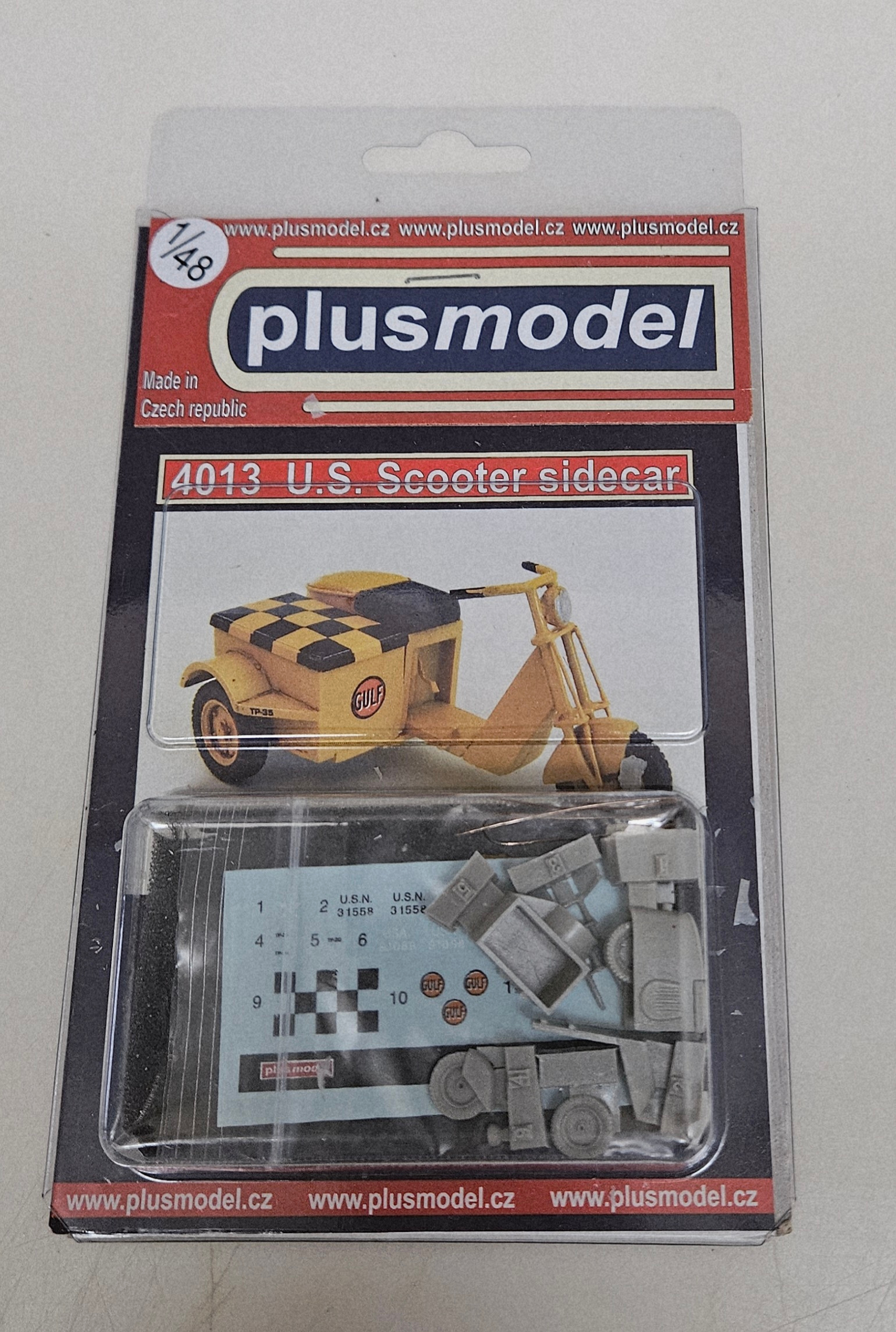

My next attempt…
The parts…

Very nice build, paint, and weather. And operable.
Thanks @KoSprueone .
Operable if you push the handcar.
If you push the lever it breaks. :rofl:
Like I said before not very practical but fun to push and watch the lever go up and down.

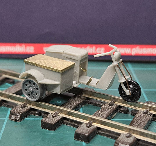

I dont like to work with resin but this kit was quite enjoyable to build.
The resin was kind of soft like a Miniart kit.
Easy to work with.
Had a few CA glue problems while assembling but all the parts are pretty much where they should be.

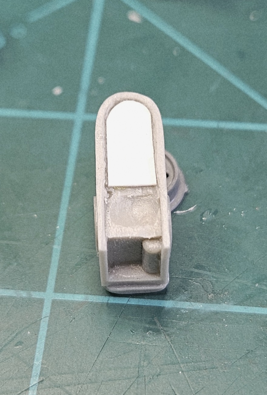

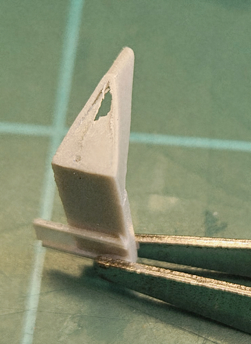

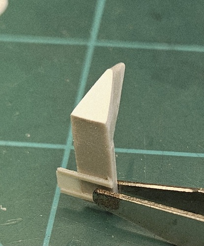

Started off by covering this with a piece of .005 styrene.

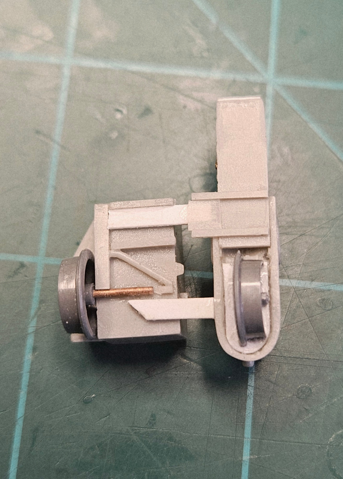

Then added some axles.

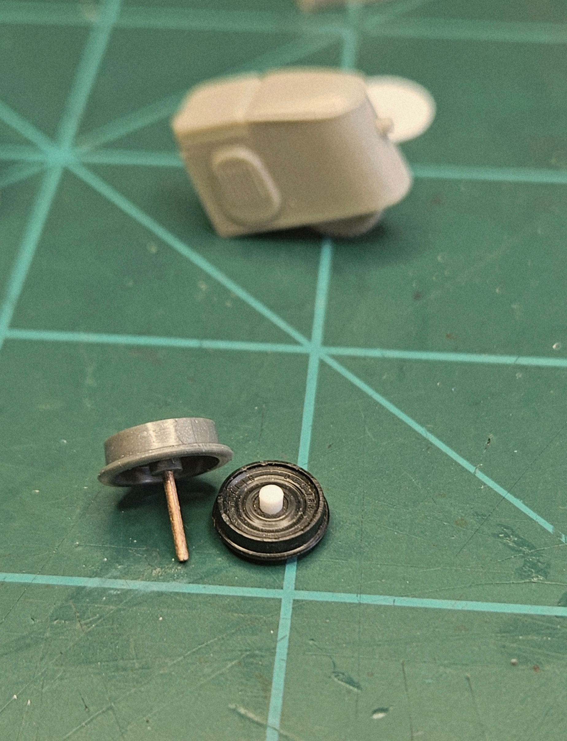

The grey wheel is a Grandt Line 135.
The black is a plastic HOn3 wheel with piece of .040 styrene rod.
This part number 1 with rear wheel removed and a piece of .010 styrene to give a flat place to glue new rear wheel.
I spent about 6 hours assembling this kit.

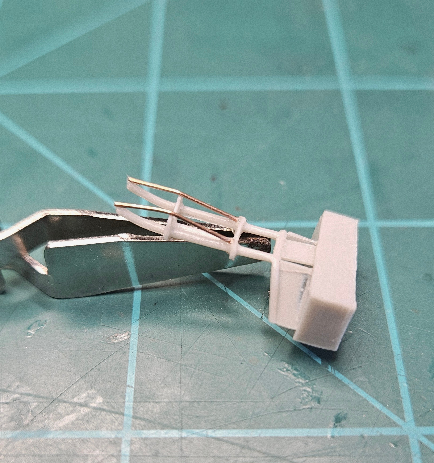

Two hours were spent gluing these wires to the front fork.

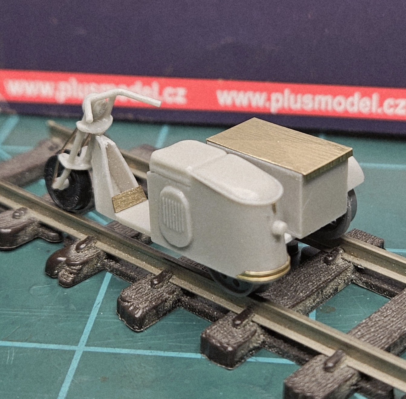

Spacers were used to get motorcycle to correct gauge.
Sidecar ended up not parallel to motorcycle.
Had to cut apart a reglue.
Used a tiny miter box and broken saw to cut rear wheel.
Time for some paint…
@ Gluthanasia. That looks really good!
Only one minor critique: I’d think the one-sided flange on the front fork would skip right off of the track. Maybe scratch-build a ring for its left side? HTH.
—mike :hammer_and_wrench:
Thanks @justsendit .
Totally agree about the front wheel.
Made me wonder how a hand powered velocipede stays on the track.
Maybe move the sidecar wheel forward?

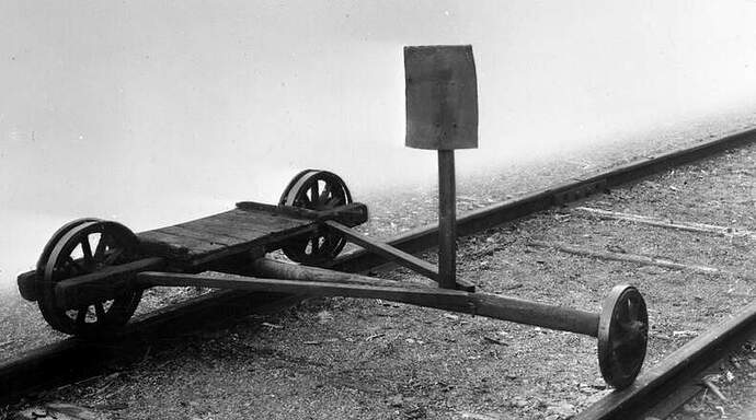

One example, Swedish Railroad museum:
First of all: The wheels are not arranged as a right angle triangle,
the lonesome wheel is halfway between the front and rear axle.
This forces the draisine to stay parallell with the tracks.
Secondly: the wheels on the draisine in the photo has flanges on both sides.
This is OK for a light draisine when the driver/operator can lift the wheel
past the turn out rails in switches/turnouts. Does NOT work for heavy vehicles …
Stick powered, the driver pushes it along using a staff/pole, the lonely wheel does not
have a flange at all, the double flanges on the other wheels take care of the steering.
I wonder how they braked this thing :thinking:
I would be scared sh!tless going downhill on a steel skateboard.
:scream:
I agree, assuming that the handlebar steering is locked to keep the wheel strait. I think your solution is “on the right track.” :railway_track:
