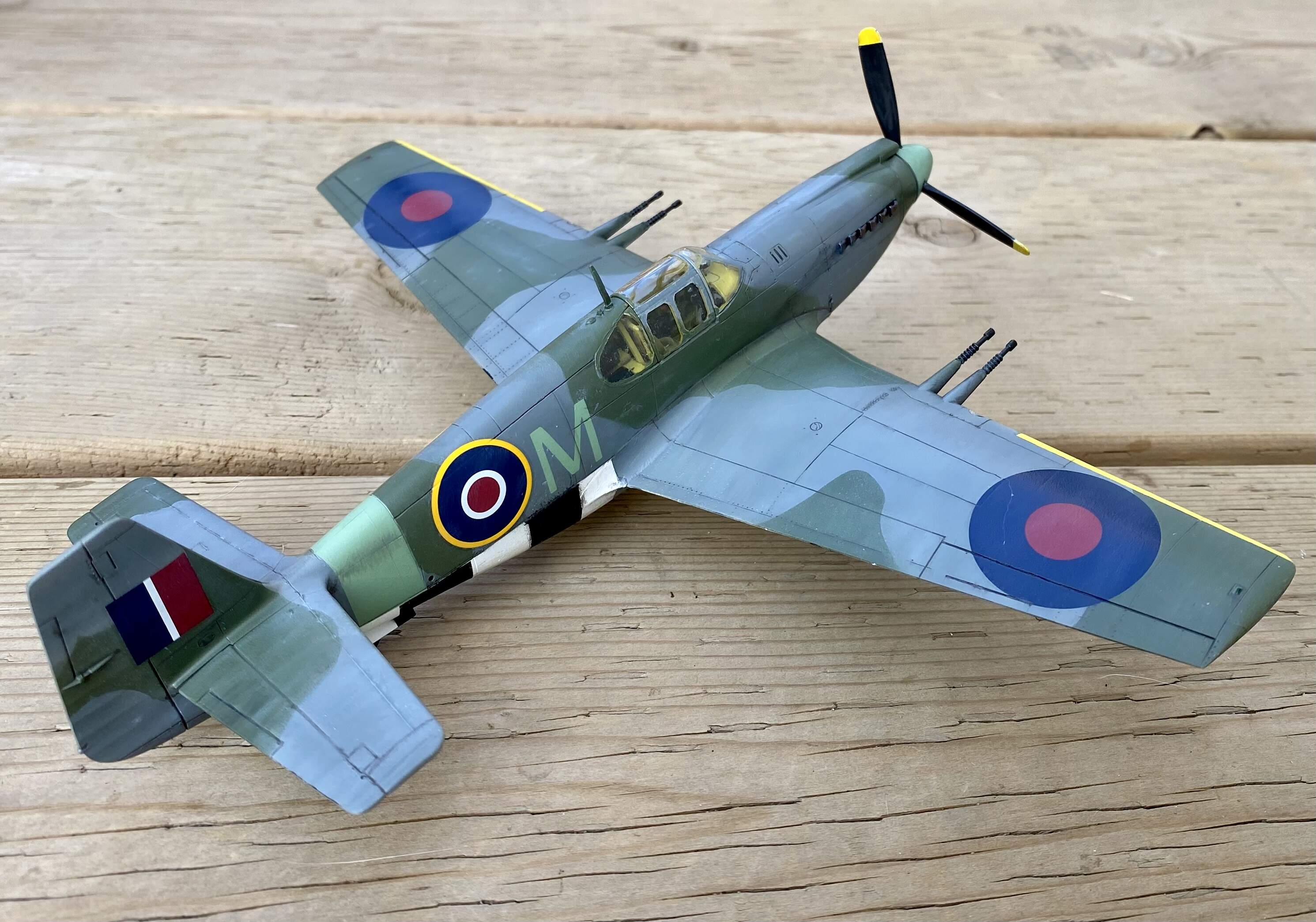

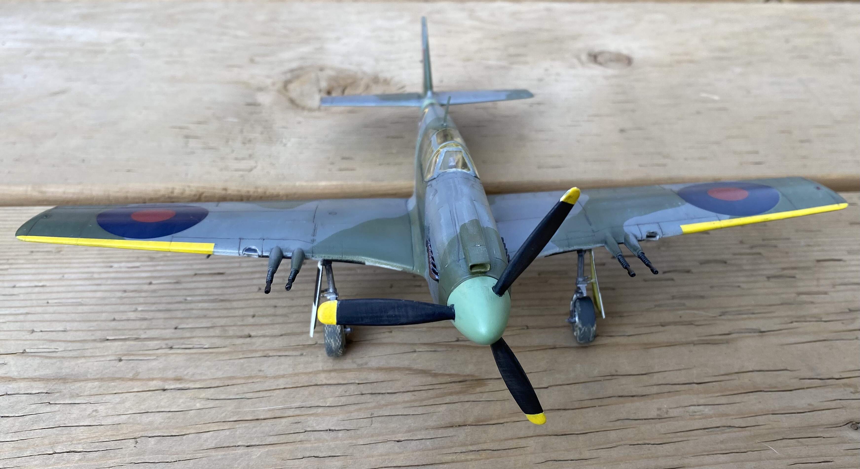

Accurate Miniatures Mustang F6-A shown as a Mustang MkI Fighter-Recon in the markings of 430 Sqn RCAF on the morning of June 6 1944.
430 Sqn RCAF were part of RAF 2nd Tactical Airforce flying fighter-recon missions over Normandy during and following the invasion.
The Mustang MkI in the F/R configuration had 4 20mm cannon and was equipped to carry an oblique angle camera shooting out the port side behind the pilot.
This particular aircraft was flown by F/O Richard Rohmer the morning of the invasion.
F/O Rohmer would earn a DFC in the skies over Europe and eventually retire as a Maj. General. He would later receive an honorary promotion to Lt. General and is currently the most senior (in rank) of all surviving Canadian D-Day veterans.
I’ve had the honour to meet the General several times over the years and this is a build I was very much looking forward to completing one day.
This is also the first aircraft I’ve built in close to 20 years. I like to think the General would approve.

Gorgeous looking build!
The invasion stripes are especially eye catching.
Very nicely done, Don! I especially like the background of the plane and pilot. So that gives always a “face” to the build. That’s just the way I also like to do my builds. What kit is it? Accurate? Well done!

Fuselage band and Spinner are RAF Sky which is a weird blue-green colour. I mixed mine with a grey base and then kept adding blue, yellow and white until I was happy. If I were to make it again though, I think I’d go white base and add grey because my final colour is a bit dark.
Interior I went with Tamiya Yellow-Green in place of Zinc Chromate with a slightly more green tone for the cockpit tub to represent US Interior Green
That came out really nice . From looking at that , you have not lost the touch. I would have never guessed it was 20 years since your last aircraft.
On the contrary Chris, I never had the touch to lose. This is all newly developed skills. And YouTube. Where would we be without YouTube.
Brother it is beautiful. It makes me want to do a wingy thingy.
