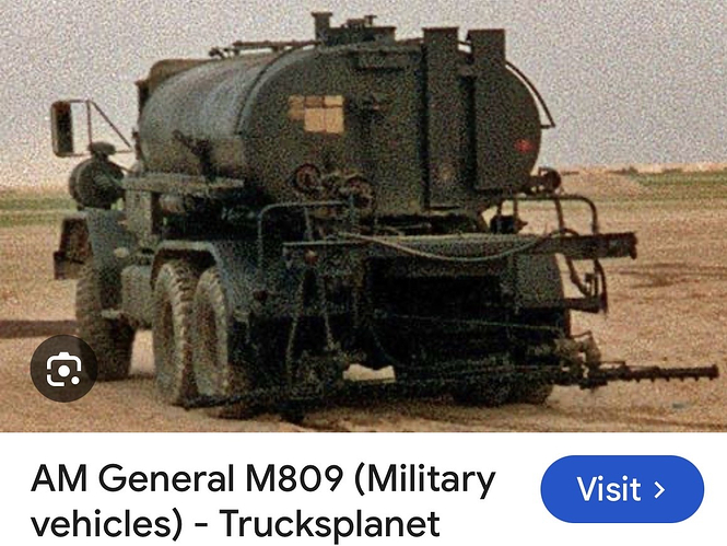

Looking for a tank, as shown below, or for bitumen spraying to mount on a 5-ton M809. I think RM used to make one and you may just have one in your stash.

That’s just the sort of thing I’m looking for HP. Thanks for the pic.

Using your photo to compare to:
And using cross section drawings of the HEMTT tank, I think you’ll see the HEMTT tank is too flat on the top and bottom. You may try this method, which is similar to how I do a lot of scratch building, and which I’ll show later tonight when I get home from class:

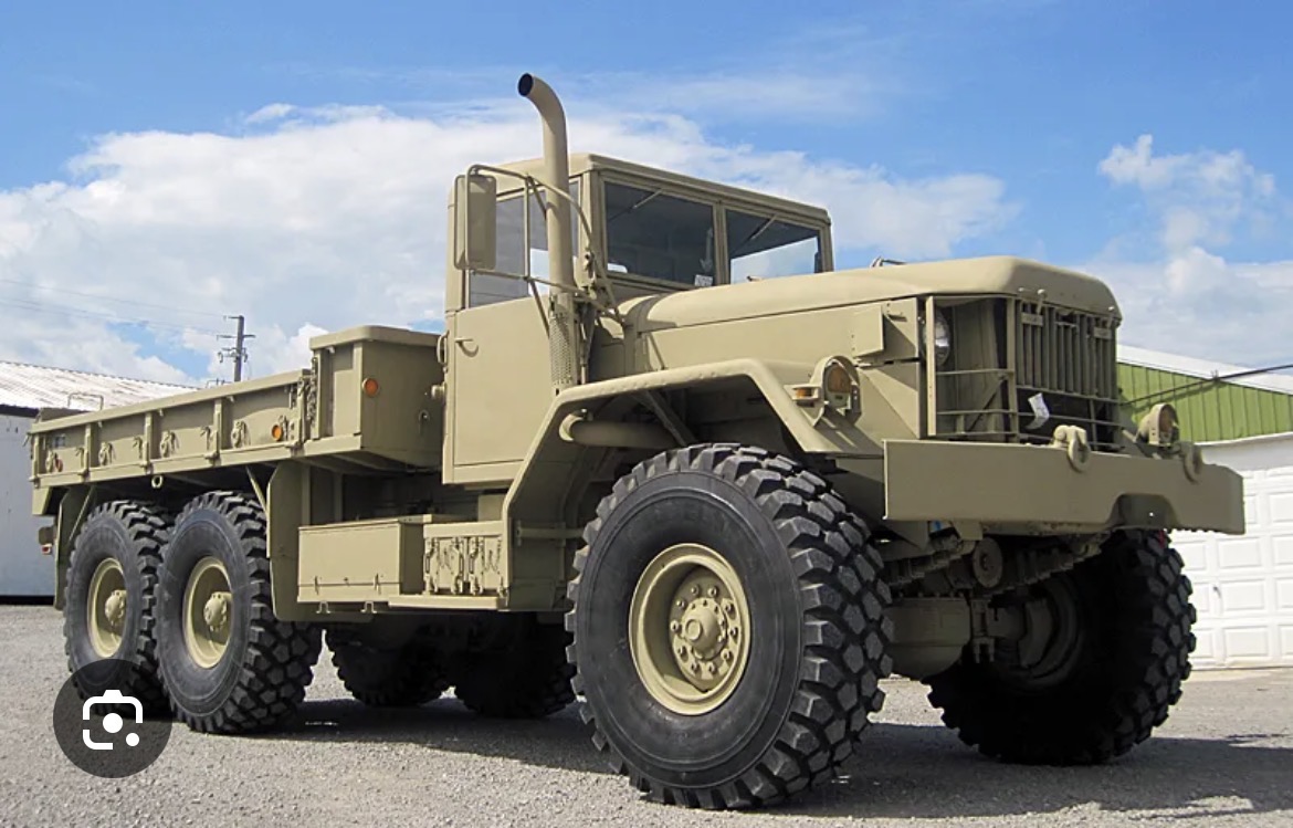

What I’d also like to see is 14.00 x 20 military lug tires on old school five slot wheels.
Don’t know those, be keen to see a pic.
One of my current needs is a set of 12.00-20 tires, eleven of them After my next build I’m tackling an M246 tractor/wrecker and the majority of those fielded used the bigger tire. The Hobby Link conversion set doesn’t include them, but I’ve got a Cultus guy who plans to do them for me
Still running duallies on it? MY 14.00 x 20s would be for singles.
Yes indeed. Not like on the later M925, super singles?
Non directional?
I’ll have a look tomorrow.
Like these on an M813.Apparently the Marines bought a bunch shod like this. Led to several MVI before ABS was introduced.
