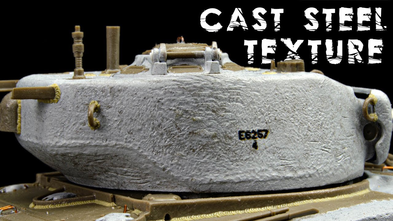

This might be of interest Night Shift - Martin Kovac on Armor Texture He has lot of truly excellent videos that are worth checking out.

Night Shift’s stuff is excellent and the diluted putty works really well for coarse casting. I’m working on a TAS 44M right now as a test bed with Mr Surfacer 500 on the left and stippled Tamiya extra thick liquid cement on the right for a subtler texture.
