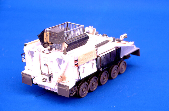

I know it’s a WIP so alot of the alterations and some more scratch building is still to come so you may of already thought about these @smolensk .
If you want it as close to a Samson as you can, it may be worthwhile looking at a couple of areas for realism.
The LH hull fire extinguisher should be a Fixed Fire Extinguisher and not the portable type. There should be one in the kit ?
The DVRs hatch needs a return piston/dampener assembly on the RH mount. Again, you can easily convert one of the Scorpion turret hatch ones.
The exhaust pipe could do with cutting back a bit as I have never seen one that long or that shape.
The Comds cupola needs a bit of work. The front sight is a bit oversized and doesn’t really have the cowl look like you see on Spartan or Strikers. It’s about 2 thirds of the size of the one on the model. Without double checking I think there is at least one small side looking vision block which looks over the RHside, but I will double check that. There is a pintle mount for a GPMG on the right of the cupola base and there is a spotlight to the left of the front looking sight. The cupolas on Samson, Sultan and Samaritan are pretty much the same so you should get good ref pics from any of those.
I would say again the scratch building on the hull and other areas is superb and it’s looking very very good with how it is at the moment. Hope you don’t mind me chipping in with some suggestions :+1::+1:

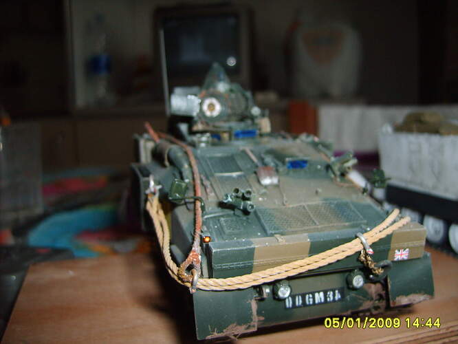

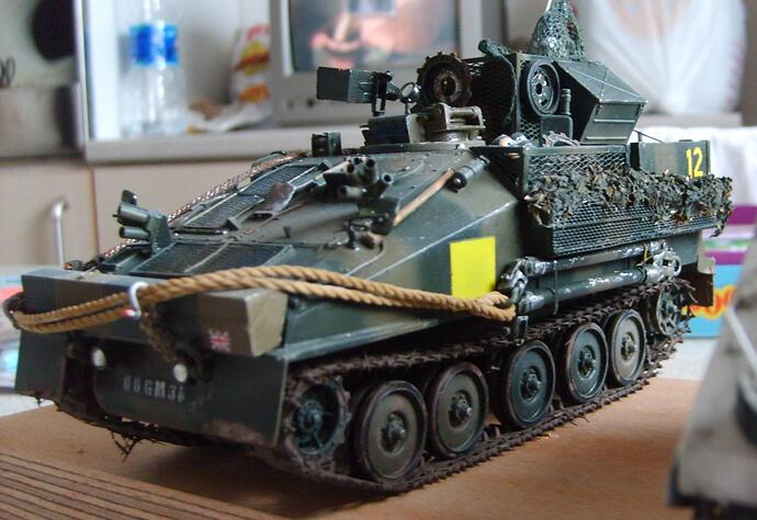

this model was built a few years ago using mostly photos from the book Scorpion and the CVR (T) Family by Concord and drawings on Tanks of the world.
I will send you the photos of the finished model soon
Looking forward to seeing it… :+1:
I didn’t realise it was an old build and it had been finished, so no probs… I only will ever offer creative criticism to try and help enhance a kit… that’s how I’ve learnt so much here in the forum’s.
