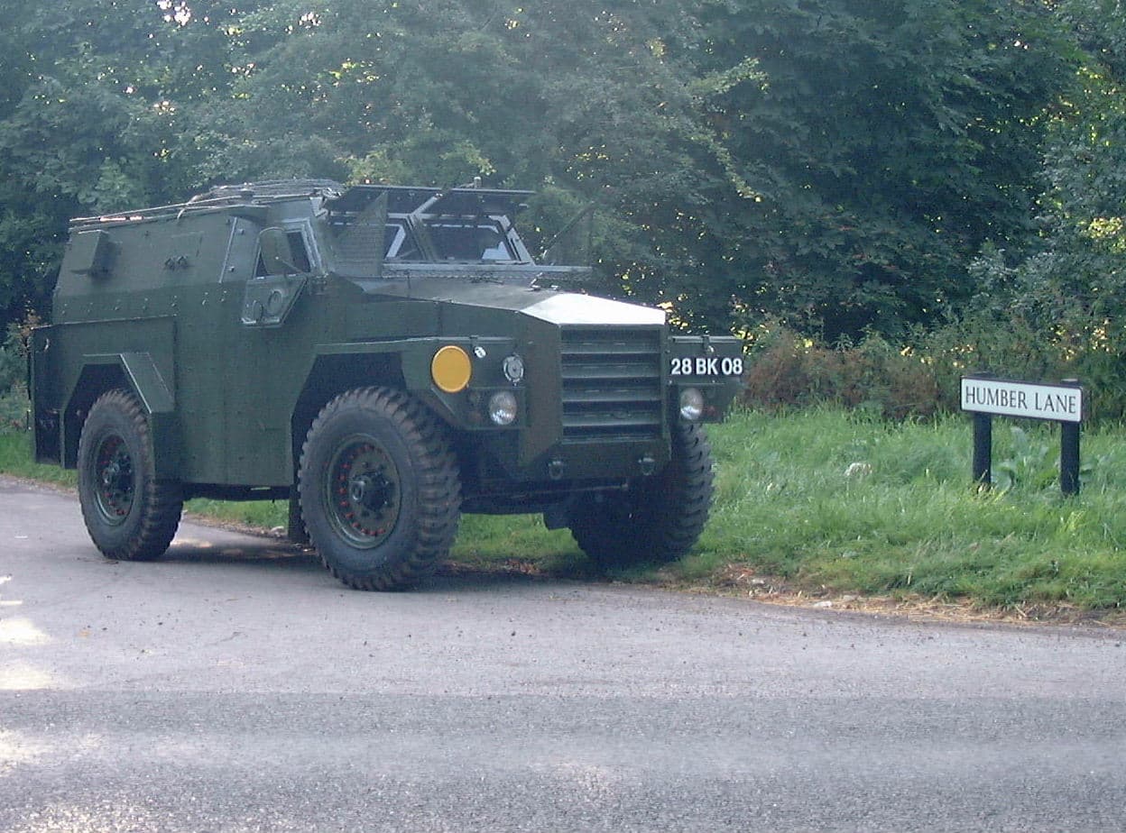

I am aware that on many post-war British vehicles the outer nuts on wheels are painted red. Evidently, this is a warning not to loosen until the tyre is deflated. I am currently building a Humber Pig (circa 1970),
and wonder whether this would have been standard practice at the time.

Photo evidence is always good.

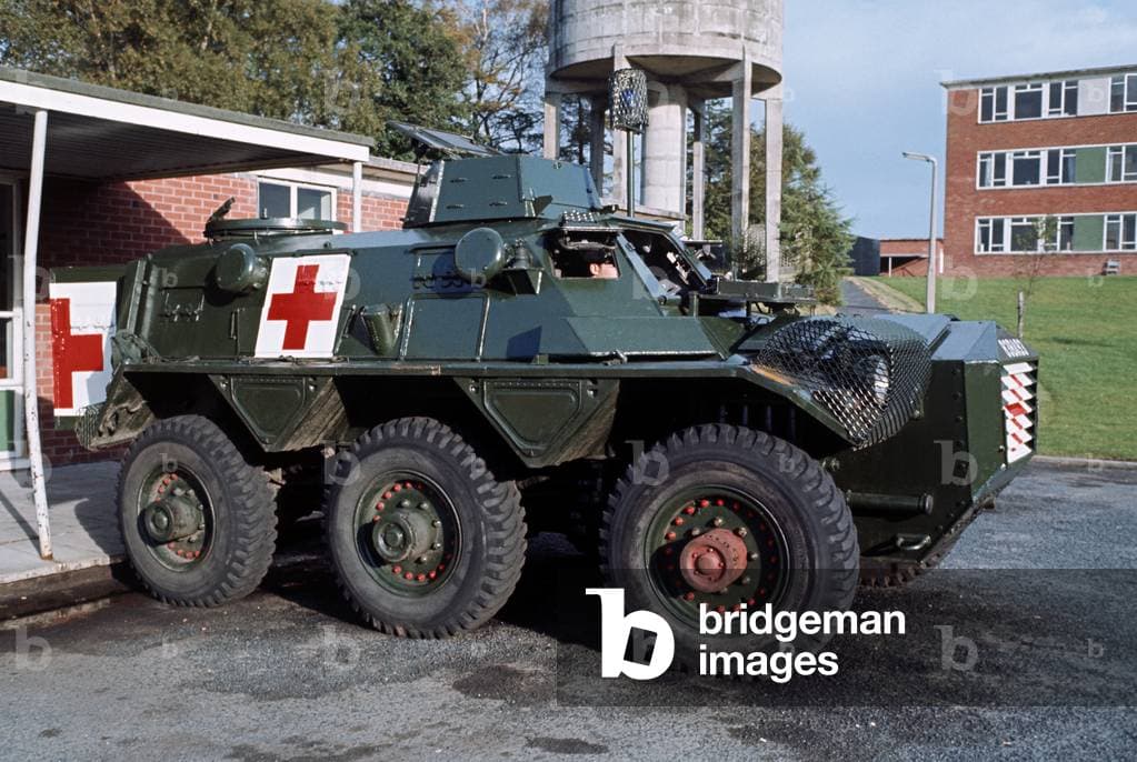

and a Saracen … For reference only
As Johnny noted the red painted nuts were the fasteners for the split rims - the lug nuts were wheel color . I would assume that this practice is still used today on any vehicle with split rims .
When I was in the tire business we called split or two piece rims “widow makers”. As noted this is a warning for those rims and pretty standard practice for a commercial use rim. If your kit has them present then proceed. Even deflated tires and rims still had tension and took care when swapping tires out.
